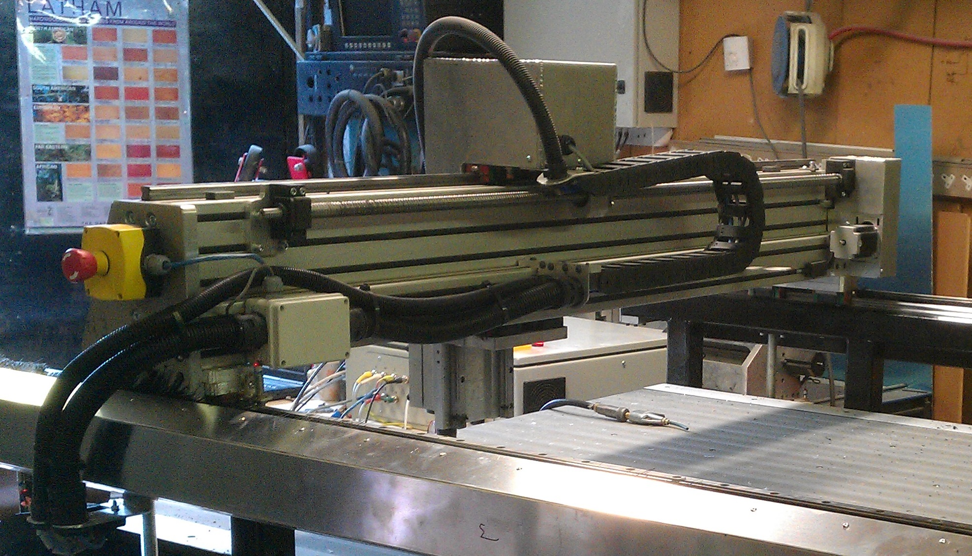

    Second, being a first timer, I was hoping to get slightly more parallel mounting tolerance with the round rails (bc self alignment), and they provide more room for mounting ball screws on the same face (although that could also be achieved by spacers on the profile carriages). I'm curious though, in what way do you find profile to be less of a hassle?
    Not quite sure what your meaning by Less hassle.? Less hassle than what.? Compared to using steel it's lot less hassle for obvious reason, try drilling and tapping 150 x M5 holes in steel and you'll understand this quickly.! . .Lol
    If you are referring to my comment about using 45x90 because of the slot spacing being less hassle. Then I mean it's less hassle than having to make plates which first bolt to the profile so you can then mount the BK/BF bearings onto. Or having to Drill and tap the profile directly, which don't advise doing because never works out good. Like on this gantry that uses 40mm spaced slots and BK15 bearings with larger hole spacing.
