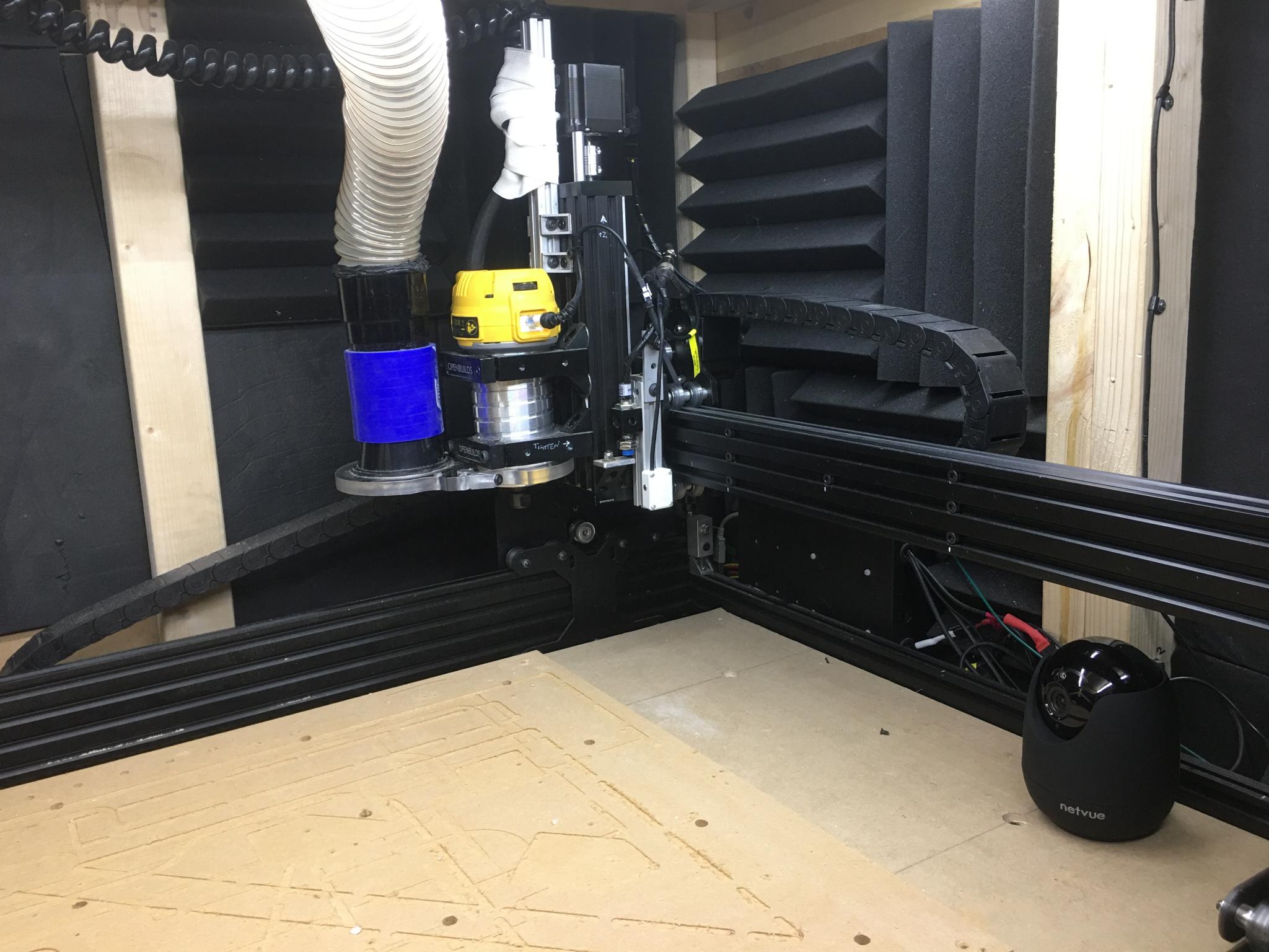

    Okay I have to say I’m intrigued now. I wonder how much it would cost to change a belt driven Ox to a machine that could run on linear rails.
    My gantry used to be 750mm of 2x 8020. I bolted them together to make it stiffer. The two frame rails that the gantry runs on is a single 1m 8020 each side with more 8020’s at either end. The two gantry plates are taller than normal Ox plates and are made of steel.
    What do you think it would take to switch to linear rails with ballscrews, including plates cut to mount the ballscrews and gantry carriage plates (I’m guessing those would need replacing).
    Add in digital drivers and replacement steppers and psu. My current steppers are Motech MT-2303hs280aw 175oz 2.8a ones. THEN add in the spindle and VFD. I looked up and found my CNC xPro controller can handle external controllers so I can get away with using that.

    This is my deformed Ox btw. Strange coincidence is that I only just found out that I was born in the year of the Ox in the Chinese calendar... and I ended up buying an Ox CNC machine. Go figure.
