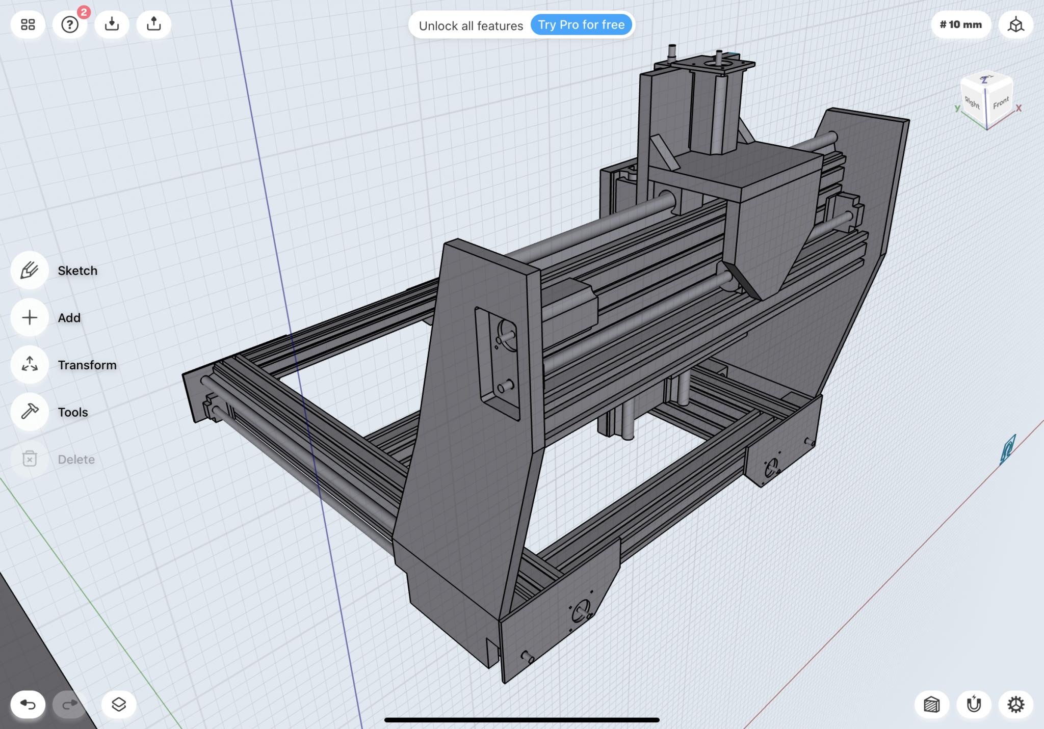

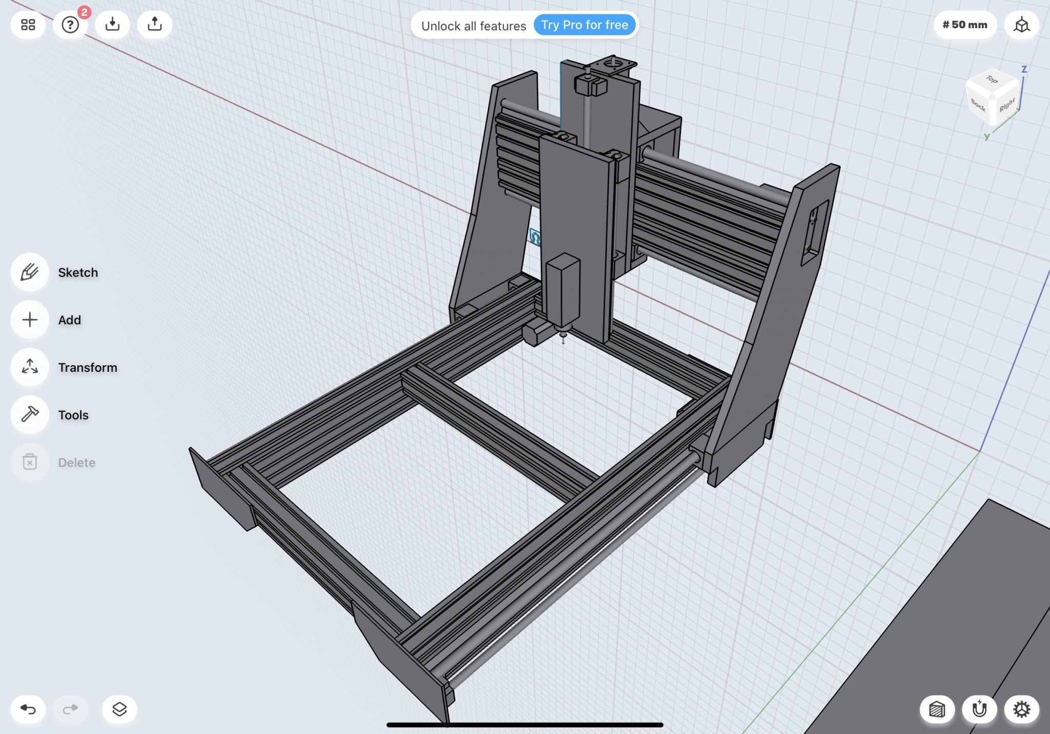

    Moving on to great news (for me at least) I’m finally able to post pictures of my design which is heavily based on ideas stolen from this forum! I planned on doing it in the build log section, but seeing the attention this thread has got I figure I might just keep it here (please correct me if I’m doing this wrong!).
    So the basics:
    - Total dimensions of the frame is 1000x800mm and gantry height 650mm as measured from the bottom of the frame to the top of gantry beam.
    - The Z carriage is roughly 450mm high (extending some 150mm above the top of the gantry beam) and 200mm wide with 150mm travel (bearing blocks 300mm apart in the Z and 200mm in the X direction)
    - frame consists of 60x120 alu extrusions on the sides and 3pcs 60x60 extrusions across (easy mounting of 20mm round linear rails ;) )
    - gantry beam also 60x120 extrusions in L shape
    - gantry plates and Z axis made out of 20mm alu, the thinner end plates/stepper mounts are 5mm alu
    - the bearing blocks on the gantry plates are 250mm apart
    - as discussed above 1610 or 1616 ballscrews drive X and Y, while 1605 will suffice on Z
    - NEMA 23 (perhaps 4nm) on all axis as well as 20mm round linear rails
    - Haven't decided on the spindle just yet, but should be able to carry something like a 2.2kW spindle (i.e. 5kg or so)
    NB! All mentioned dimensions are not precise to the mm, but gives a good indication of the general size. Neither is everything perfectly aligned. I’ll anyway sort out the details as I make the final drawings in fusion. Also- I’ll model the final (balanced) version of the gantry plates as the gantry beam/Z axis design is finalised. Also2- stepper mounting plates will require adjustable fastening slots.

    So to the specific questions I have in mind, I'll leave out the ones already previously discussed:
    - Frame; I quite like the 60x60 extrusions across the frame as they give me clearance below the table (eg for X axis steppers), but would it be too flimsy? Looking at it now, I have quite some weight on the gantry vs the frame. Maybe worth beefing up the frame with 60x120 instead, or at least the two furthest to the front, leaving clearance at the back for steppers...?
    - Gantry/end plates; online consensus seems to dictate 20mm gantry plates, but what about Z mount? Is 20mm overkill and would 15mm do in a machine this size? The end plates/stepper mounts are 5mm (as commercial stepper mounts seem to be in that range). As they're not subject to any excessive forces in my design I suppose 5mm is enough. Essentially they're only carrying steppers and the odd limit switch as well as providing additional stability in the corner joints of the frame.
    - Other comments/critique?

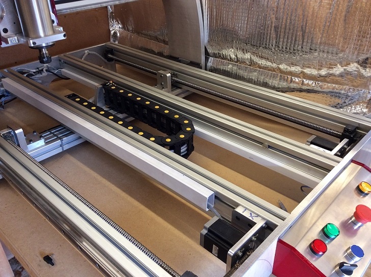

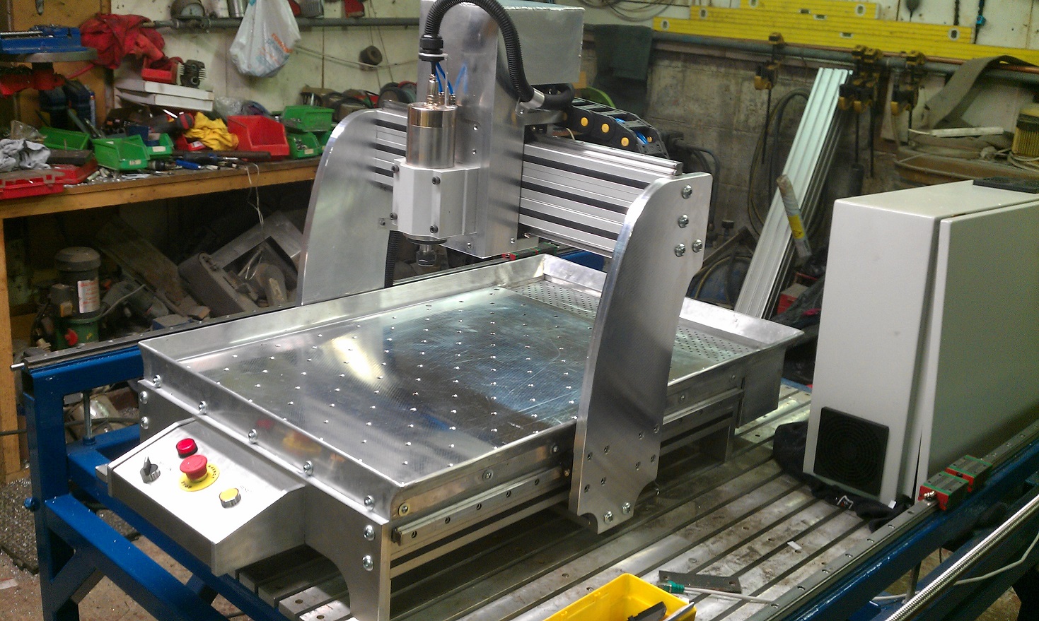

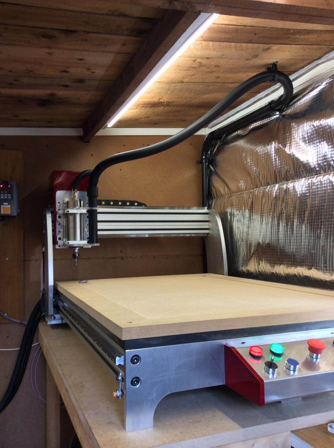

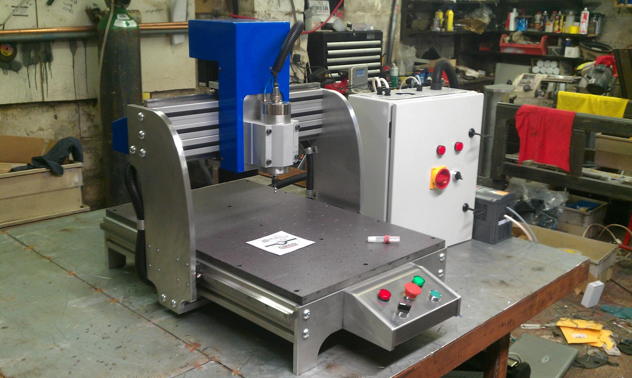

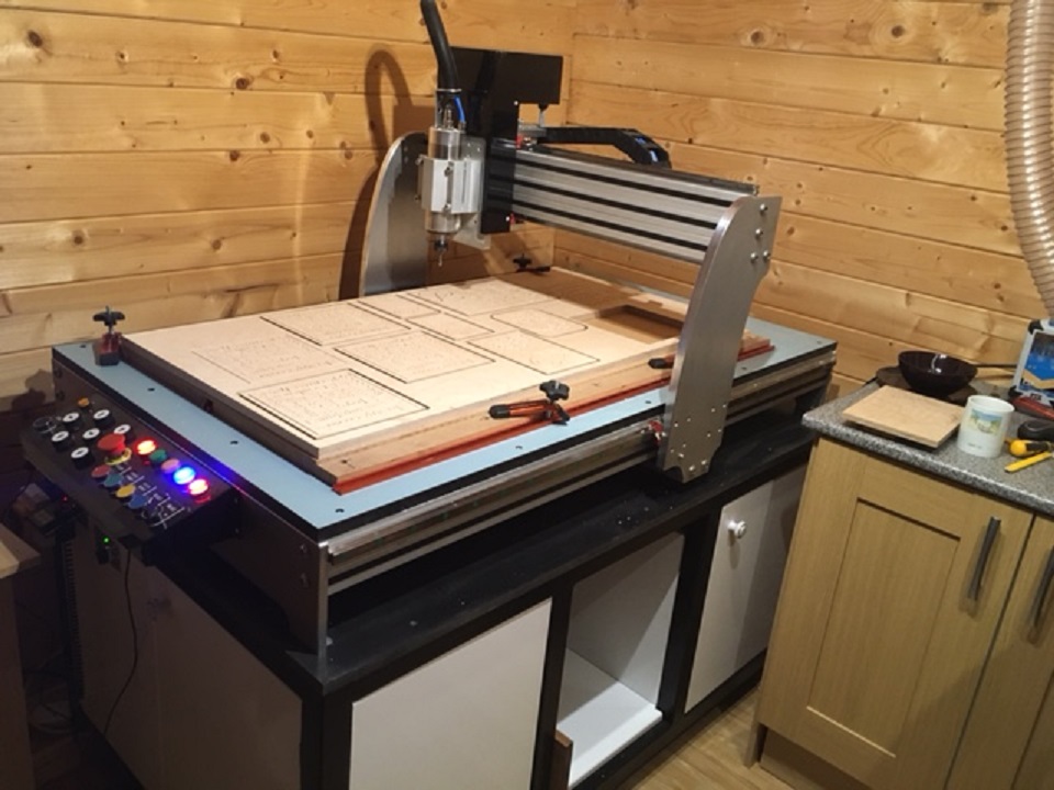

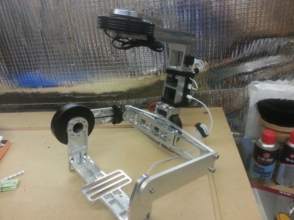

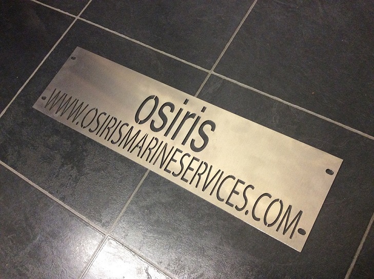

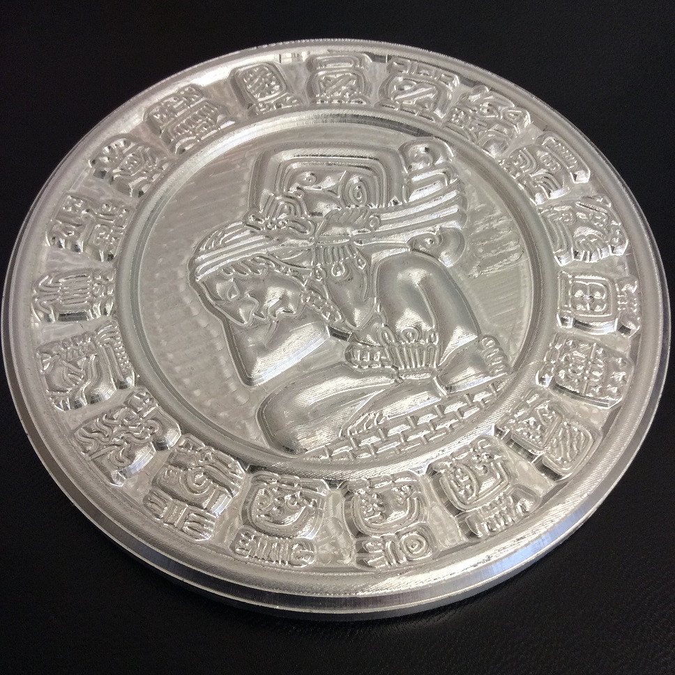

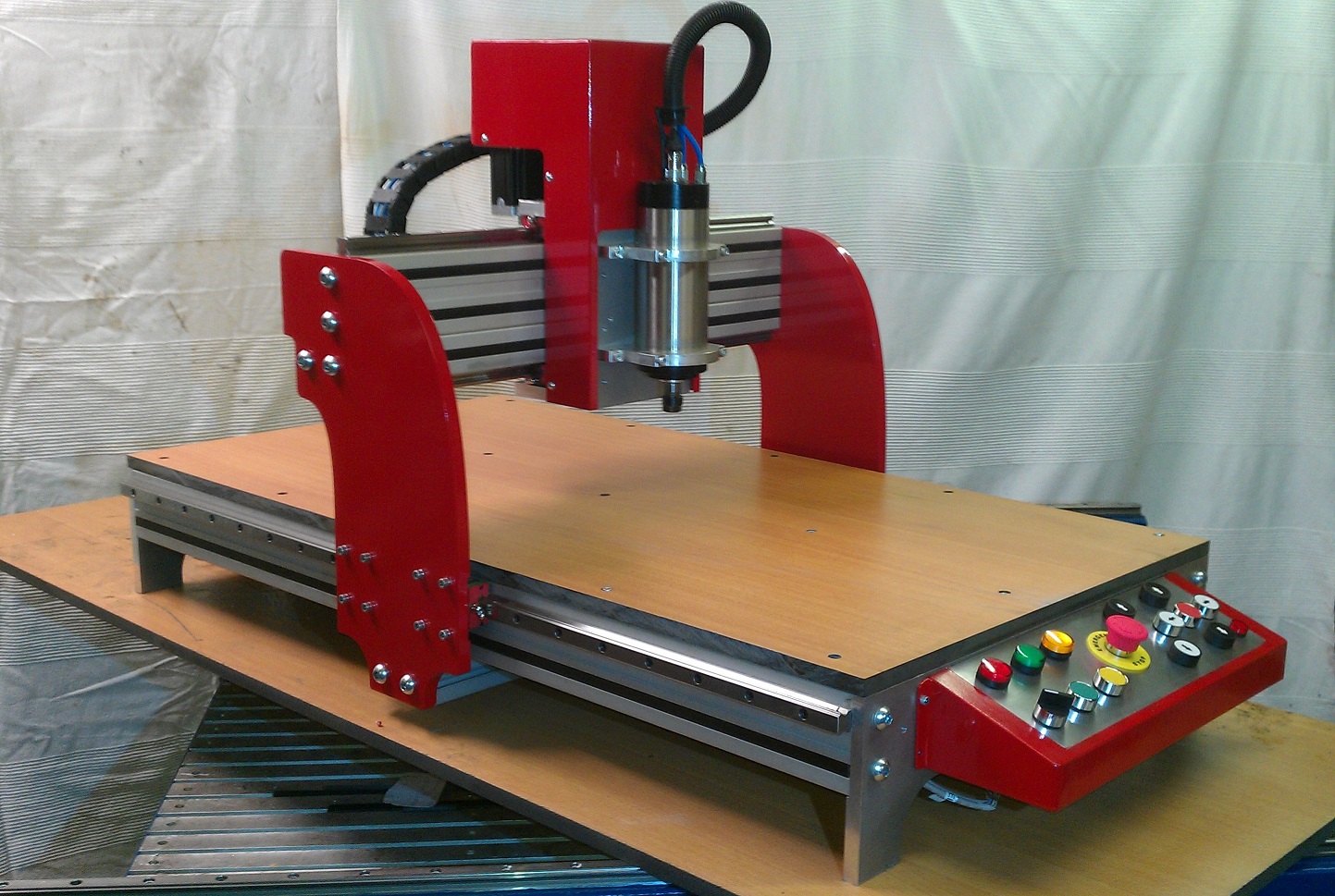

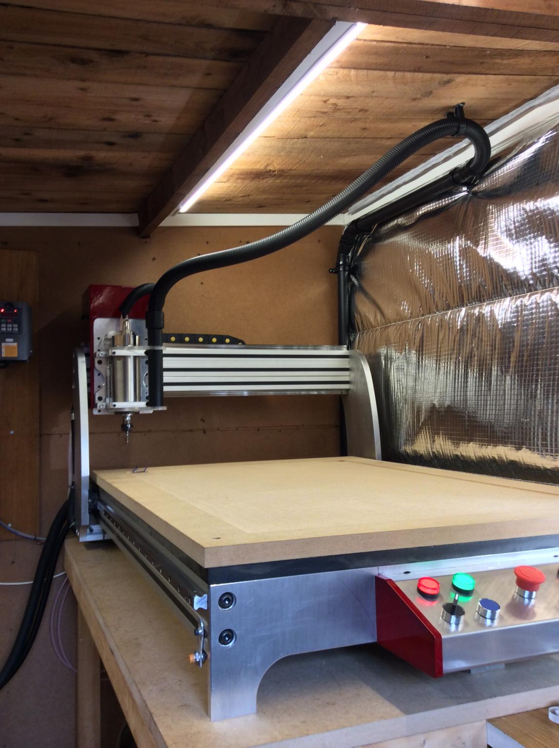

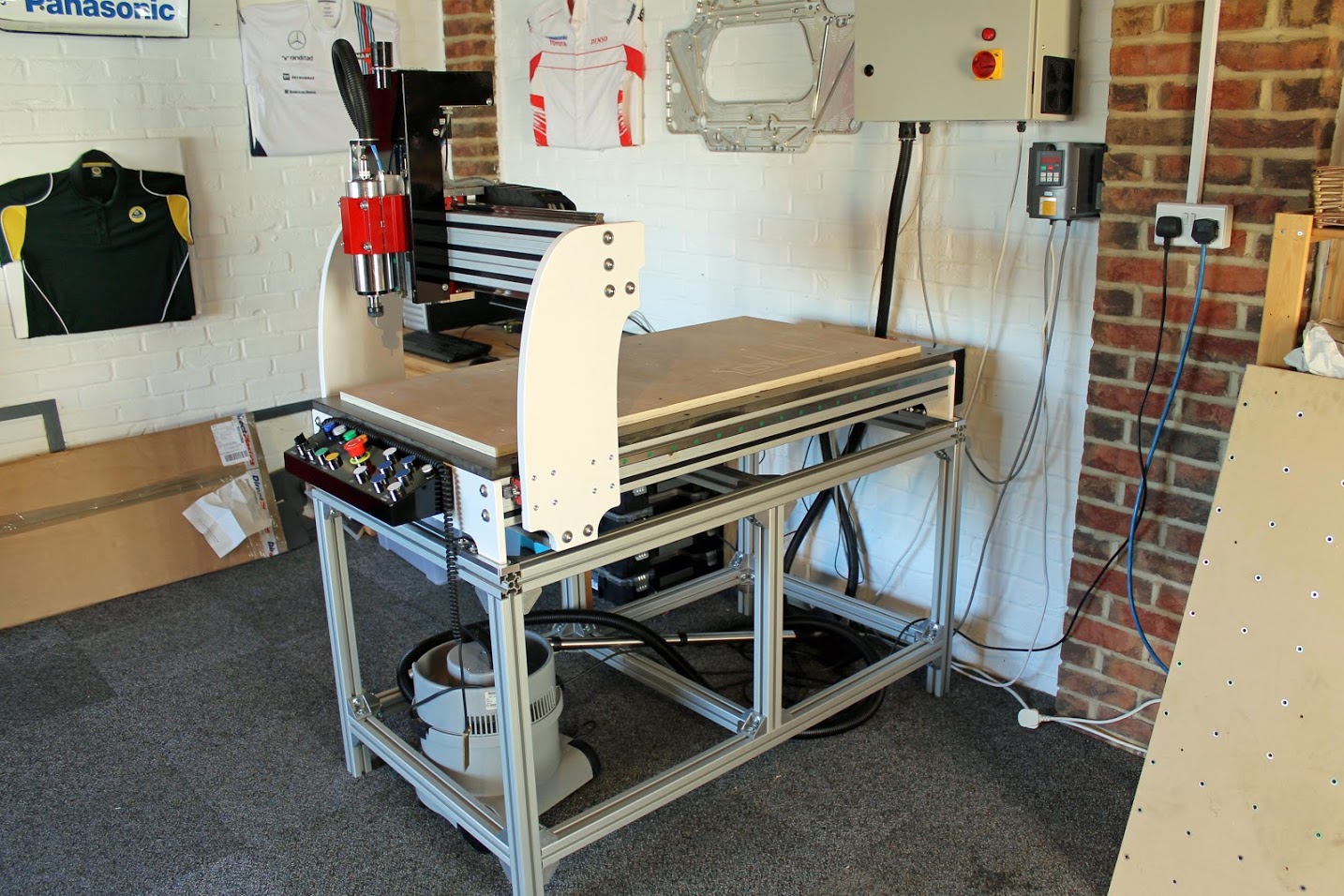

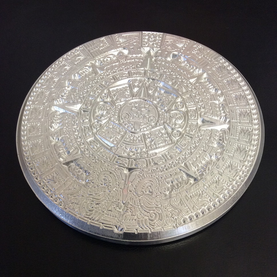

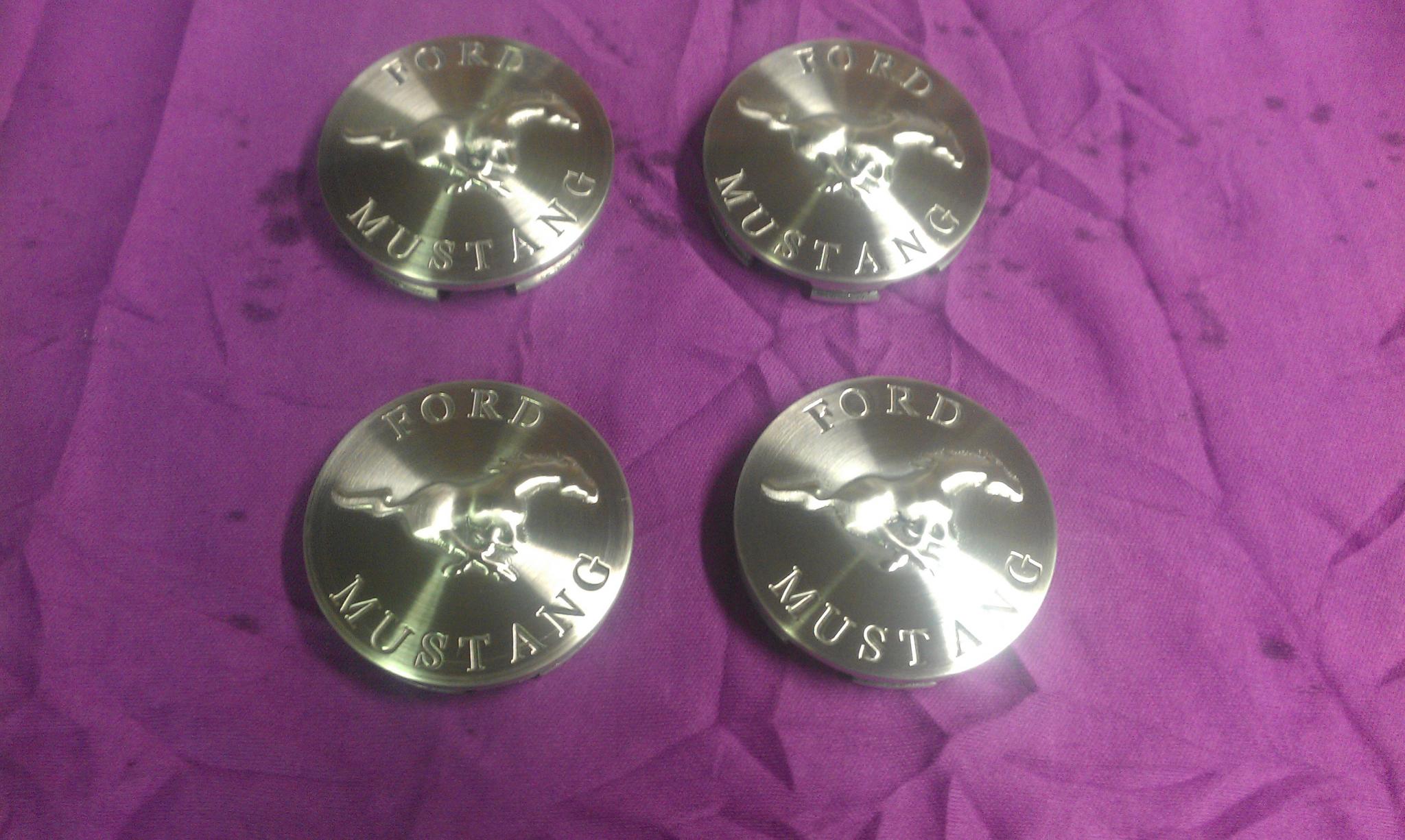

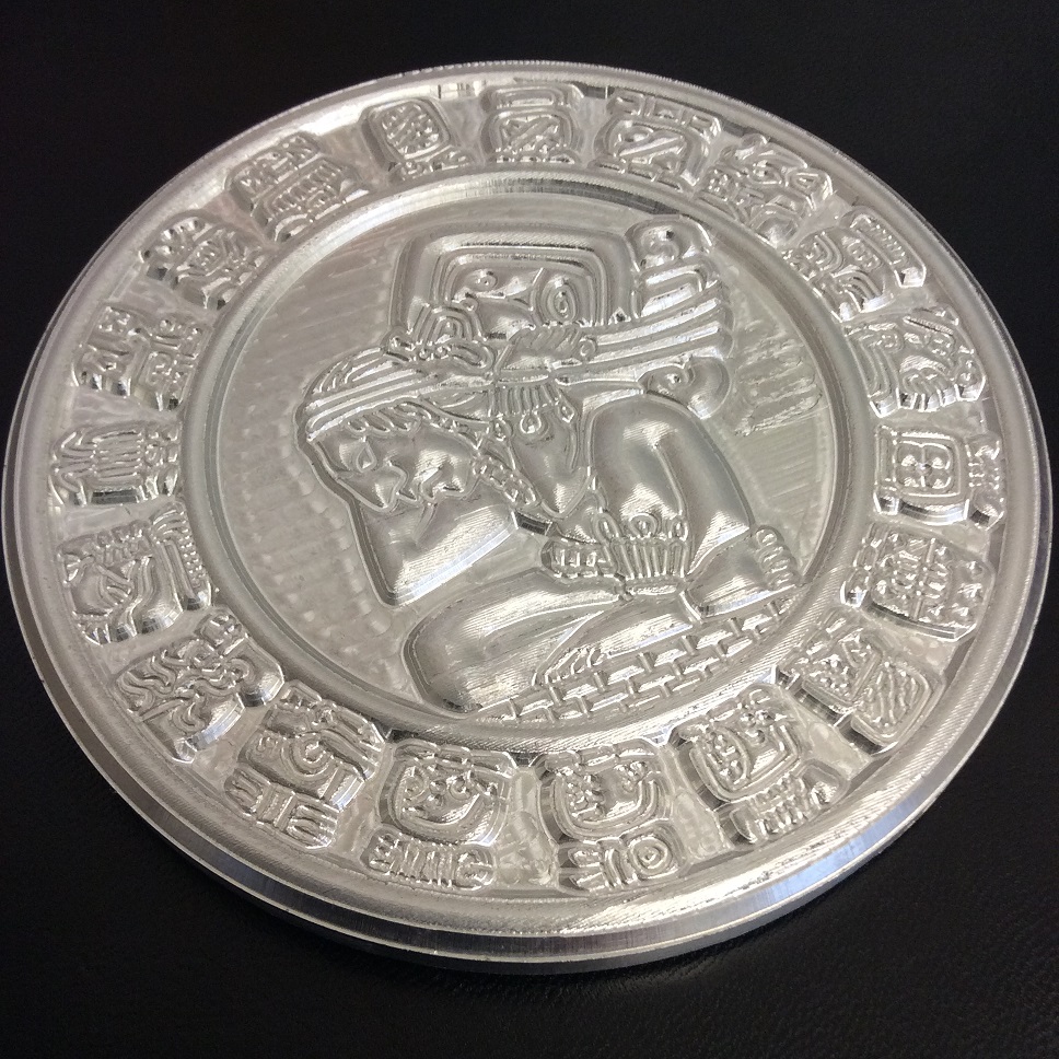

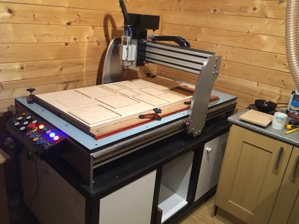

    Going to show you some machines I've built that are all the same design but slightly different in size or Z-axis type/length etc dependant on usage but all share the same profile size. 45 x 90.
    These machines were designed solely for woodworking and range in cutting area size from 600x400 to 1300 x 700 with a mixture of single or twin screws. However, all of them will happily cut aluminum as you'll see from a couple of pictures sent to me by customers.
    Now I'm not showing you these and saying this is how you should build your machine but what I am showing is that this kind of profile size will easily do what you need so don't go stressing about if your 120 x 60 is strong enough or not. What's more important is how it's used ie: L shape gantry bolted together etc.
    Some of these machines are used for business and running 12hr days 6 day weeks and have been doing so with minimal maintenance for several years.
    Can I also strongly advise you to drop the round rail and go with profiled Linear rail. It's much much better and far less hassle. Don't spoil a potentially great machine for a few Euro more. You'll also get the extra back when you come to sell it as you'll be able to ask more for the machine and it will appeal more to those who know what to look for.
    Also, move the ball-screw on the gantry to the top and motor below to keep the length of the drop plate to the shortest possible. Another thing you need to be aware of and one of the reasons why I use the Bosch Rexroth style profile with slot spacing at 45mm is that it suits BK/BF12 bearing bolt spacing. This means you won't have to make mounting plates or mess around drilling the profile.
    It's these little details that can easily screw your ideas up or make things much harder than they need to be.!!

  11. #40
    First off- those are some slick looking machines! Also, I never considered using a cross beam under the frame for dual stepper set-ups.
    The round vs profile rail debate is one that has had me torn the most. Undoubtedly profile are superior in theory, in practice, however, I've been somewhat put off by the many worst case scenarios people have posted about when ordering the Chinese kind (which I strongly suspect is the only kind my budget allows). Second, being a first timer, I was hoping to get slightly more parallel mounting tolerance with the round rails (bc self alignment), and they provide more room for mounting ball screws on the same face (although that could also be achieved by spacers on the profile carriages). I'm curious though, in what way do you find profile to be less of a hassle?
    Considering cost, downsizing to 45x45/90 extrusions might free up some funds that could be used on profiles... I might just have to bring out the famous abacus!
    With regards the bk/bf12, I thought bolt spacing was something like 46mm in which case standard t-slot nuts wouldn't work? Or is it merely a case of using good ol' force?
    I long favoured flipping the ball screw and stepper positions, but figured ball screw placement as centrally as possible relative to the gantry rails took precedence over drop plate length.
