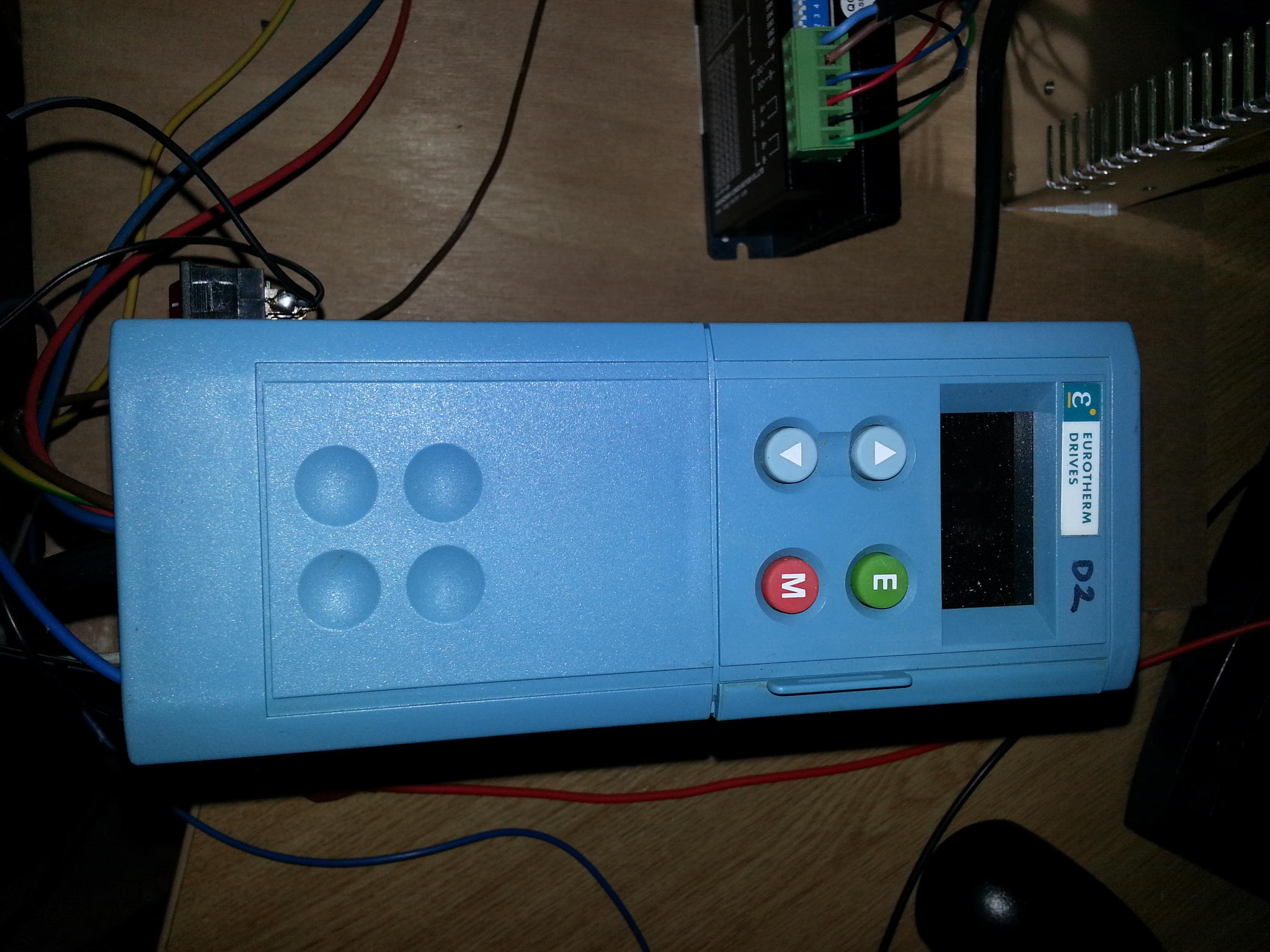

    I'm converting an ORAC lathes electronics and have had the slides under CNC control and the spindle operating at variable speed through a VFD. It's not all integrated and under CNC control but when it is i intend to use Linux CNC but also have Mach3.
    The VFD is a Eurotherm 601 and the BOB is one advertised as a Mach3 board with a 0-10V 0utput and a relay. On the non-working end of the spindle is an encoder disc with, i think, 100 slots with one extending to the outside of the disc.
    The three images below show the VFD, the BOB and the encoder disc.
    I need the lathe for thread cutting and obviously need to sync the z slide and the spindle.
    My understanding is that the Encoder sends a feedback signal to Linux CNC which then controls the slide traverse rate to the spindle speed.
    I don't know whether the BOB I have can fulfill this task and even if it can i don't know how to do it.
    So the questions are:-
    1 Is the BOB adequate and if not can someone recommend a more suitable one.
    2 How do i build the kit that picks the signal up from the encoding disc and
    3 How do i integrate the bits and control it through Linux CNC.

    Bob I have done this on a ML S7 with a 100 slot encoder. Do you intend to put homing switches on the lathe. As that bob will only have 5 inputs. you can get away with A and Index pulse (2 inputs) better with A + B and index 3 inputs. personally I would go with a mesa card something like 7i76 or 7i76e for ethernet. if using Lcnc.

    If I input M3 S876 then the output from Pin 1 is 4.9V and the spindle runs at approx 876rpm.
    If i input S438 the output drops to a steady 2.45v but the spindle rpm oscillates between 0 and 876rpm. The closer i set the S speed the more the spindle is at max speed.
    If I use a power supply to feed into the VFD at say 2.45V then the spindle runs at the correct speed.
    I deduced there must be some other input that's causing this oscillation and measured the AC voltage on pin1 at 2.7V. I can't determine it's frequency but if this is very low then it might explain the issue?
    Is there a way of filtering out the AC component if in fact it is this that is causing the problem?

    Bob I think that this would be better put on the Linuxcnc forum Having said that Have you had a look at this
    http://linuxcnc.org/docs/2.4/html/ex...ndle.html#r1_3 this is for version 2.4 I think.
    Where did you get the scale from in setp pwmgen.0.scale 876.0 I think this should be set to the max speed of the spindle

    I know this is an old thread but I have just finish a retro fit of an ORAC with LinuxCNC and have all working including threading using the original orac encode wheel 48 slot and three optical readers so operating in quadrature
    Let me know if you need any help
    Paul
    Paul, When I'm back in the country I'll be wiring up an encoder for my lathe - I might well be in touch!
    OK understood
    I bought a encoder just in case the home made encoder was not up to the job but it meant making up a lay shaft to run the encoder and a set of timing pulleys to run the lay shaft at spindle speed. All very doable but the original ORAC encoder disc was looking me in the face so a bracket was designed in CAD to mount the 3 optical seasons with each sensor adjustable in radial position. The bracket was in two halves as it was to be 3D printed effectively a plate to hold the three sensors and adjusters and a separate stem that mounts to the lathe headstock
    The two pieces are checked for position and then glued in place using cyno
    Wire up the three sensors to the bob and and give it a try
    The sensors have an led that flashes when the signal to the bob is triggered so rough adjustment of the sensor alignment was done using the LED on each sensor
    One sensor reads the long slot to single pulse per rev
    The other two read each slot and the alignment of these is rather more critical which I did with the spindle running and monitored the spindle speed in linuxcnc
    It was showing on the display as varying by a few hundred rpm which it clearly was not but after redial adjustment of the two inner sensors the speed stabilised to a steady reading. The sensor mount screws were nipped up and threading on a test bar M10x1.5 attempted
    To my amazement it waited the G04 P10 that I programmed in G76 then performed 15 cuts and 2 flex passes with no cut
    The thread was nut deep enough so x touch off adjustment made and run again. To my amazement it picked up the thread perfectly and only made a cut after 13 passes of cutting air
    Retired and nut still not quite going on
    Further adjustment made and run again this time nut ran down the thread perfectly with just a slight amount of slop same feel as the nut on a commercial set screw
    I cut the first thread 30mm long
    Once depth was correct I cut another thread 9 mm long and the nut ran alway down the thread first time the feel of the nut is the same from first turn through the middle to the very end
    Well please with the little ORAC my home brew encoder and linuxcnc
