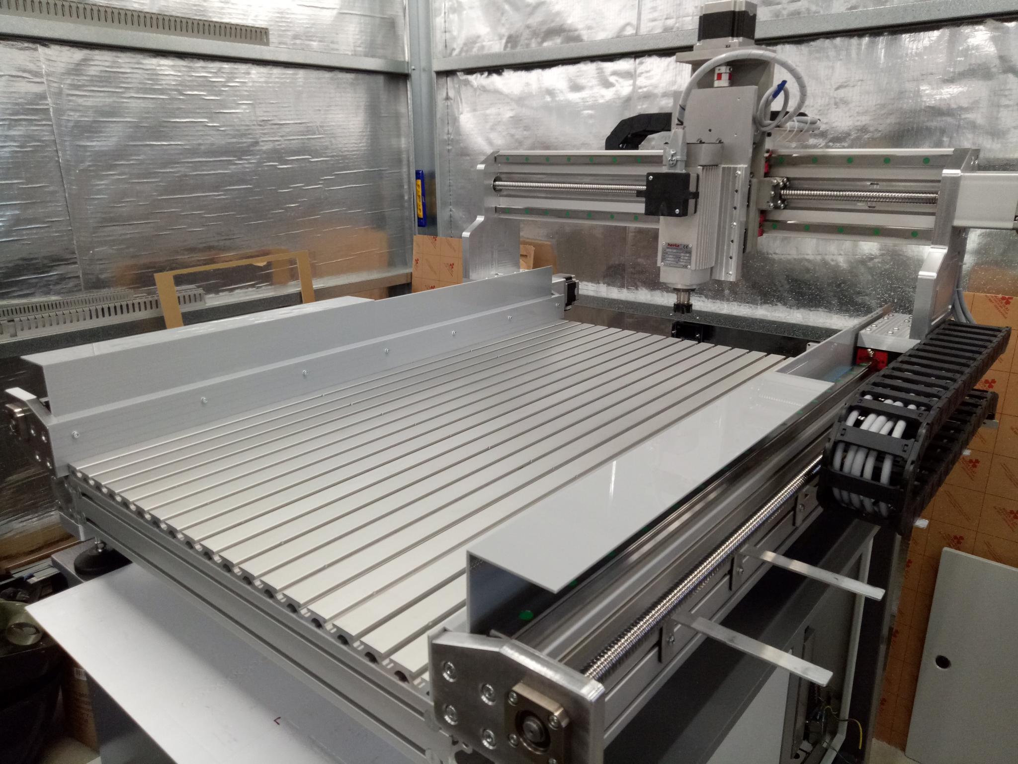

    When i built my latest machine i used aluminium extrusion. However i had a reasonable budget so i used heavy duty extrusion. It's a moving gantry design but i have no problem with a fixed gantry type. Although my machine is made from extrusion it is very rigid, i machine aluminium very easily and also do steel plate on it. Although i prefer not machining steel cause of the mess it makes.

    Thanks ericks, do you have photos of the machine or a build diary?
  5. #15

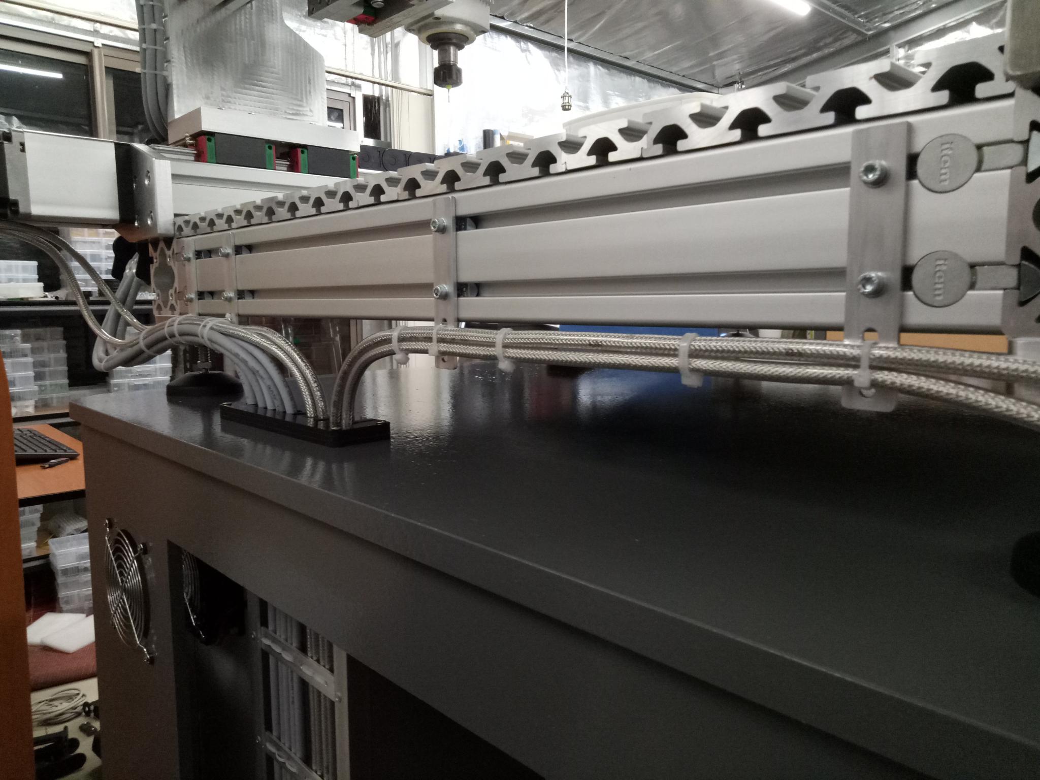

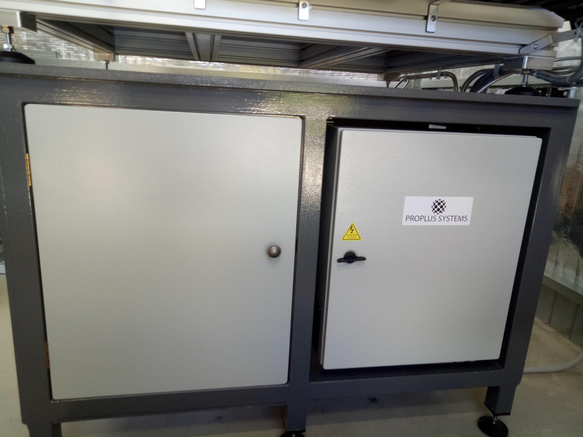

    Not latest cause i am constantly adding stuff, but this was taken a while back when i was busy adding a bit of guarding over the ball screws...I did do a few things on this build that i would change on the next one. My experience is more on panel building rather than machine building :)
    I started by first building a steel stand.

    Thanks, that does look like a very nice, solid machine.
  7. #17
    Thanks, yes it's heavy and rigid. There was opportunity to make it even more rigid but i found it is good for what i need atm. There are so many options re machine designs. My next one will look much different to this one. All the best with your journey :)

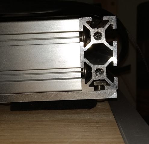

    Thanks, I am curious how you joined the extrusions. For my 3d printer I tapped the ends of of the exrusion and used bolts to clamp them together. I then braced the corners with plates underneath. Like this....

    but I was never very happy with this. Ok for a 3d printer but pretty easy to pull the joint apart as it clamps only to the thin wall of the extrusion.

    This is the best pic i have atm showing the connectors
