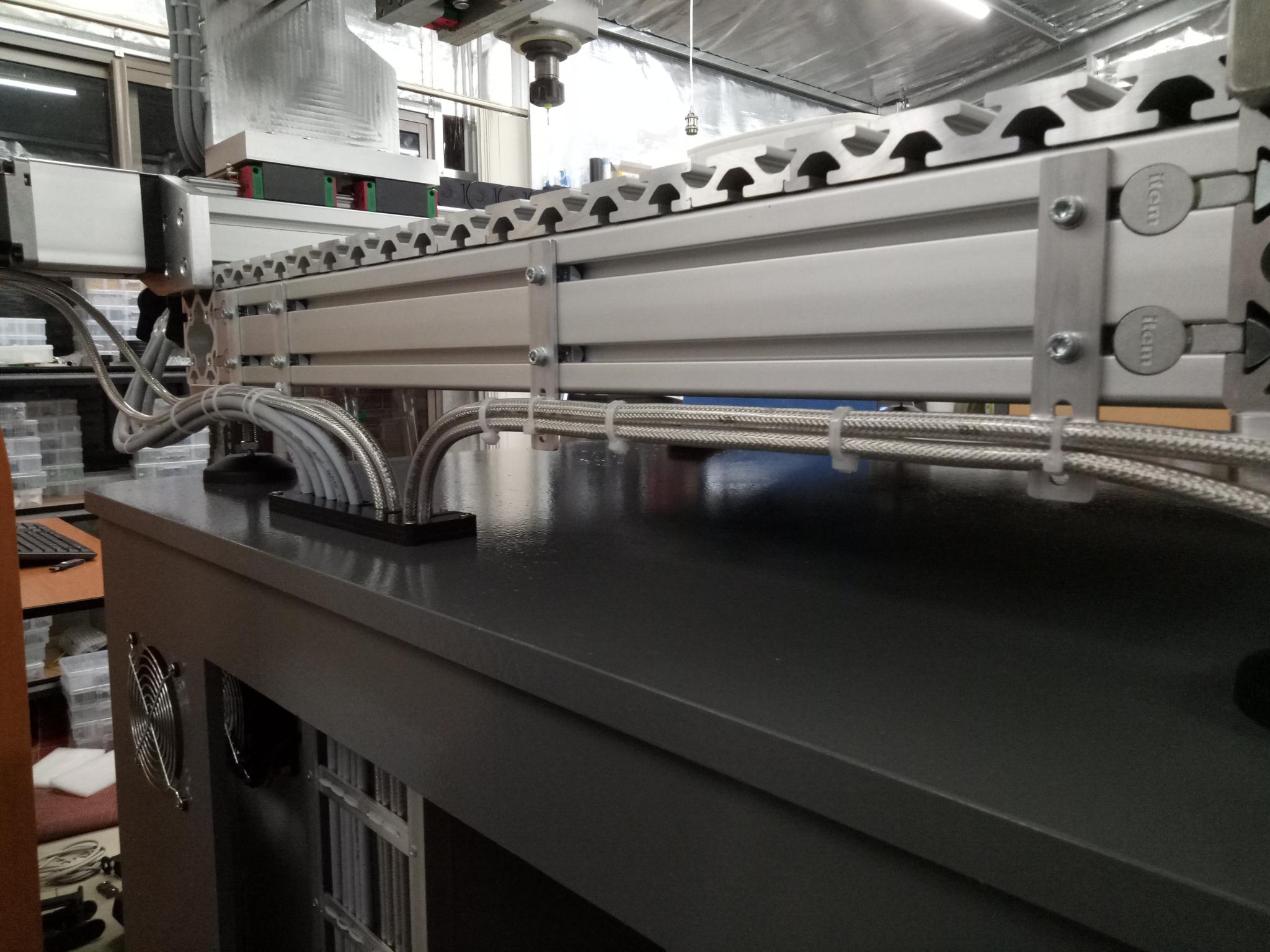

    Quote Originally Posted by ericks View Post
    This is the best pic i have atm showing the connectors
    Attachment 27078
    Thanks, I think I have come across that sort before but will have another look.
