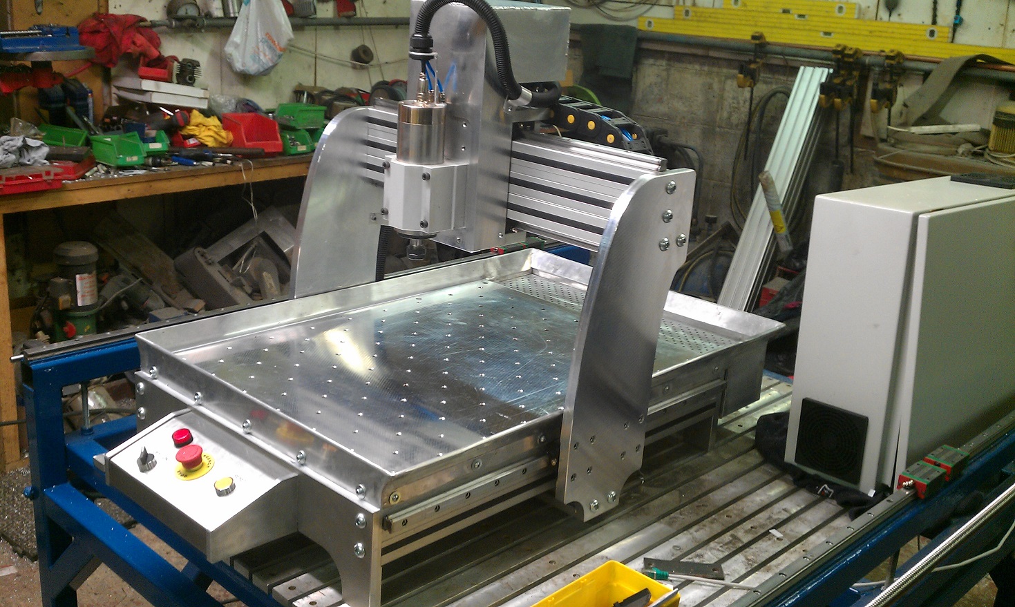

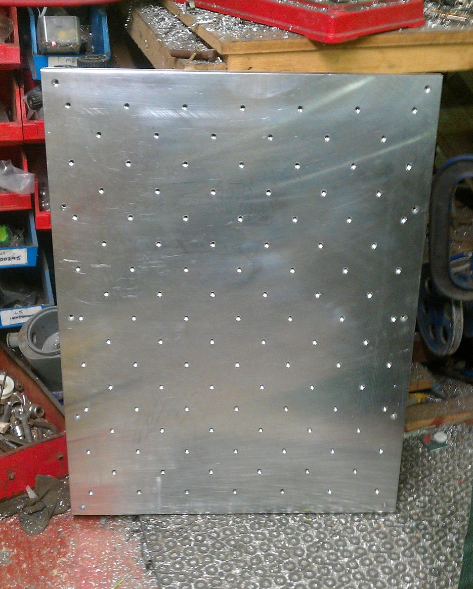

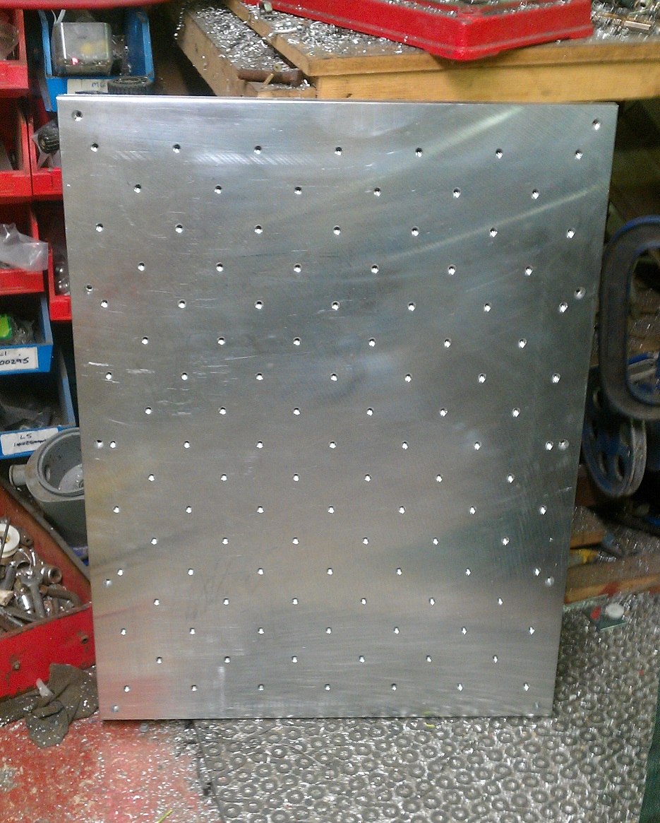

    To be honest 20mm will be strong enough here's a little machine I built few years ago that uses a 20mm tooling plate and it's plenty strong enough.
ID:	27082Click image for larger version.
    You could even thread mill the holes using the machine!
