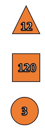

    For my first project I've been asked to cut some gaming pieces for an obscure game from the middle ages "rithmomachia" the pieces are triangles, squares and circles with a range of number engraved on them (see pic)
