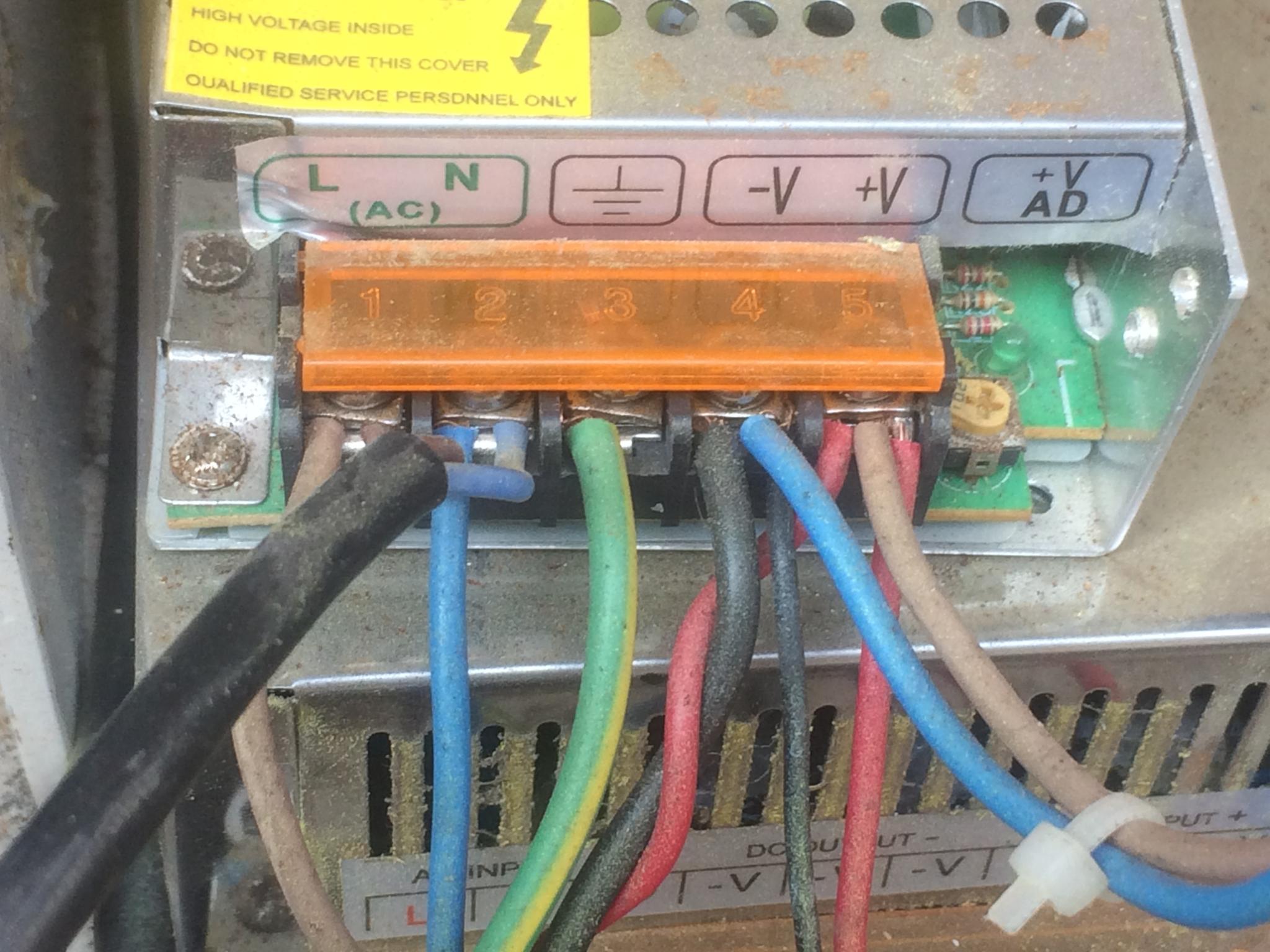

  1. #21
    Quote Originally Posted by Geoff57 View Post
    hi Clive
    yes i have dvm i assume L N are 240 volt but how do i check the v- v+ do i put the black probe on v- and red on v+ sorry im not up on electronics
    thanks Geoff
    Yes Geoff black on V- Red on V+ but you'll need to change the meter from reading AC to DC.

    ok i have 240v going in but nothing on the output so it looks like the unit is dead goes with the led not lighting up out of interest what normal goes on these psu
    once again many thanks for your help Geoff

    Yes. If you get them the wrong way round it will just measure -ve. make sure the meter is set to DC and AC for the mains side. Be careful .
    Edit: I had not refreshed by browser so didn't see Jazz post.. Just to make sure that there is not a short on the output make a good pic. and remove all the wires on the DC side and check again.

    I'm not that deep into the electronics of how PSU works but it's worth taking out to see if it's got a fuse built into it. After that, I'd just buy another for sake of £10-15 quid.

    i will check to see if there is a fuse but something must have blown as you say might just as well get a new one at that price will let you know how i get on

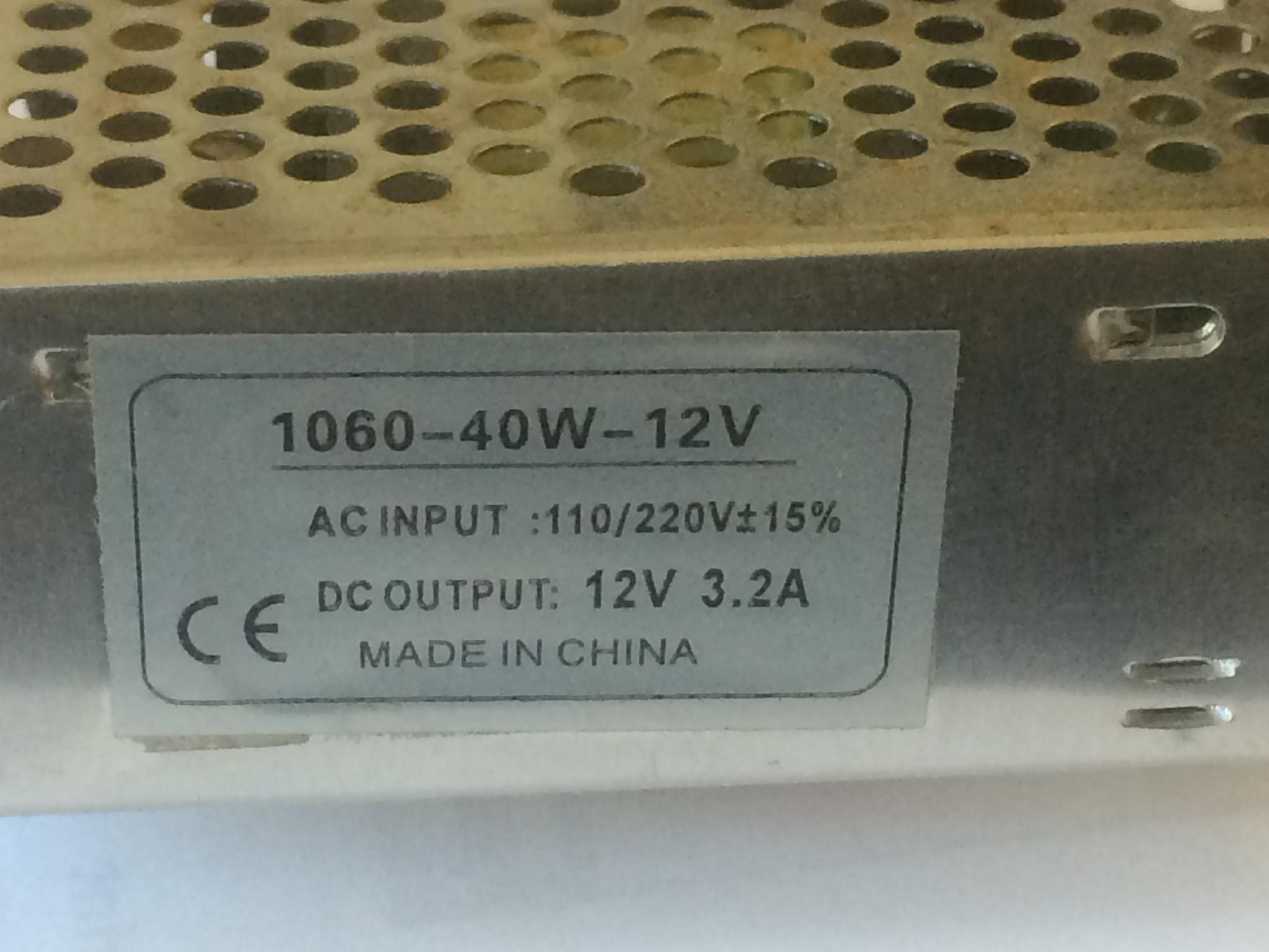

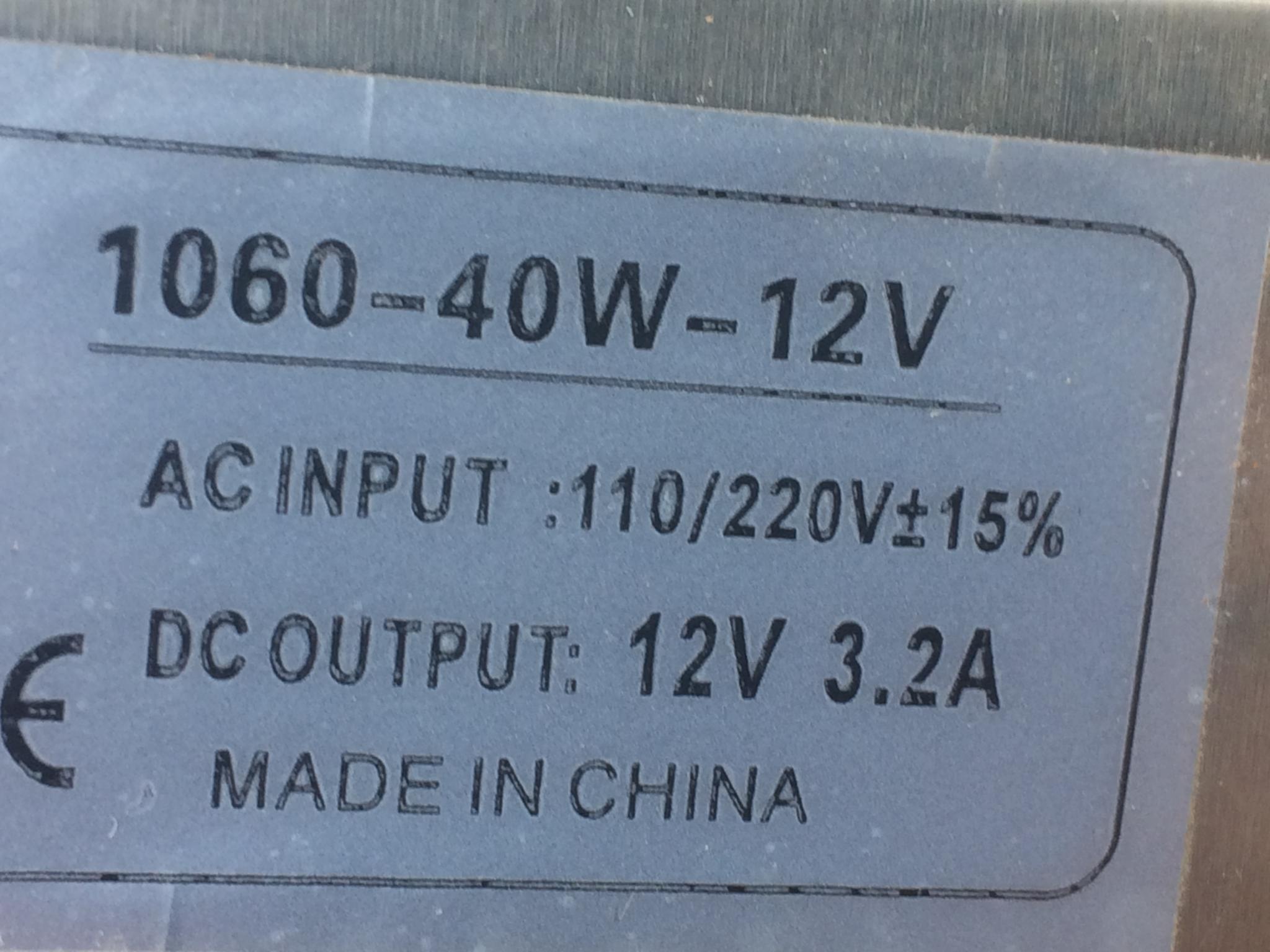

    no fuse inside going to buy a new one looking on ebay there a loads of then could one of you good gentlemen point me in the right replacement see pics
    Geoff

    Here you go:- https://www.ebay.co.uk/itm/Regulated...Nrg9qr7WY2EZng
  10. #30
    Geoff
    May be worth going for a bigger wattage. These don't fail very often imo. See how much is connected to it.
    Mine only powers the 12v-24v part of my BOB and that's it, but I still stuck a 24v-60w on there. I can always get a step down unit if I ever need to add a 12v line.
    So with yours being a 12v as long as you get the same voltage unit a bigger current and wattage rating won't matter.
