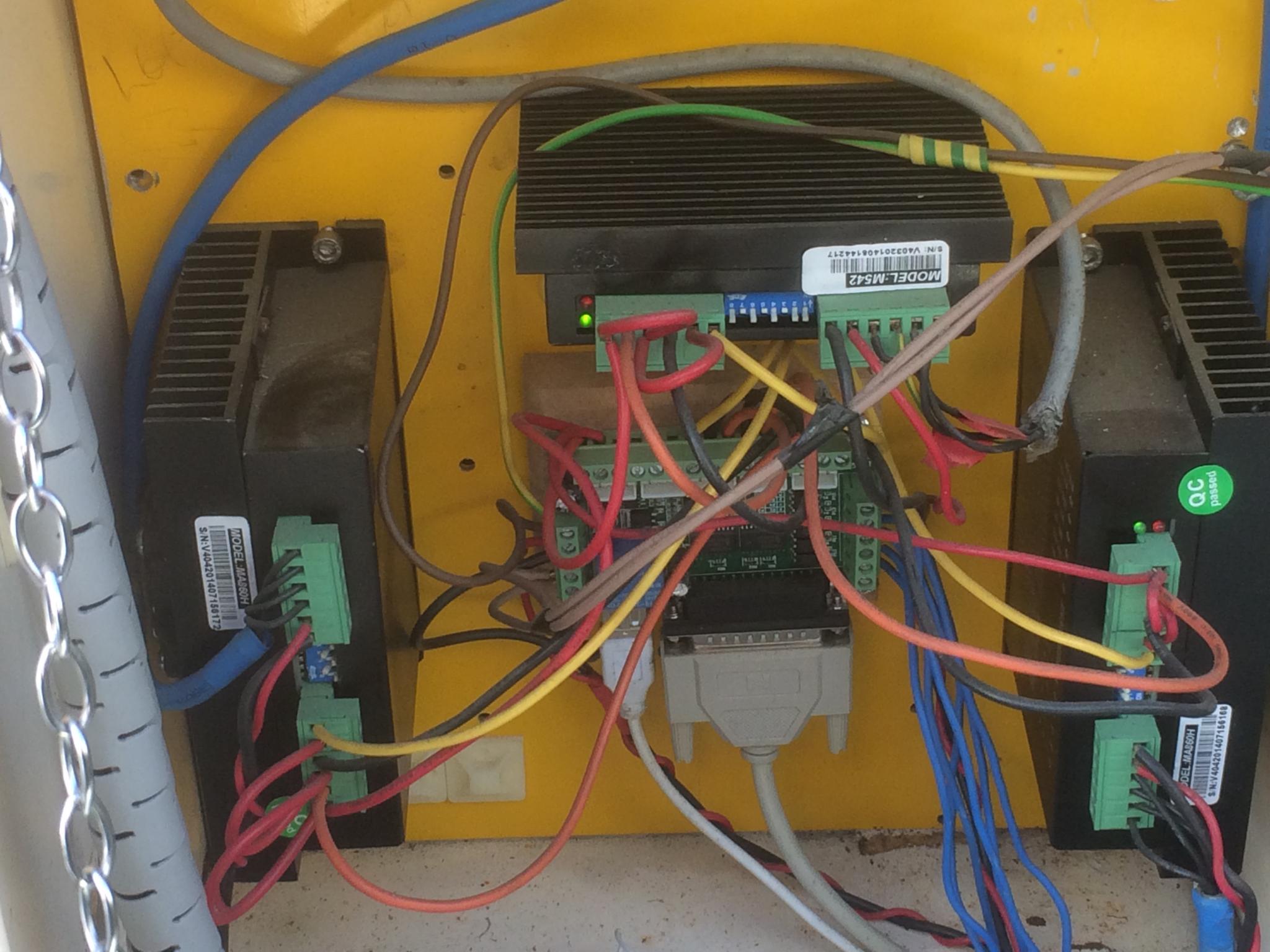

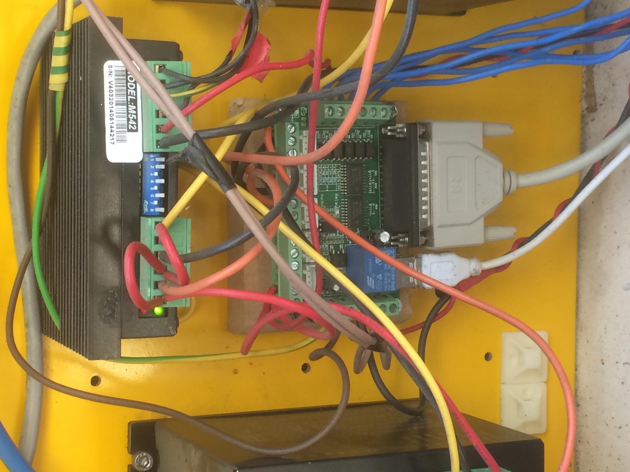

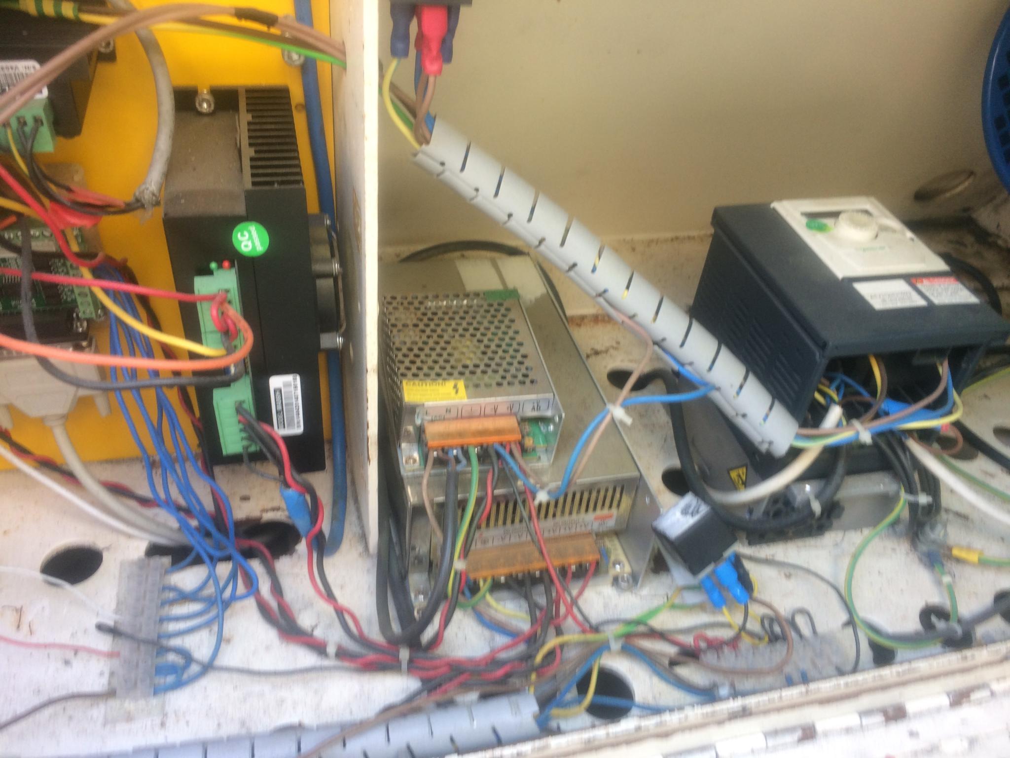

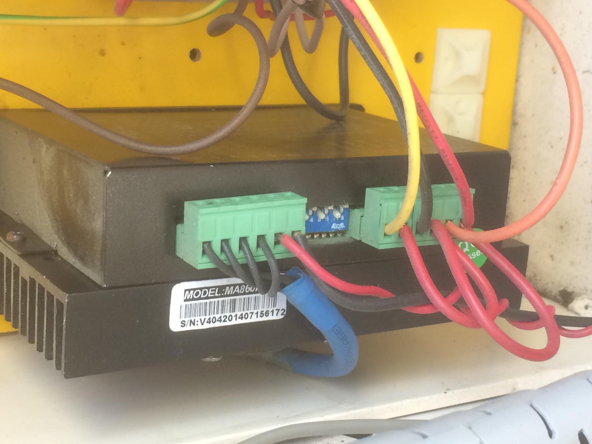

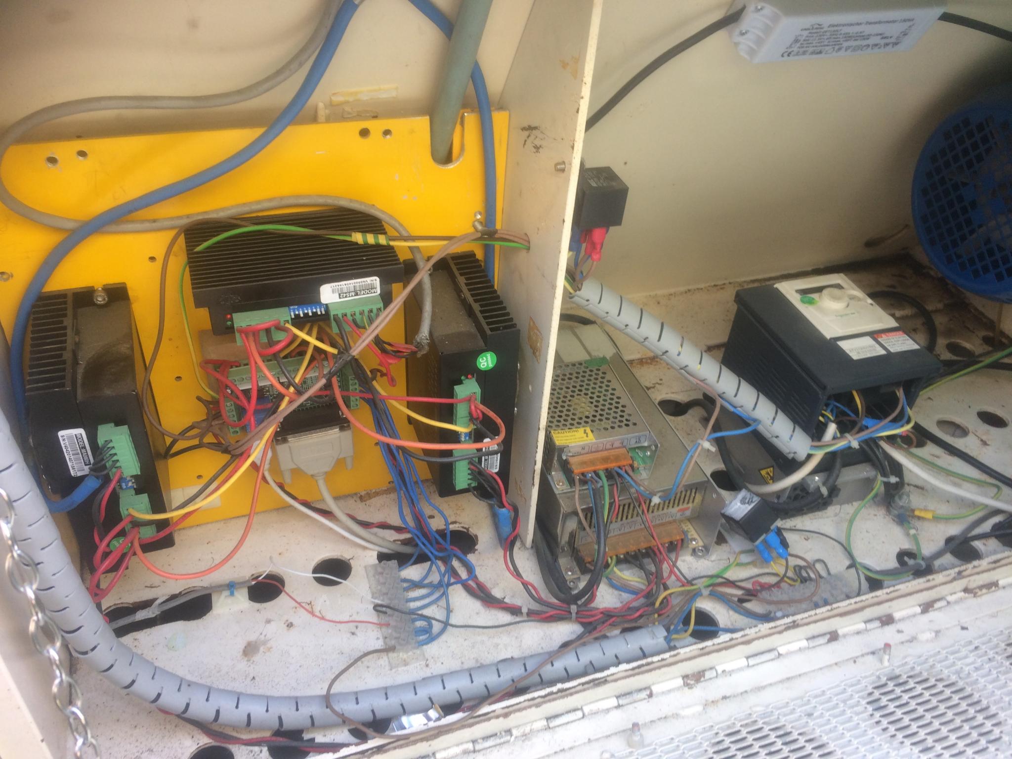

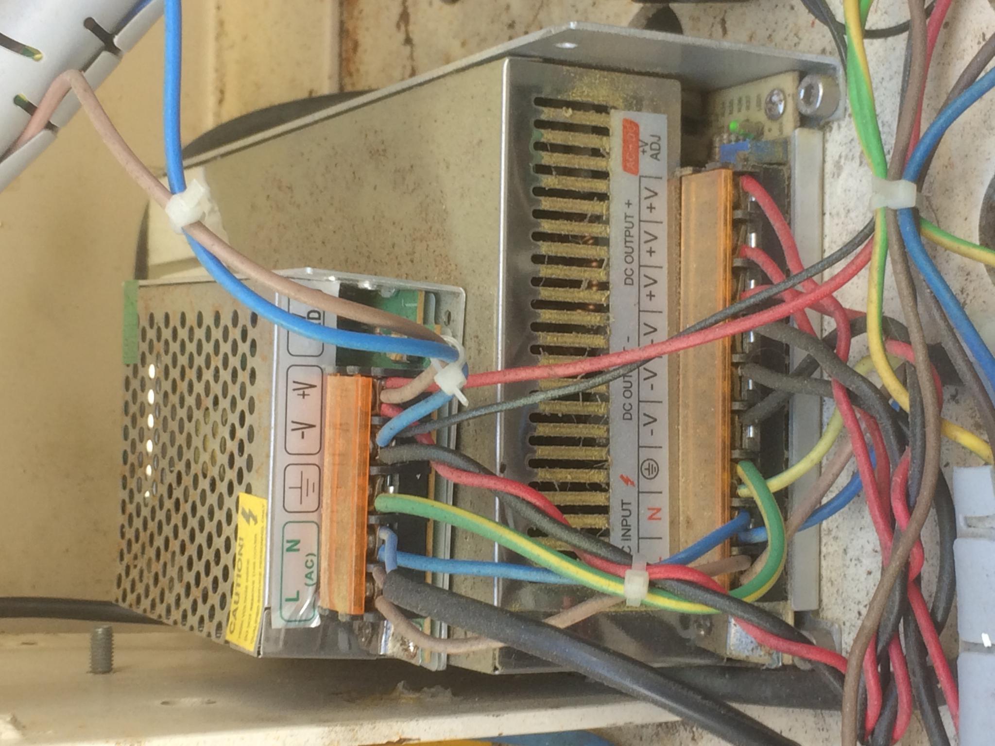

    now the weather is find and we are in lockdown i have moved all the crap and taken back wall of the shed out to get to the electrics please see pictures cant see any fuses and two relays

    two of the black boxes have leds showing green the other box does not have leds on it
