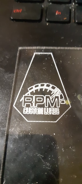

    I am trying to engrave an A4 sheet of 2mm thick perspex with a 0.02mm depth of cut and then cut out the parts and my problem is getting the damn thing flat. I have secured a sacrificial piece of 12mm perspex to the table and skimmed it and have then secured the 2mm sheet to it with double sided tape. The problem is the tool is the correct depth at the start of the cut but there are areas where the tool is shy of the workpiece, where the cutter misses the perspex is different for every workpiece so I am assuming that the double sided tape is to blame (I cover 95% of the workpiece with the tape). I am wanting to engrave 12 of these onto the A4 sheet.

    0.02mm depth of cut is too small. use spring loaded diamond drag for such jobs, as it gives exactly that depth/ width and is much cleaner from what i see on picture.

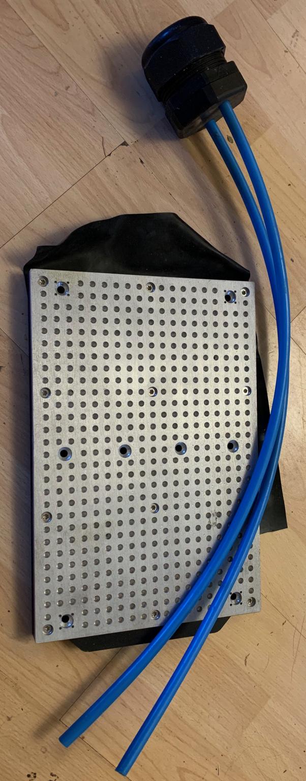

    Preston, Lancs?, I used to have (will have to have a hunt around) an A4 vacuum bed that I've simply never used. If I can find it you're welcome to it. I'm almost inclined to agree with Boyan, but thinking more a floating head. Or use a device attached robustly to the spindle body that presents a flat (non-scratch) foot at the material top level that sits around the cutter, so that as the cutter moves over the surface the foot presses the material around the cutter down and close to the machine bed. There must be a name for this (Quick!, to the patent office...)

    Found it:
    Yes there is such a device, buts its more for sheet cutting. Have seen it on you tube. But this is not the way for such small stuff. Its super easy to fabricate a simple A4 vacuum fixture
