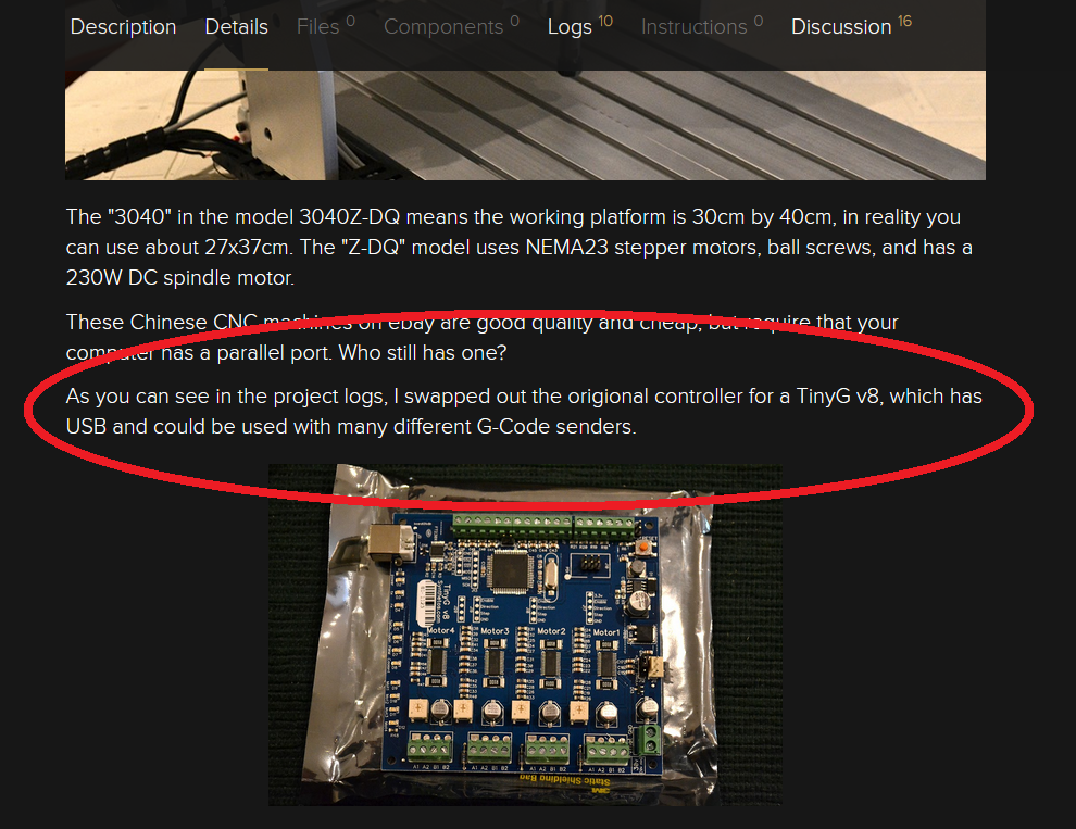

    I miss the part where the controller is removed - though recognise that OP replaced the original software ("program"). But, these type of questions that the OP have raised are best answered from a single non-conflicting source, and no-one here doubts that you're best placed to support that. I'll back out of this thread.
    Put your teddy back in the pram I wasn't having a go at you...Lol, The more experienced heads the better.
    My comment was to point out that what he's showing isn't the same and saves going down wrong paths.

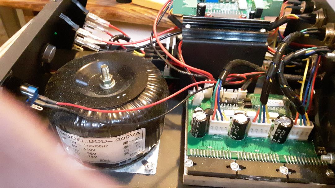

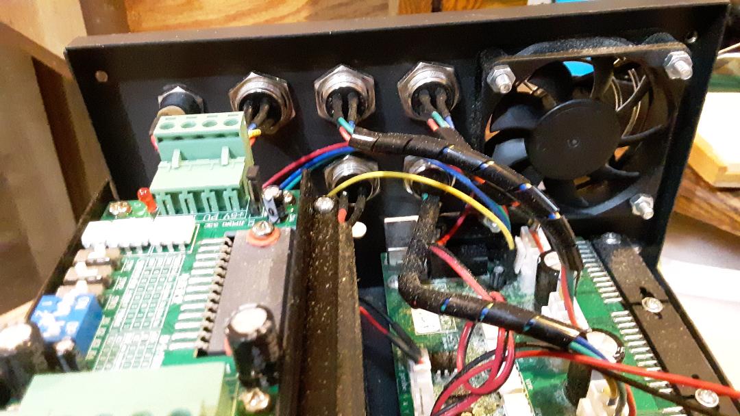

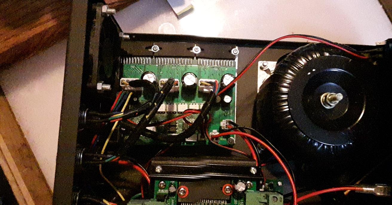

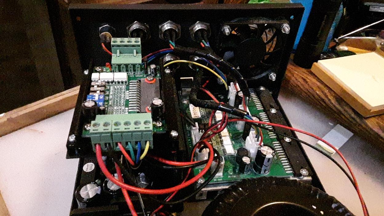

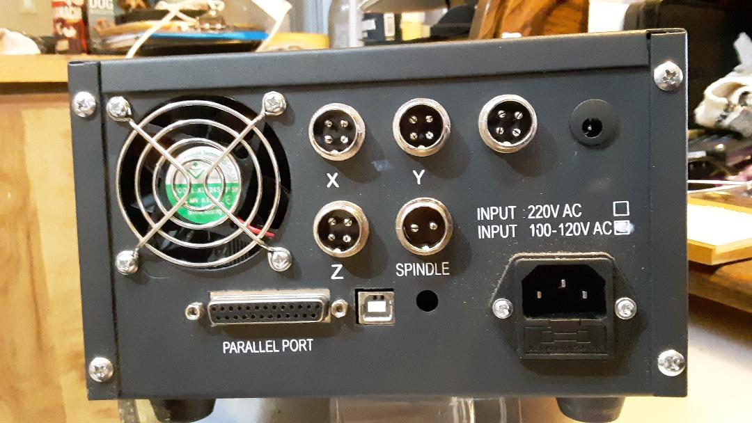

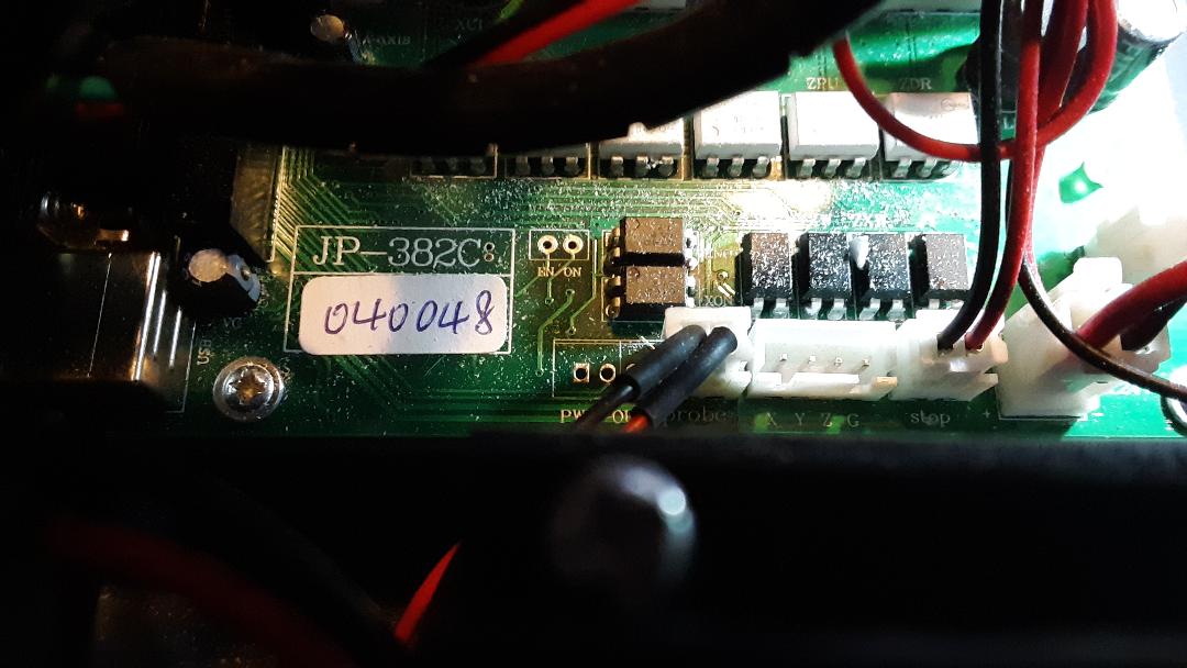

    2-pin spindle connection on the back goes to a JST on the PCB located low down, between the fan and the toroidal. That PCB also has the parallel port and USB port on it, so I'd suggest its just a case of identifying that PCB and finding a manual to determine the pins.
    GeneO, can you see any markings on the board in the middle of your first photo? The one that sits right behind the fan. I'm looking for a model name, number, manufacturer. Something like that. There seems to be some writing above the handwritten label on it, but its hard to make out from the photos.

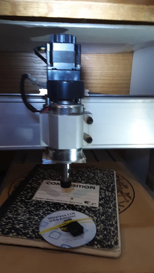

    Looks to me like a low power DC spindle, so the exact RPM is going to be a bit subjective.

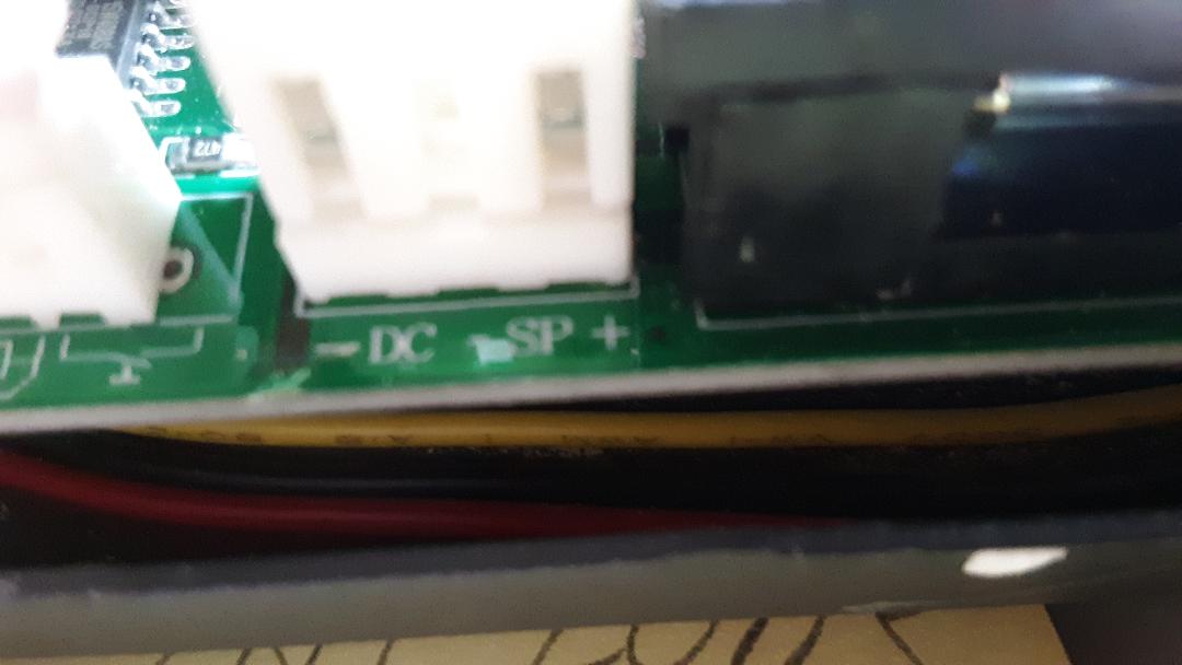

    On the pcb behind the fan there is a number it is JP-382C . Also there is a hand written number that is 040048 (see pic)
    the wires that go to the spindle plug has a -DC SP+ (see pic) Can you tell me what voltage the spindle motor is? It has no labels on anything. Hope this helps. Click image for larger version.

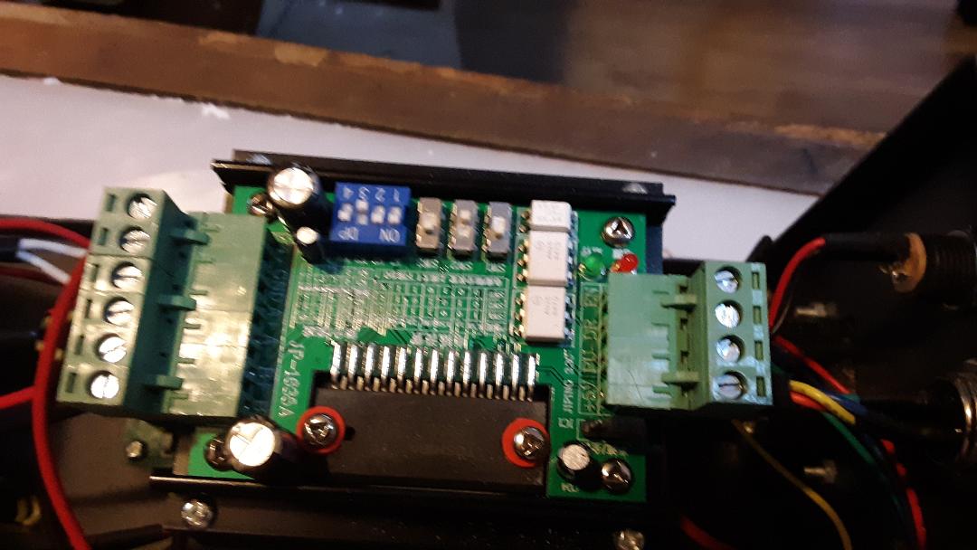

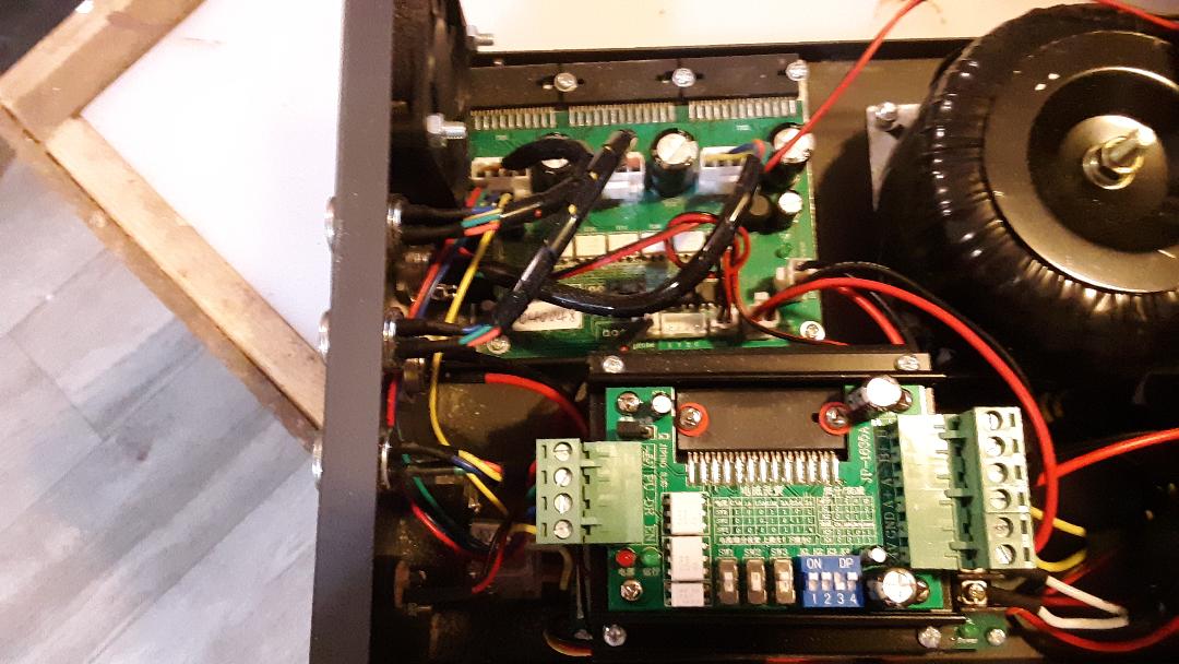

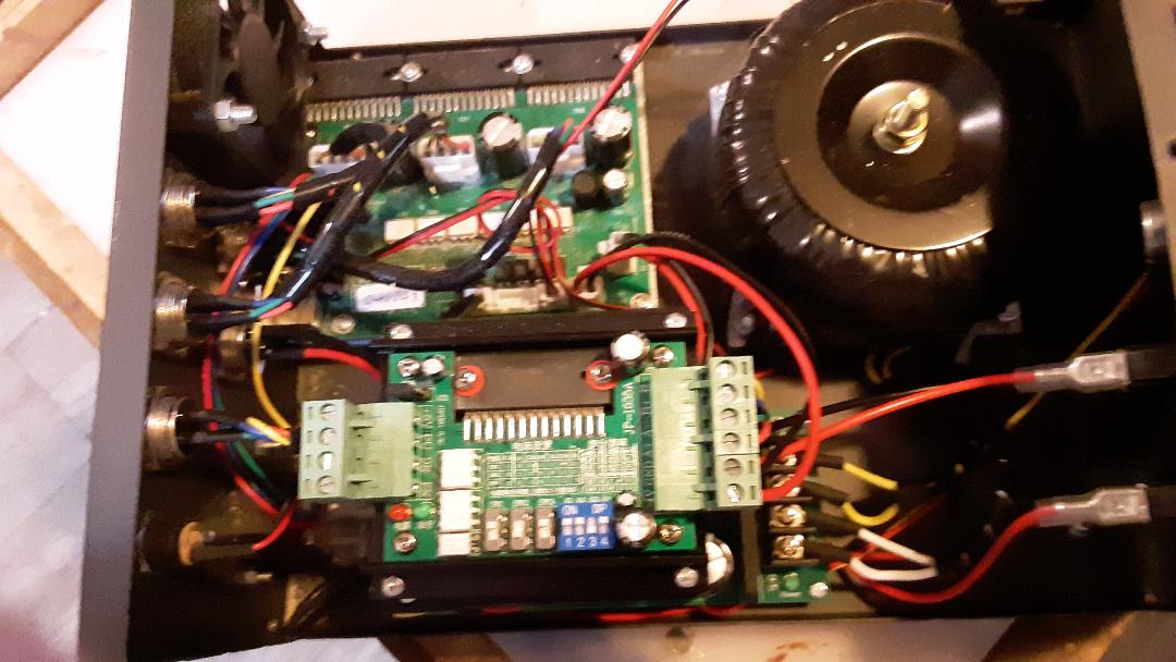

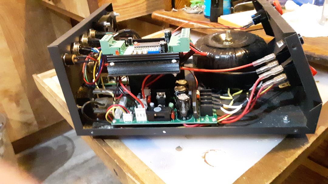

    The JP382C is the CNC control board. The two boards stacked together are the 4th axis and Spindle board. Top one JP1635A is 4th axis the lower JP1482 is the Spindle/Power board.
    This board rectifies the AC power from the transformer for the drives, The fans, and the Spindle. As well as doing the PWM for the spindle and from what I can tell the Spindle is 54Vdc. The Drives are 27Vdc, which fits with the TB based drive Chips. Here is a link to schematic for the Spindle board.
    https://hackaday.io/project/6776-304...ller-schematic
    Unfortunately, I haven't yet tracked down the pins you need but I will bear with us.
    I can now jog the 3 axis, but the spindle shows no sign of turning. I know it's good because the rudimentary program that came with this machine worked, and the spindle turned. It not running started when I bought mach3. Also, I'm an American and use inches for measure. The only thing I see about changing it to in. is in the config and tells me not to change it. Do you know?
