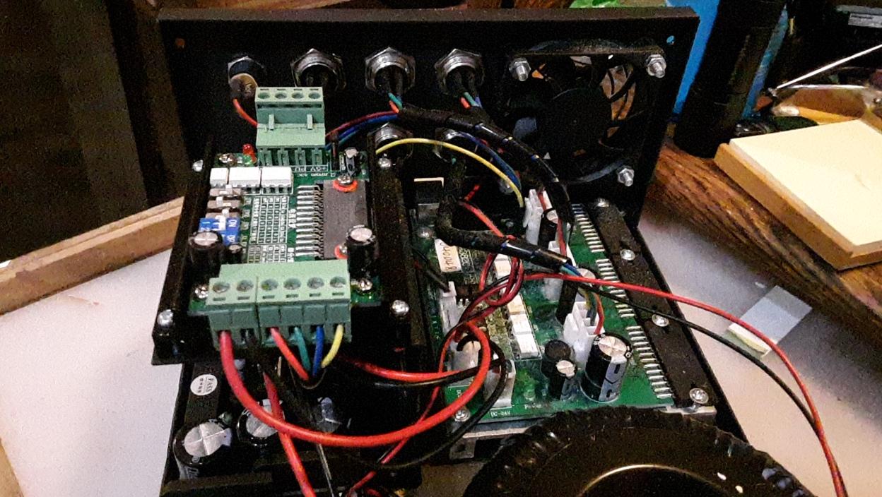

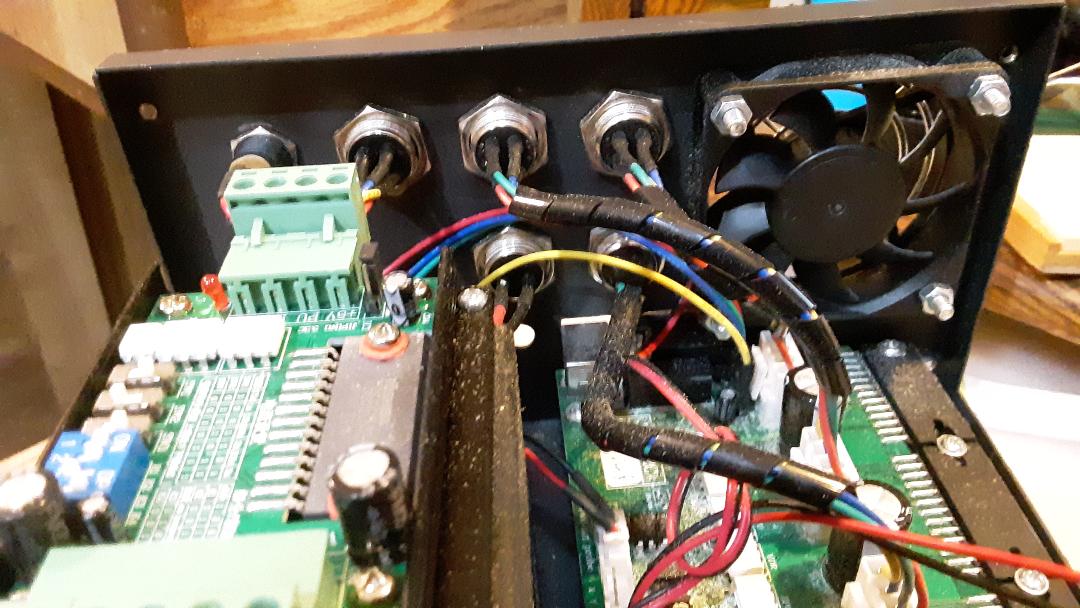

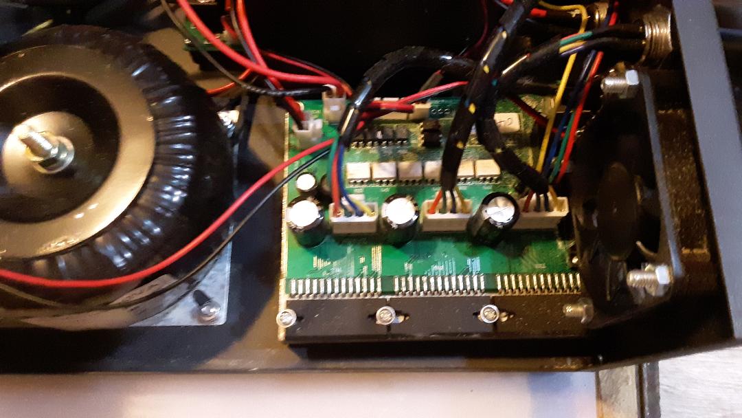

    Sorry for your frustration. Keep in mind that I am not a techie. I'm just an old machinist who is retired, and wants to learn something new to keep myself busy. I took off the black box lid and this is what I got. Hope it helps.Click image for larger version.

  4. #24
    2-pin spindle connection on the back goes to a JST on the PCB located low down, between the fan and the toroidal. That PCB also has the parallel port and USB port on it, so I'd suggest its just a case of identifying that PCB and finding a manual to determine the pins.
    GeneO, can you see any markings on the board in the middle of your first photo? The one that sits right behind the fan. I'm looking for a model name, number, manufacturer. Something like that. There seems to be some writing above the handwritten label on it, but its hard to make out from the photos.
    Looks to me like a low power DC spindle, so the exact RPM is going to be a bit subjective.

  6. #26
  7. #27
    The JP382C is the CNC control board. The two boards stacked together are the 4th axis and Spindle board. Top one JP1635A is 4th axis the lower JP1482 is the Spindle/Power board.
    This board rectifies the AC power from the transformer for the drives, The fans, and the Spindle. As well as doing the PWM for the spindle and from what I can tell the Spindle is 54Vdc. The Drives are 27Vdc, which fits with the TB based drive Chips. Here is a link to schematic for the Spindle board.
    https://hackaday.io/project/6776-304...ller-schematic
    Unfortunately, I haven't yet tracked down the pins you need but I will bear with us.
