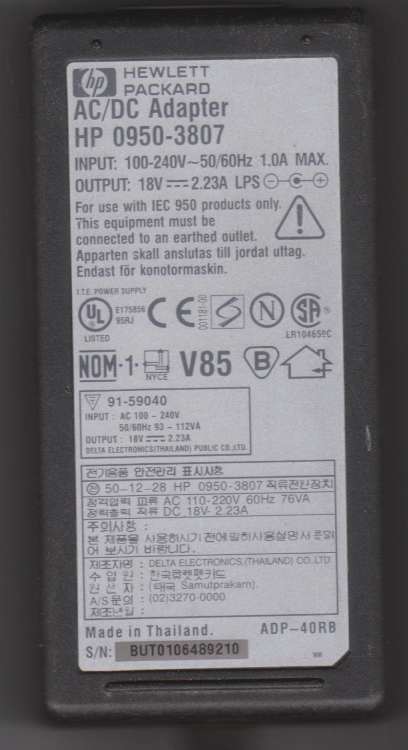

    When I refired to the 36V I was thinking using a DC -DC buck converter. Yes 36V is too high I would not go above 24V.
    2A is nicer.
    https://www.ebay.co.uk/itm/MDR-60-24.../283552504762?
    or
    https://www.ebay.co.uk/itm/Din-rail-...cAAOSwxlxd3f2c
    I used one of the 2A units on mine, works great and for £12 you can't argue!

    Rummaging through my extensive collection of junk I found this. 18v 2.3A rather than 24v - any good?
  10. #20
    Quote Originally Posted by Agathon View Post
    Is 1A enough to do everything? Thanks for the links.
    How long is a piece of string.? Nobody can answer that unless they know what "everything" is.? Only you know what you are going to add to the machine and what current each "Thing" will draw.!
    However, based on experience I can tell you 1A is on the low side. I'd go 2.5A minimum and ideally 5A to allow for future additions. That said always check the current draw of what your fitting to check you have enough spare capacity.
