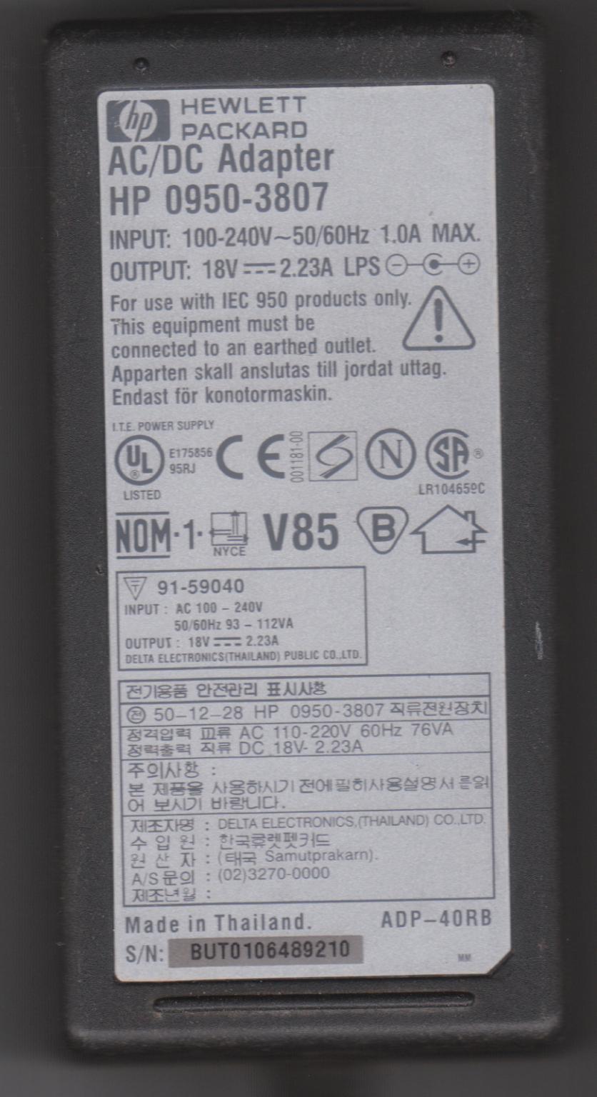

    Rummaging through my extensive collection of junk I found this. 18v 2.3A rather than 24v - any good?
