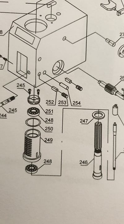

    I currently have a Chester 20v Mill which has been converted to CNC. I'm aware these machines are similar to others that have a R8 spindle, Is there a machine similar enough to take the complete spindle and motor and fix to my machine to replace the MT2 spindle.

    Just curious, but is there a specific tool you can't find with MT2 shank, or why would you want to go R8? The tool range with MT2 shank kinda matches the maximum rigidity of that machine.
    Hi thank you for your reply.the tooling range is great and suits the mill well I'm looking for the R8 to utilise the tormach tts holders for a quick tool change
    Have you had a look at this thread: http://www.cnczone.com/forums/bencht...omparison.html
    they all seem to be from the same patterns so I would be surprised if you cannot get the spindle you want. If you bought new, maybe Chester can get you one delivered from China.

    did you ever find anything out about an r8 spindle ?
ID:	27019 here yoy see the parts you need and you can order this parts via mailto:[email protected]
    the complett spindle R8 Cost you about 180usd to your door
