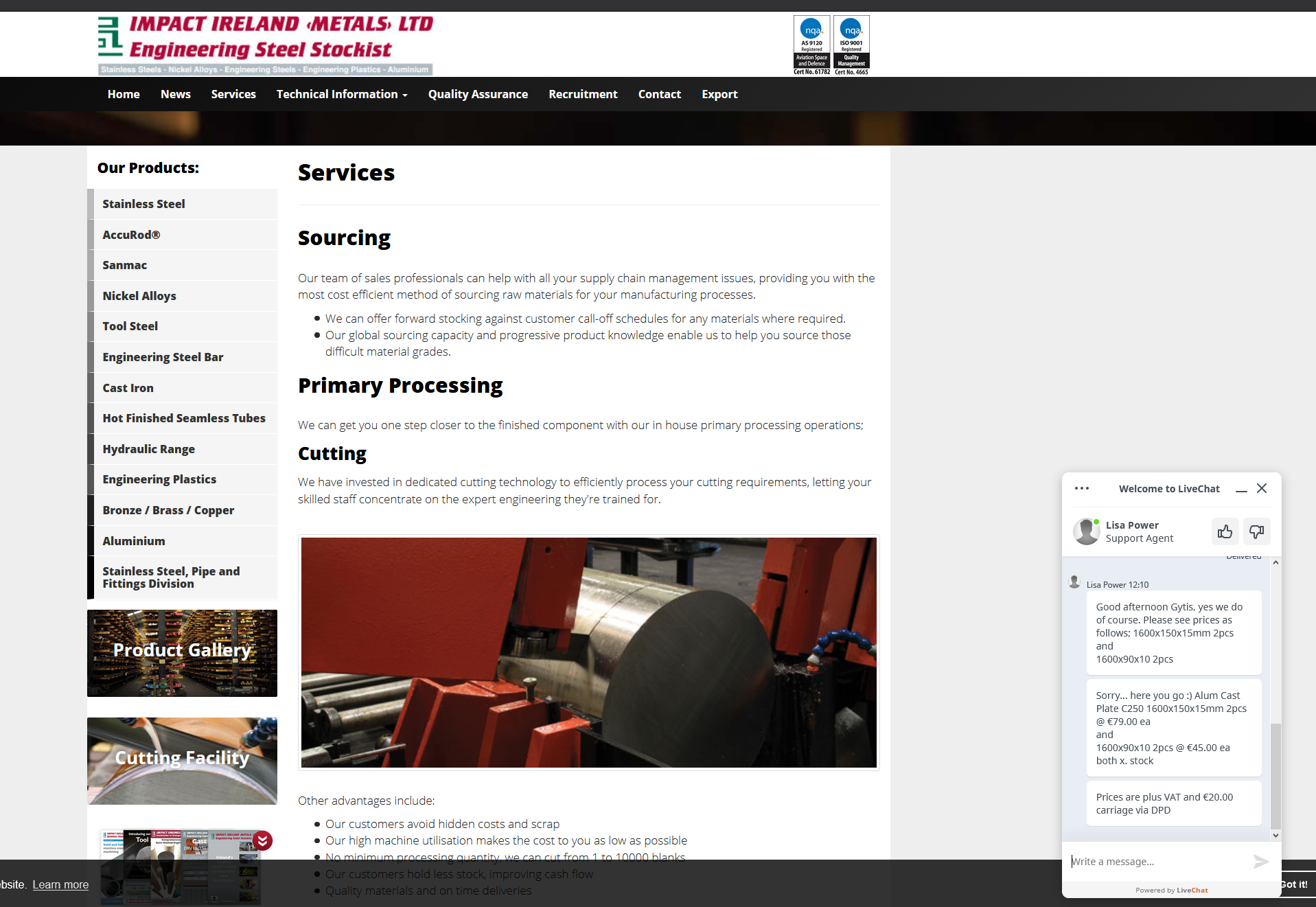

    you can try www.impactirl.ie
    they have online chat with immediate response so worth a try, and better prices than aluminium warehouse (see screen shot for price reference)
    but I'm sure you can find it locally just email to metals supply companies or make a call...

    Try searching for a Mic1 tooling plate might have more luck finding something closer to home.
