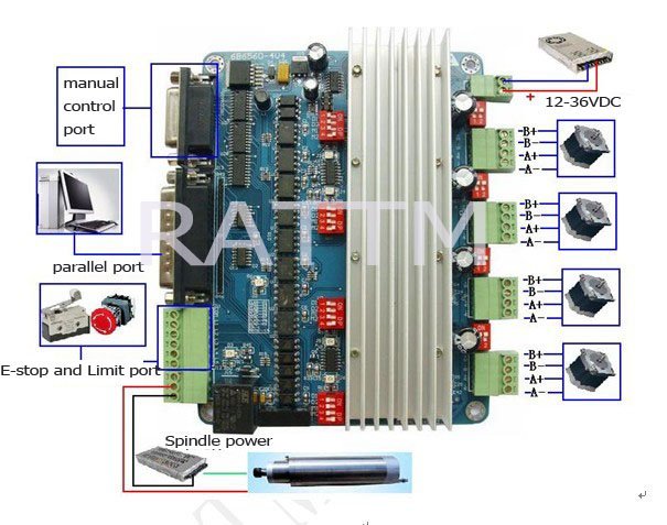

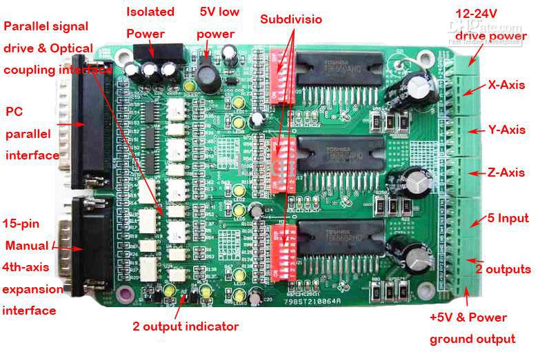

    Thank you both for your replies. I just don't know where to add the up down wires to the board as the only free connections are either on the 15 pin remote plug or the 12 pin connection just behind it which seems to be used to connect a dro. All other connection points are used up with motors, e stop and limit switches
    Ahhh i see, have you got a better picture of your TB 6560 as there are several variations:

    Such as the one above that dosnt appear to have the ones you mention behind the 15pin D

    This one clearly shows some spare inputs on the right..
    I know you have a Ebay picture listed but can you get a better picture of the terminals for me..

    If all else fails and you have used all the inputs near the Estop input (there are 4 possible) then you may have to use the pendant input (15pinD) lets see what the pic tells us
