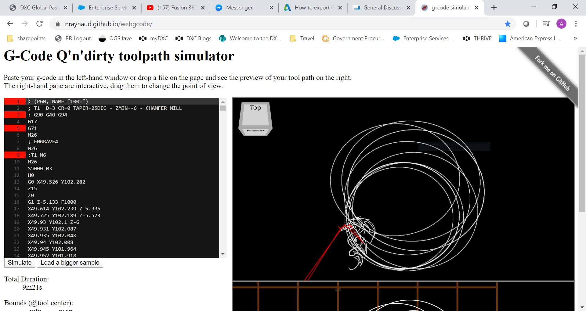

    Unfortunately when I load this to my CNC controller (my machine came with USB CNC) - it refuses to load with a message it didn't understand line 1 -
    Now - if I take the file and load it to "quick and dirty g code simulator" - this shows a number of lines in the code it doesn't understand and the simulation is rather different - see screen print

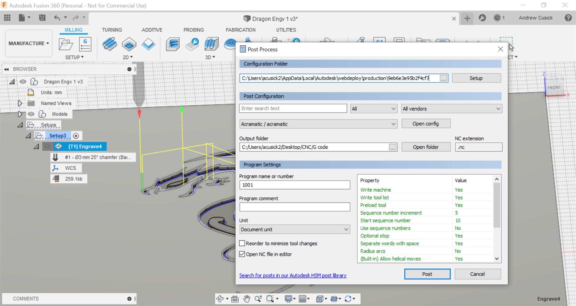

    there's more than one ?? - I used the engrave and just right clicked to bring up the menu and selected post processor - see the screen print, I'm really quite a dummy here

    The post processor will produce G-code that suits the specific machine control software you have. The differences between machines are usually quite small but none the less significant. Remember that G-code for CNC machine control has been around since computers were made from triodes so it's inevitable that there will be some variations between different generations of machines and their software.

    You need to use a post processor that is compatible with the machine you are cutting on (if I am reading what the problem is correctly)
    If you are using Fusion 360 you should be able to find a PP here ;_
    https://cam.autodesk.com/hsmposts
    Just ignore this post if you have already done this

    Really helpful, thank you so much - I followed this up - but discovered that there is no PP on the fusion site for USBCNC, but now i knew what I was a looking for and found this - just in case anyone else is looking for this
