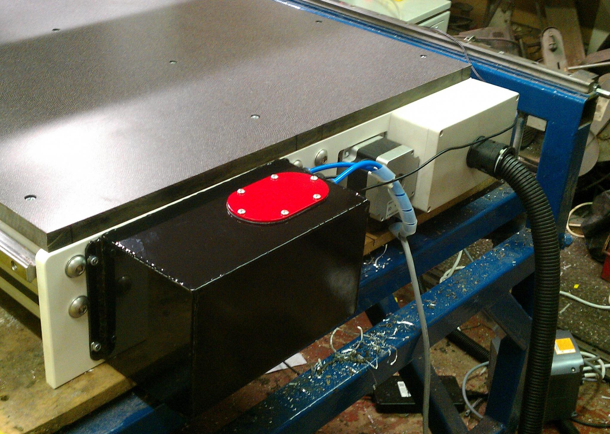

    However back to the cooling, like Neale says don't overthink this one as it doesn't need any fancy cooling system. Every machine I build uses a WC spindle and all of them bar 5 or 6 have had 20Ltr tubs of water located either under the machine or on the floor using a 24Vdc pump with head height of 7-8mtr.
    If you are doing long jobs 2hr's + then it's a good idea to had a flow sensor just in case the pump goes down. But other than that KISS works.
    Edit: If using bucket setup just add some antifreeze and try to use a bucket that blocks out light and you'll have no issues with water going bad.
    Here's a setup that didn't use a bucket but instead used a small tank with pump inside bolted onto the rear of the machine. This also works perfectly and the tank only holds 3ltrs of water. Before the pump failed on my machine I was testing a PC rad with fan and one of those cheap nasty small pumps with 500ml reservoir integrated into it. This worked perfectly until the pump failed which was more to do with it being a cheap nasty pump.
