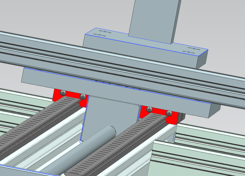

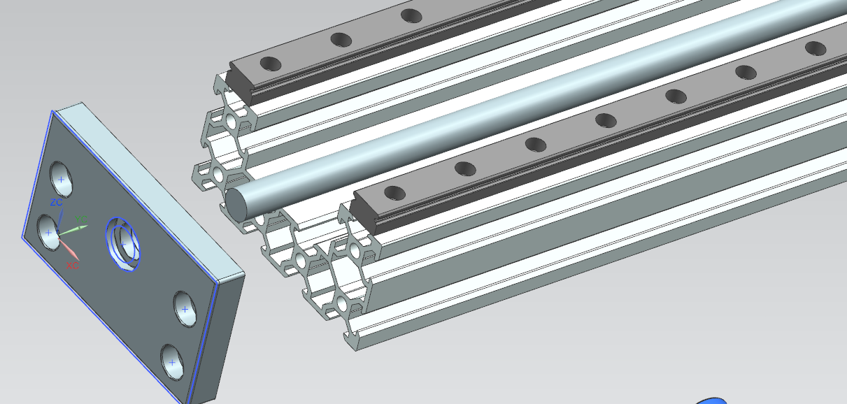

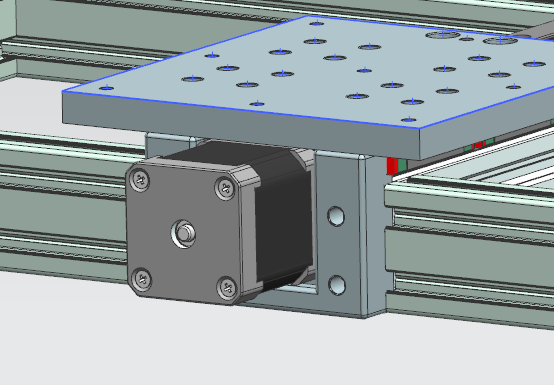

    Dont rush discarding the C beam. Take a look at my design for a DTG printer base using that C beam and said linear rails+some 3d printed elements:

    This is 12 size Hiwin square, which would happily move 0.8kw spindle. I would say even 2kw spindle if 3 blocks.
    But this is not my point. Maybe 15 size and use the C beam like a L shaped gantry. I have never tried it but that's the fun of it, you can figure it out for yourself.
