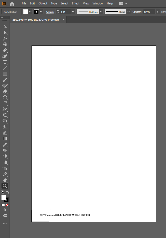

    I tried opening your file in Adobe Illustrator but it contains very little... I have attached a screen grab of what it looks like.

    maybe it's how I'm creating the SVG file then ;-)
    Does 'Andrew' tell you that the file has something in it?
