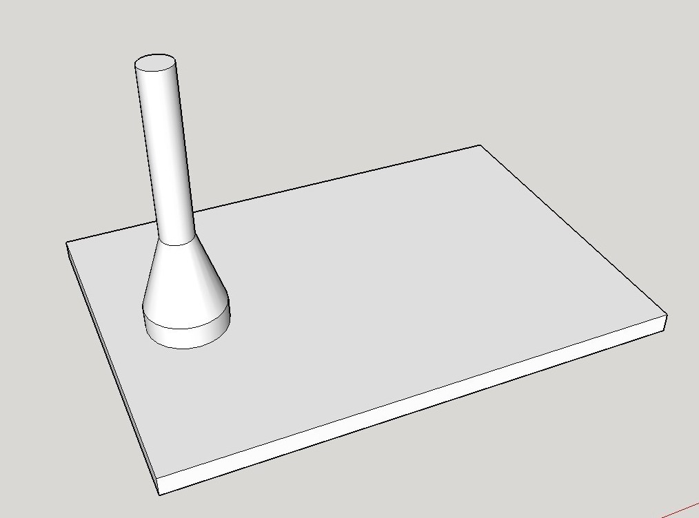

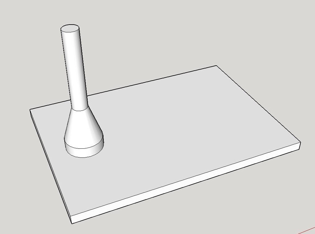

    Anyway, the base has an 8mm vertical rod and the ones that were made before (not by me) have the rod welded into a hole in the base. This makes preparation for chroming a nightmare where the rod is inserted. So my design has a cone brazed onto the rod and then tapped M6 to screw the two pieces together from underneath.

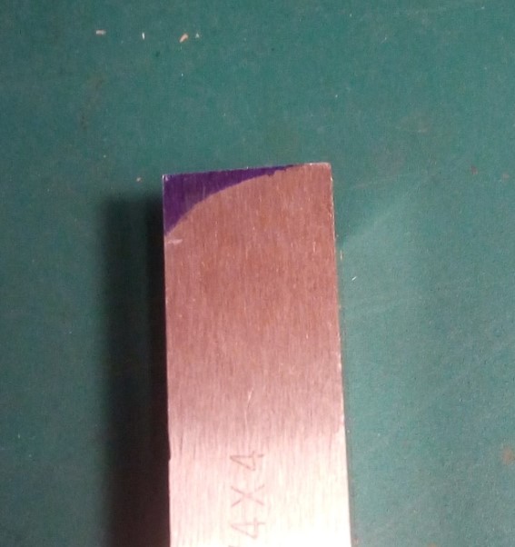

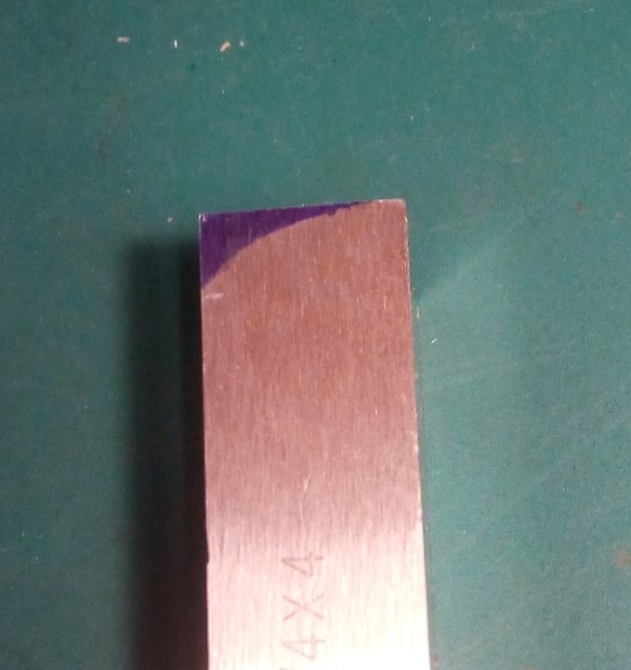

    I wish to turn a curve into the cone and so I am thinking of grinding a tool from a 3/4 sq HSS blank

    My query is - will I get away with a zero degree rake on the cutter ?

    I wouldn't try that if I were you - that's an awful lot of grinding! 3/4 sq HSS is tough stuff - and do you have the height to accomodate it?
    Better would be to use a bit of thinner gauge plate or an old file - in the latter case get it red hot and keep it there for several minutes to soften. Then you could form the profile and harden. You might get away without to rake if you take it slow and use lots of coolant. Of improvise a kind of "inverse ball turning fixture" so you can use an ordinary turning tool and move through an arc.
    Easiest if you have only one to do would be to form the curve by a series of small steps then smooth out with a half-round file.
    You are right about the piece of HSS, it is too thick to go in the tool holder, maybe only by a mm or 2, but that would mean a time on the surface grinder. It might be easier to get a smaller piece (1/2 x 3/4) or nearest metric equivalent.
