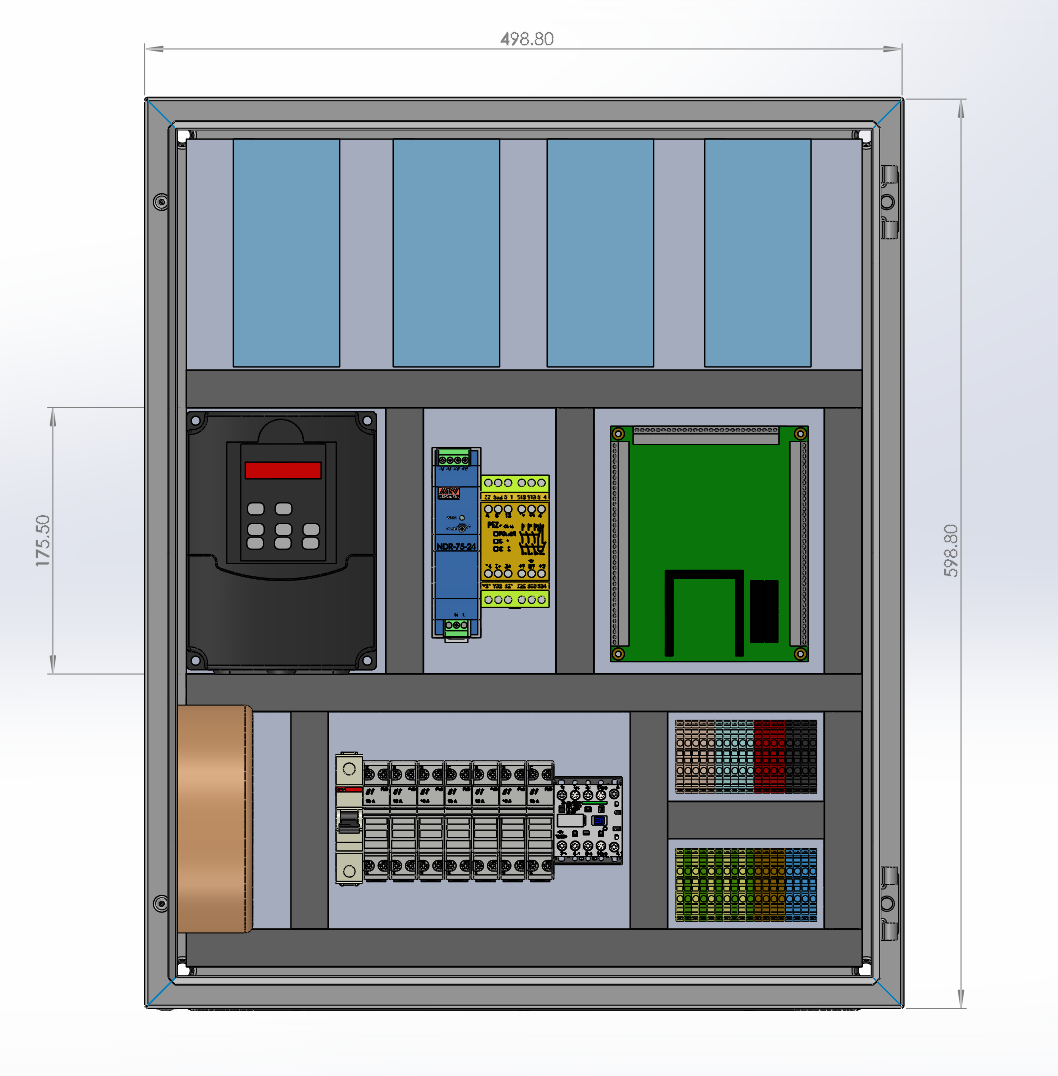

    I'm at the stage where I'm ready to put all electronics into the control box, I have all the electrical parts except vfd, I would like to get mechatron vfd and spindle set but it all depends on how much spare money will be left after I built the cnc router,
    so the question is, if I dont have enough finances, will I then be able to fit chinees 2.2kw vfd into the exsisting layout?
    I was trying to find measurements but thay are all different, would be great if someone could confirm actual dimensions for me.

    These are taken from Huanyang VFD and slightly oversize by few mm W130 x H175 x D175

    Note that the manual mentions you should leave extra space 5cm horizontally and 12cm vertically. How many people pay attention to that though is up for debate.

    Having some experience with power transistors I can say with confidence that poor cooling airflow is a major cause of early failures. Equipment enclosures with fans that circulate the same air round and round are more common than you'd imagine. This is one reason why my own VFD is mounted on the wall and not in the control box. The other one is that the box isn't big enough
