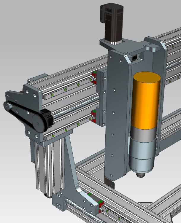

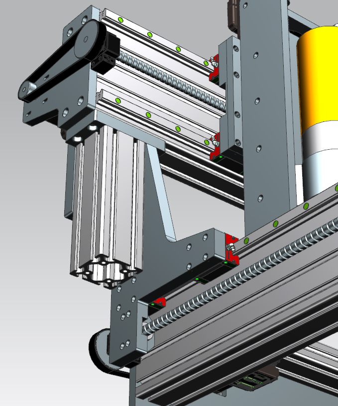

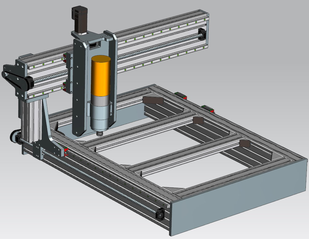

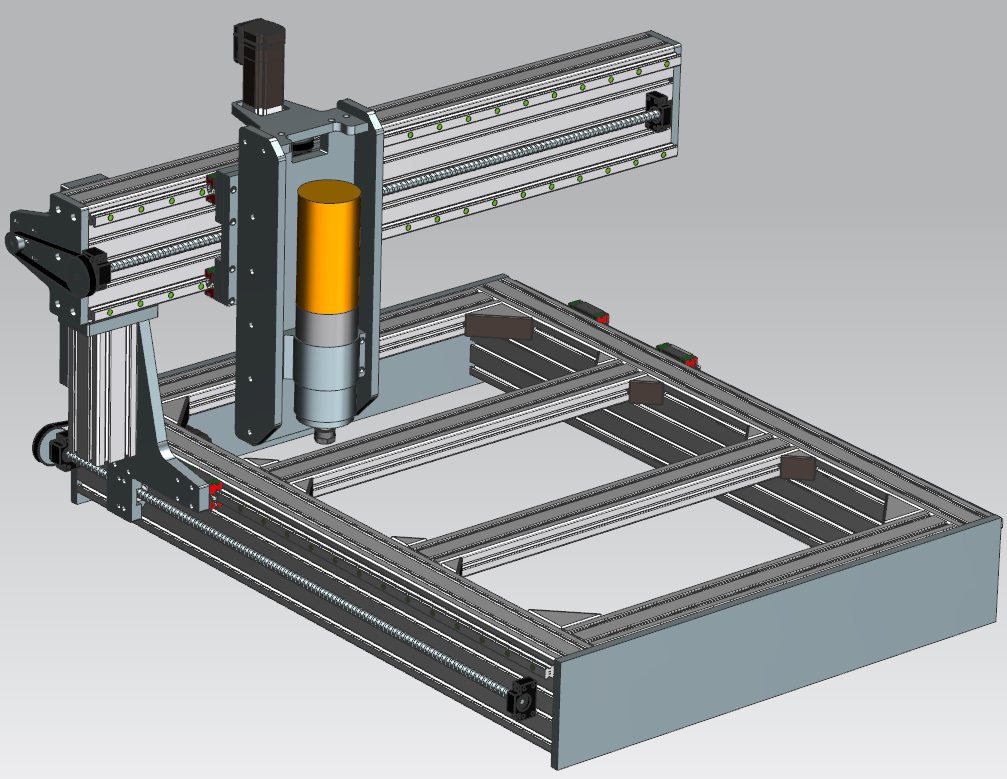

    I have taken some inspiration from the gantry design in your machine. What I've done differently is:
    • It is far from done and many details are still missing. One gantry side is still missing completely.

    • Y-axis linear rails are side mounted to the 160x80 item profile. This allows a larger work area and the ball screws can be mounted to the same piece of aluminium plate, with a little bit of machining.

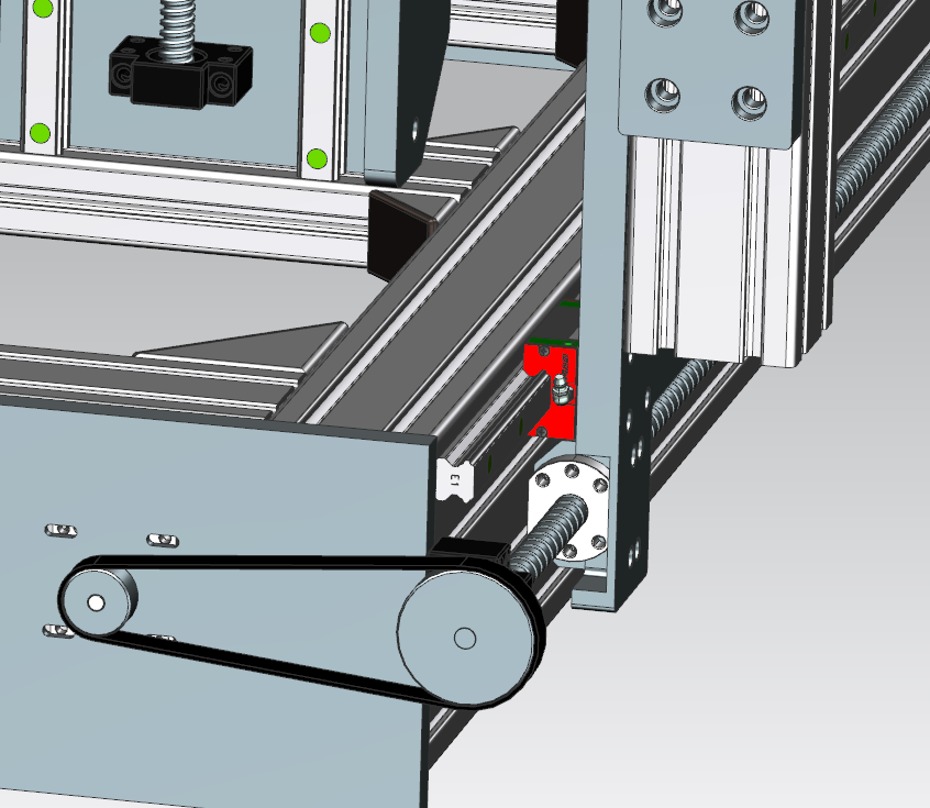

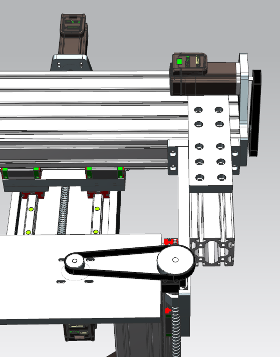

    • Gantry side plate is on the inside and an 80x80 item profile is mounted on the outside of the plate. The 80x80 item profile is mounted to the X-axis 200x80 item profile with a back plate and a bottom plate.

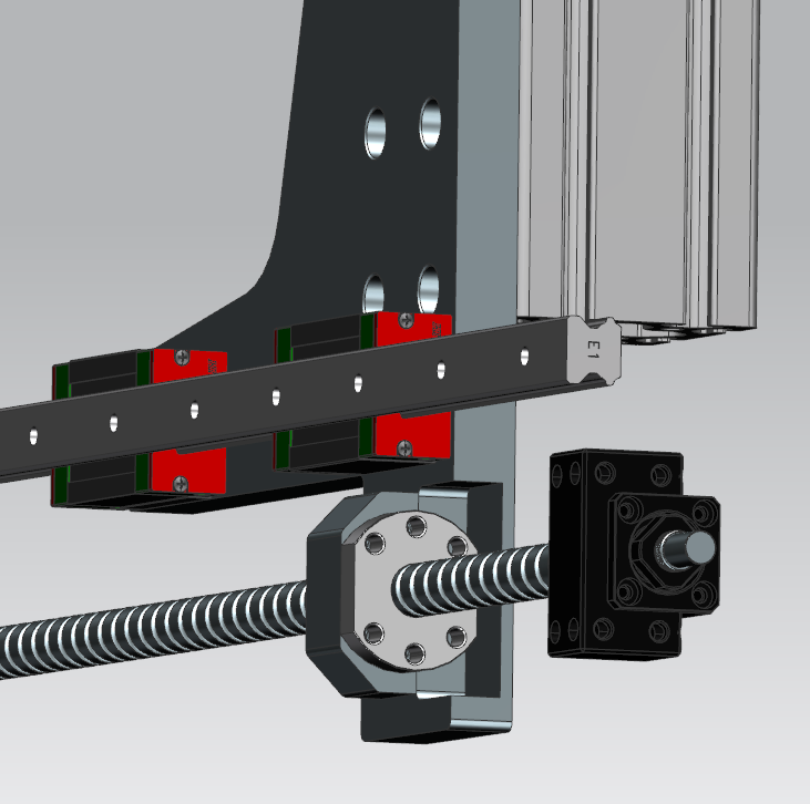

    • The X-axis ball screw and linear rails are all on the front side. With some machining on of the aluminium plates, I am able to squeeze everything in the with custom made ball screw nut brackets.

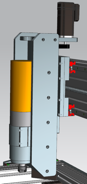

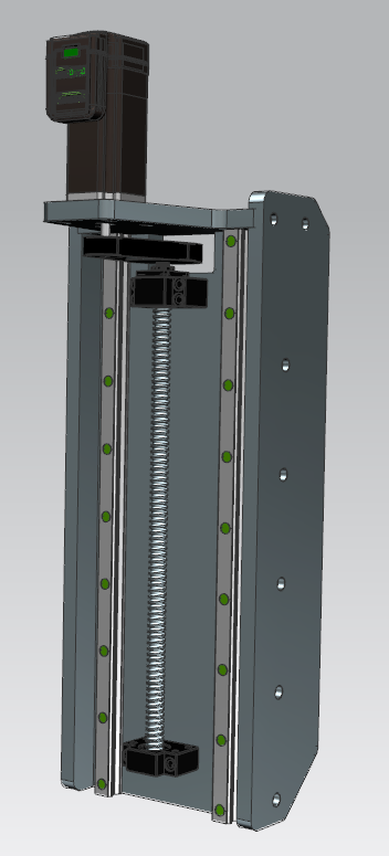

    • The Z-axis is made stiffer with side plates bolted onto the same plate to which the linear rails and ball screw is bolted.

    Please let me know what you think! Are there any significant improvements I could do to make it better?
    The main issue I see is the Z-axis and the unnecessary weight of it.!
    You don't need or want the motor and ball-screw on the front plate because you are just moving around dead weight which will affect the z-axis negatively due to high inertia. Those 180W servos won't handle that weight, especially if your planning on using a large spindle or ATC spindle. You will also need a brake to stop it dropping when unpowered.
    Ideally, you want a light but strong front plate with no excess baggage to affect inertia. The ball-screw could easily go on the rear plate and be shorter, the motor could mount to plate coming off slightly longer rear plate. This longer rear plate will also allow more spacing of the bearings which will stiffen things up a little.
    The other thing I don't like is the ball-screw on the front. If it was me I'd mount it at the rear out fo the way of chips etc and have the ball-nut mount to the plate which the Z-axis motor mounts onto. Don't worry about the ball-nut not being in the so-called theoretical ideal central sweet spot of the front plate because in real-world the difference isn't noticeable. However, weight in the wrong place very much does affect the machine.
    Thanks man, Ill revise my design and start a build log to collect more feedback!
    Do you still recommend that the linear rails stay on the Z-axis front plate? It would be significantly less weight to move if they are on the Z-axis rear plate, but not as stiff of course. Stiffness could however be increased with some aluminium strips.

    Quote Originally Posted by NordicCnc View Post
    Do you still recommend that the linear rails stay on the Z-axis front plate? It would be significantly less weight to move if they are on the Z-axis rear plate, but not as stiff of course. Stiffness could, however, be increased with some aluminum strips.
    If I'm honest I don't find there's a lot of difference between them. I used to build all my machines using rails on the front plate and yes it is slightly stronger but it does have some drawbacks. The weight is one but the other is tool height or should say gantry clearance because of the tool length sticking down below the gantry.
    With the rails on rear plate, you can raise the tool above the bottom of the gantry allowing for longer tools or a lower gantry clearance if you don't need the height for the material.
    The machine in the video as the rails on the backplate.
