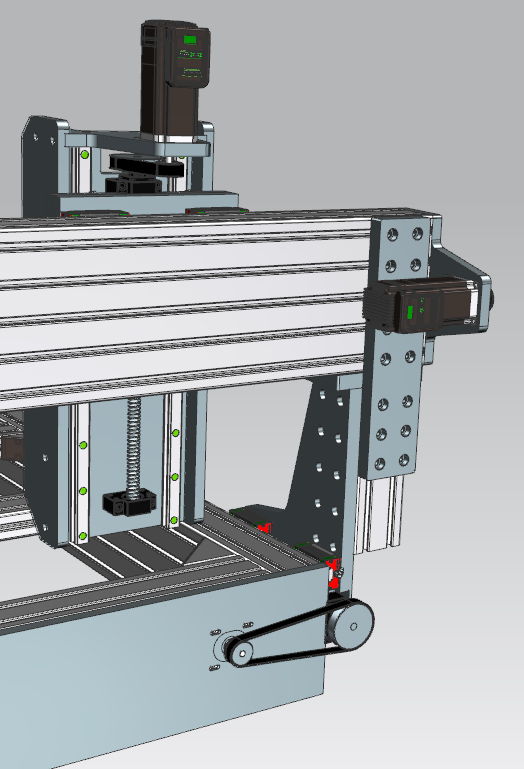

    I have taken some inspiration from the gantry design in your machine. What I've done differently is:
    • It is far from done and many details are still missing. One gantry side is still missing completely.

    • Y-axis linear rails are side mounted to the 160x80 item profile. This allows a larger work area and the ball screws can be mounted to the same piece of aluminium plate, with a little bit of machining.

    • Gantry side plate is on the inside and an 80x80 item profile is mounted on the outside of the plate. The 80x80 item profile is mounted to the X-axis 200x80 item profile with a back plate and a bottom plate.

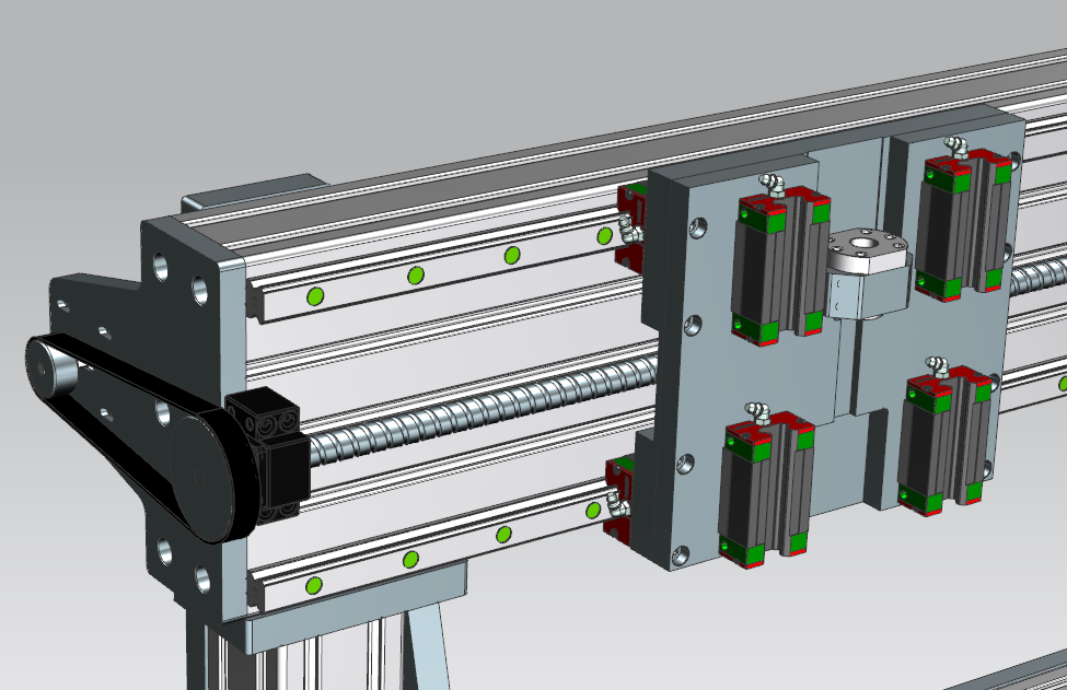

    • The X-axis ball screw and linear rails are all on the front side. With some machining on of the aluminium plates, I am able to squeeze everything in the with custom made ball screw nut brackets.
ID:	27390 Click image for larger version.

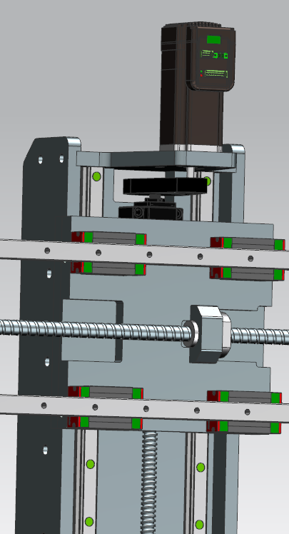

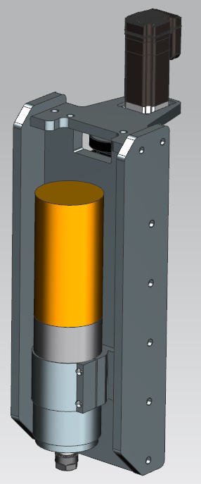

    • The Z-axis is made stiffer with side plates bolted onto the same plate to which the linear rails and ball screw is bolted.
ID:	27391 Click image for larger version.
    Please let me know what you think! Are there any significant improvements I could do to make it better?
    The main issue I see is the Z-axis and the unnecessary weight of it.!
    You don't need or want the motor and ball-screw on the front plate because you are just moving around dead weight which will affect the z-axis negatively due to high inertia. Those 180W servos won't handle that weight, especially if your planning on using a large spindle or ATC spindle. You will also need a brake to stop it dropping when unpowered.
    Ideally, you want a light but strong front plate with no excess baggage to affect inertia. The ball-screw could easily go on the rear plate and be shorter, the motor could mount to plate coming off slightly longer rear plate. This longer rear plate will also allow more spacing of the bearings which will stiffen things up a little.
    The other thing I don't like is the ball-screw on the front. If it was me I'd mount it at the rear out fo the way of chips etc and have the ball-nut mount to the plate which the Z-axis motor mounts onto. Don't worry about the ball-nut not being in the so-called theoretical ideal central sweet spot of the front plate because in real-world the difference isn't noticeable. However, weight in the wrong place very much does affect the machine.
    Don't forget that if you need a longer tool it's because you're cutting into a deeper piece of material which means you have to lift the tip of the tool that much further above the workpiece. An extra 20mm needed on the tool length implies a possible extra 40mm of Z-axis lift to start the cut.
    Cannot comment on the JMC servo's as I've never used them but power is power and 180W isn't massive so you'll have to be mindful of the weight and mass your moving around.
    The budget is healthy though so definaltely possible to build a very nice machine.
