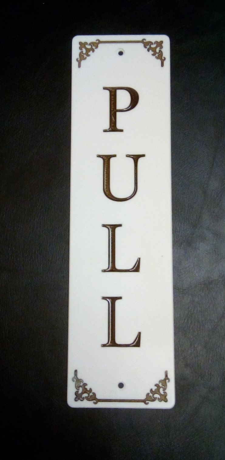

    The pattern was done with a 10deg 0.2mm engraver DOC 0.2 total depth 0.5mm speed 12,000rpm feed 10mm/sec 66% stepover. I use a spray bottle with 75% deionised water 25% isopropanol and a splash of dishwasher rinse aid to kill surface tension. Lettering was done with a 90deg 4 flute V cutter, similar speeds and feeds, but with a more DOC as the bit is stronger. My general rule of thumb for acrylic and wood is DOC = diameter of cutter.
    Infill is Humbrol enamel.
    Hope this helps.
    I am thinking of making a 'wet bench' so I can pump my cutting fluid over it and recover and re-use it. I will post results if I do it.
    Cheers,
    Rob

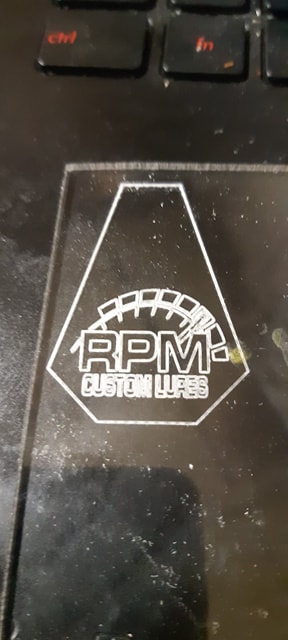

ID:	27313 This is the sort of stuff I have been engraving
