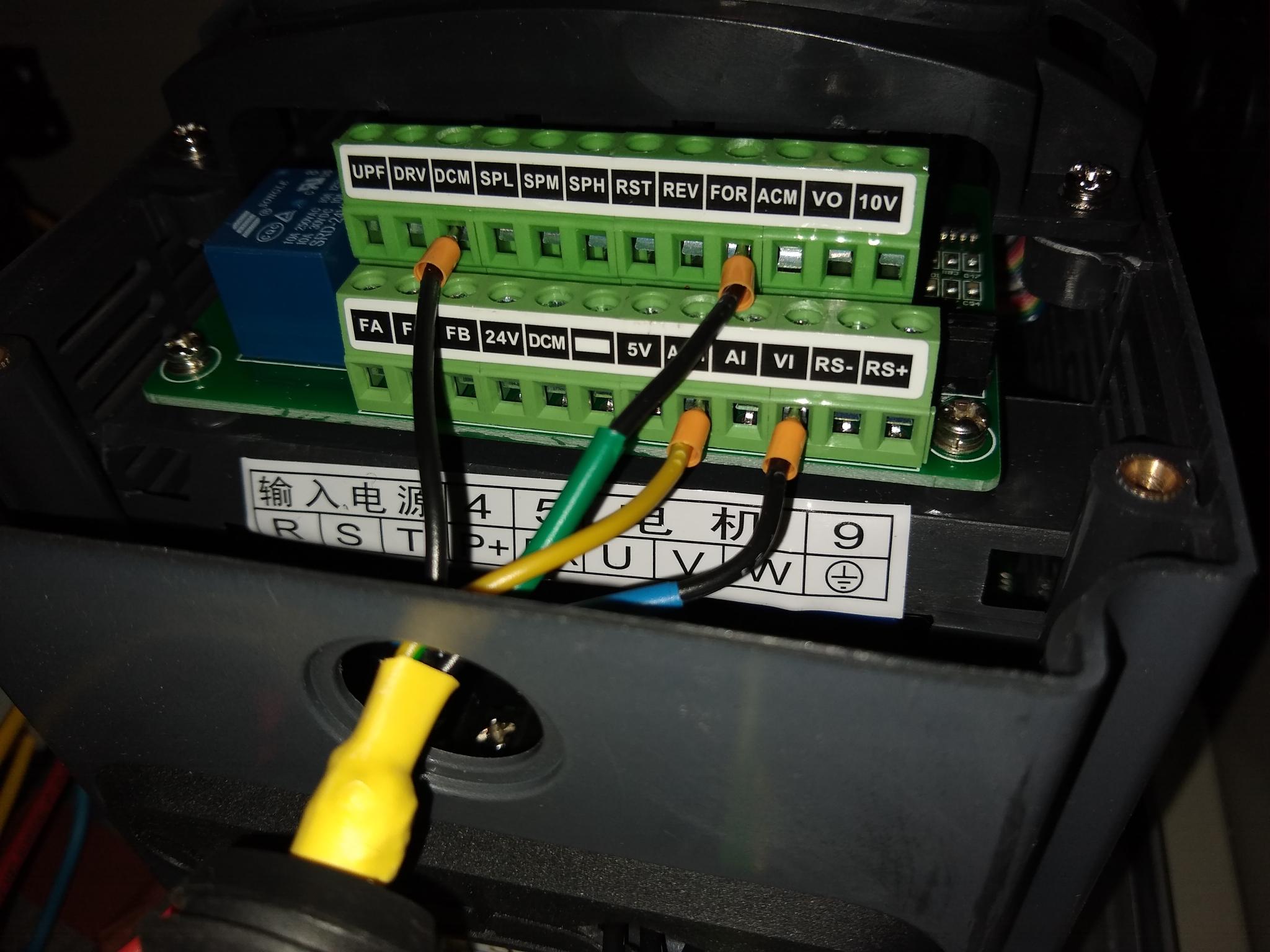

    Spindle wired up and powered on, very carefully !
    Press Run and it runs ok but for some reason goes straight to 24000 rpm and the front speed control does nothing?
    I tried setting Pd002 to both 0 and 1 but made no difference. The "J1" jumper is also shorted pin 2 and 3 e.g VR not VI.
    The spindle spec sheet also says pd070 should be at 1 which it is.
    Am I missing something ? Otherwise 'll try UCCnc control instead and see if that works !

    Still no speed control on the spindle when connected to AXBB-E
    Cabled as above with VFD>AXBB-E
    FOR > O2
    DCM > 24V0
    VI > AO1
    ACM > 5V0 (power out)

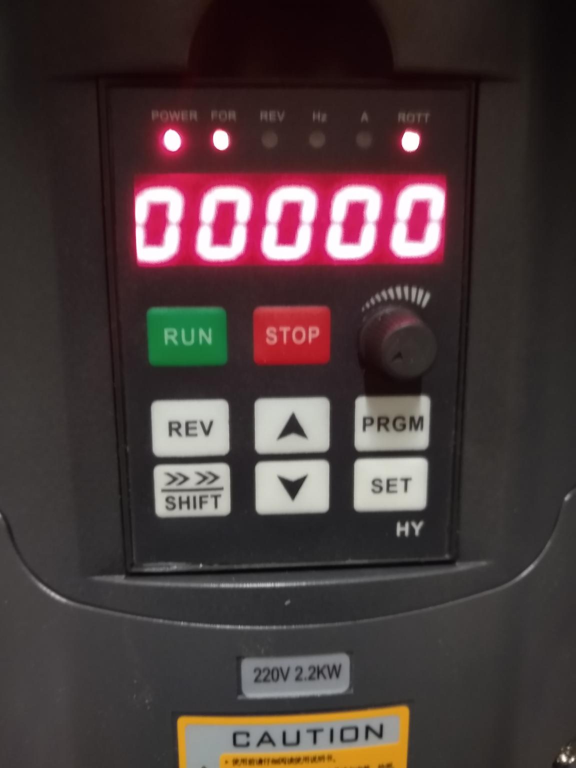

    When I enter in MDI M3 S2500 - the O2 pit diagnostic lights up and spindle FOR lights up and stops flashing, like this:
    But Speed sits at 0!
    I checked the voltage between AO1 and 5v0 at S2500 and it seems to be 0 so possibly the issue.

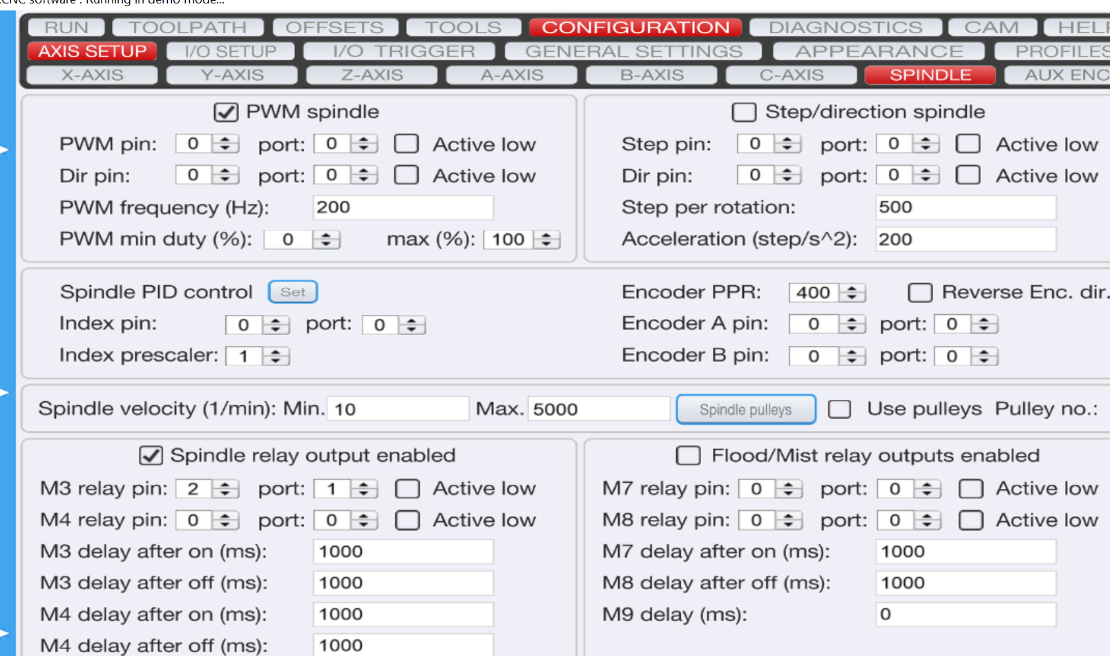

    Here are my settings
    I noticed "SPINDLE CW" light comes on in UCCNC diagnostics too.
    Am I missing some config here or something obvious as I'm stumped!

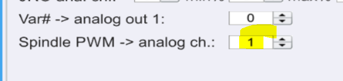

    Sorted it ! It's not obvious in the documentation but there is an extra I/0 configuration screen where PWM channel has to be set to 1 not default of 0.
    Oddly taking the jumper off the Axxb-e still won't output 0-10v, so ended up leaving VFD PD070 @ 5V control too.

    For anyone's reference in future this is the setting:
    Initially I set the spindle min to 5000, max 24000 which I assumed meant it would just not allow a command below S5000, but figured out that meant 5000rpm = 0v, so when I set 10000rpm I would get 7500ish instead! So set min to 1, max 24000 and all good (to the nearest few hundred anyway).
