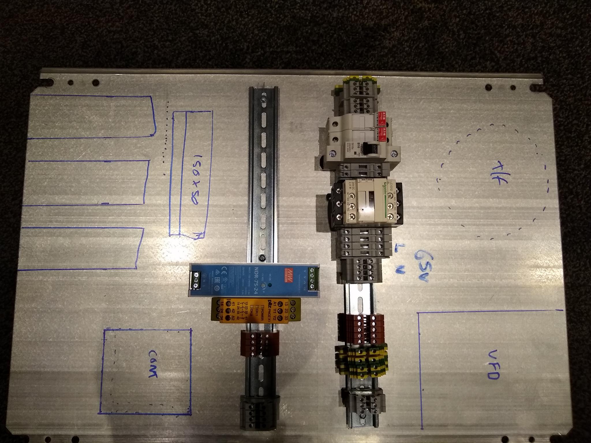

    Looks like good progress.
    As Jazz mentioned you now need to consider trunking and cable runs, at the moment any vertical runs are awkward.
    I'd also consider putting the contactor in the high voltage section.
  2. #42

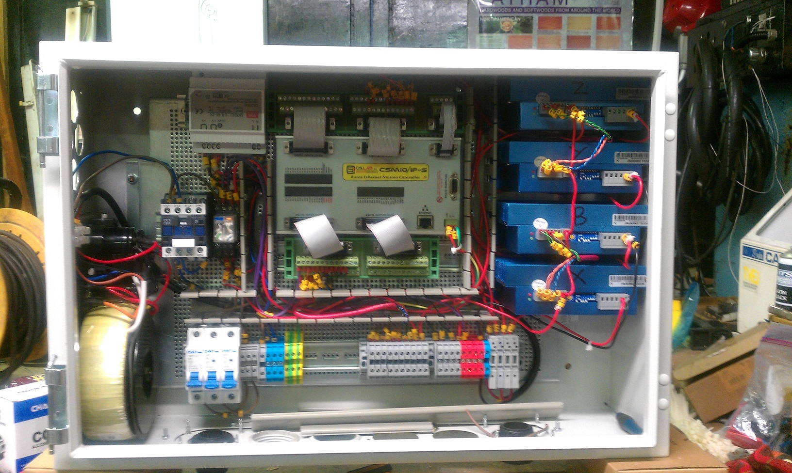

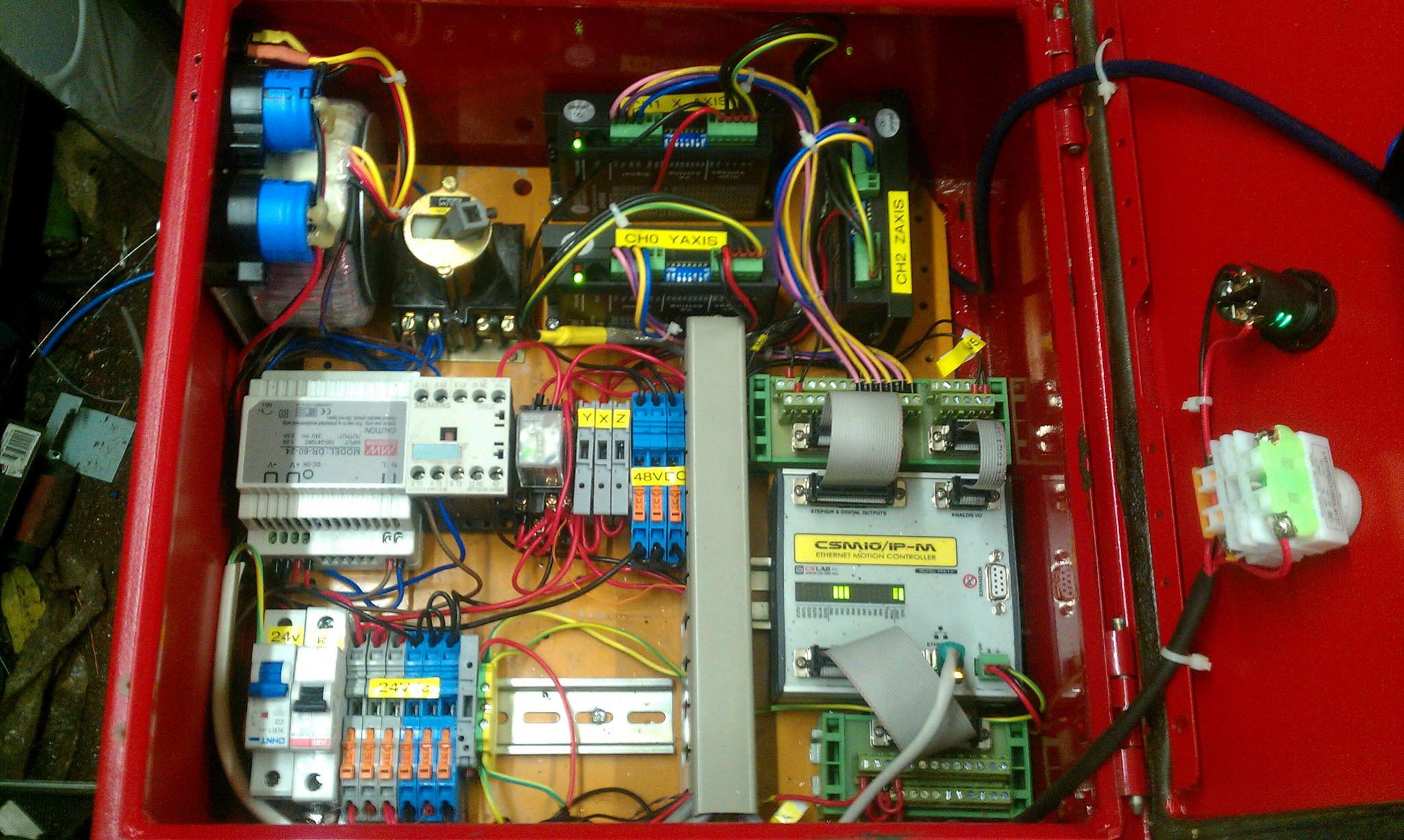

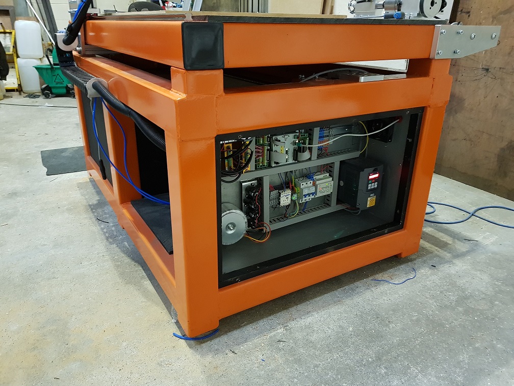

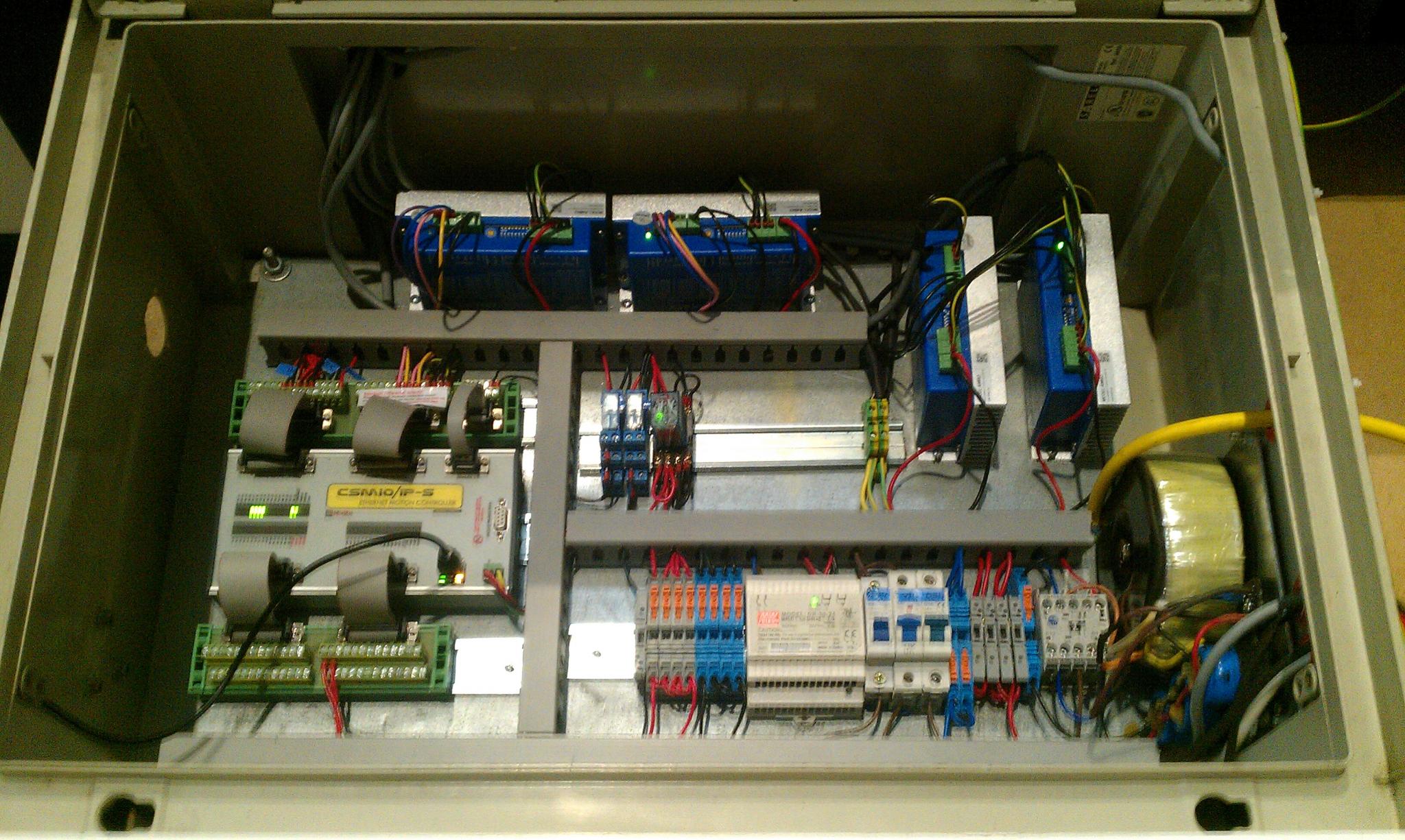

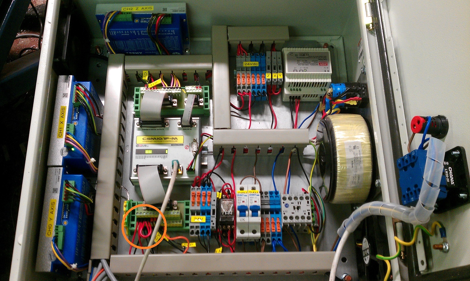

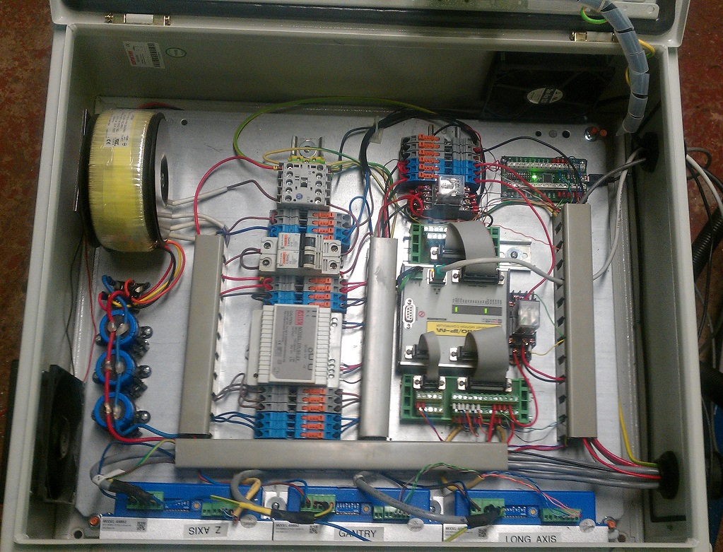

    Here's a couple of pics of boxes which might help give some ideas, These range from tiny 300x300(red) to 800x600 boxes.
    There's no one way which is better than any other so don't stress over it, just be mindful of high and low voltage wire separation along with grounding and you won't have any issues.

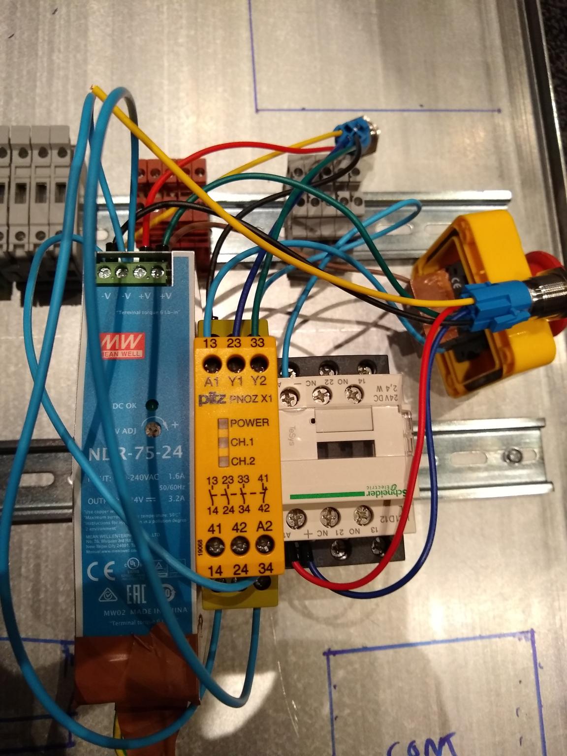

    Thanks, Some useful ideas there Jazz, with everyone staying close to home at the moment, I had some time to get the E-stop working along with fixing DIN rails and mapping out where things will go:)
    After attempting to drill the first 16mm hole in the cabinet with a normal bit I realised what step drills are for and did the rest.. great tool.

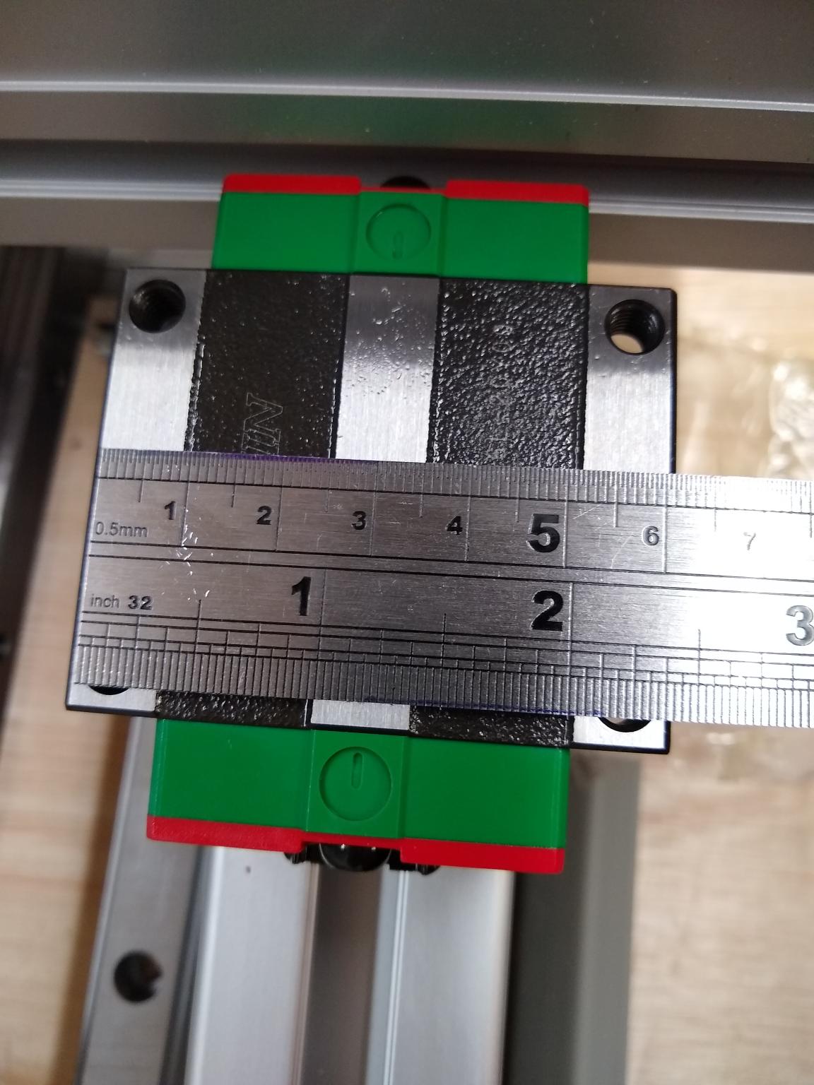

    My linear motion parts are finally here! Happy with the service from Fred at BST - all parts received and in good order. Took a fair few extra weeks but with the worldwide situation at the moment not at all surprising!

    Looks like most aluminium supplies however are shut so maybe time for more electronics..
    So today's question - does anyone know of a coupler for a 10mm end of the ballscrew to a 10mm with 3x16 keyway (on the motor shaft)
    I got a load of "oldham" couplers from BST but they are 7mm/10mm bore with no keyway. Stupid question but does the keyway detach?
    The problem is the hybrid steppers are not standard 7mm shafts!
    Ryan

    So I was about to mount my 750VA Toroidal transformer to the cabinet back board with the supplied fixing bolt, metal plate and large rubber washers
    e.g this kit > https://airlinktransformers.com/imag...photo1_CM5.JPG
    Plan was to drill and tap the metal back plate and secure the bolt into it.
    Then I read this - https://diy.stackexchange.com/questi...-metal-chassis
    From what I understand the bolt itself plus the top mount plate and chassis can form a C shape around the winding and induct a current. People mention fires and things blowing up which I'd like to avoid!
    So now I'm thinking to mount to a phenolic (insulating) sheet so the mounting bolt does not touch the cabinet back plate directly. The transformer also has an earth wire.
    Any issues with this, or better suggestion people use?

    What you MUST NOT do is connect anything to the bolt on the top side that is connected back to the chassis as that would then make a shorted turn. The rubber washers are there to protect the transformer for mechanical damage to the winding.
