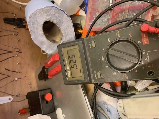

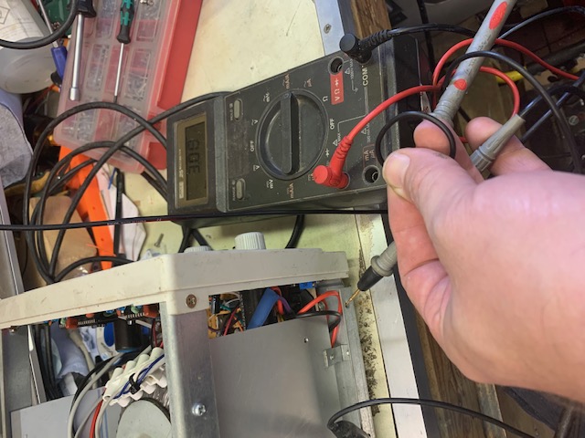

    Following the previous post I'd realised I have a bench PSU with a chunky toroidal transformer that I'd previously hacked to pieces. Sounds like a good experimental platform. Ignore all the crap on the bench - I really need to tidy up.
    Pic 1: General topology, next-to-nowt resistance (0.1R) from the top of the mounting bolt to the chassis.
    Pic 2: Open circuit Vacrms reading from the top-bolt to chassis - about half a volt. A lot more than I'd expected and enough to ignore the fancy stuff with a shunt resistor and 'scope, and go straight for the "blow-the-hell-out-of-the-meter" probe...
    Pic 3: Current short, top bolt through meter and 3 metres of meter leads to ground. Some 3.1A.
    So, yeah, isolate that top bolt!

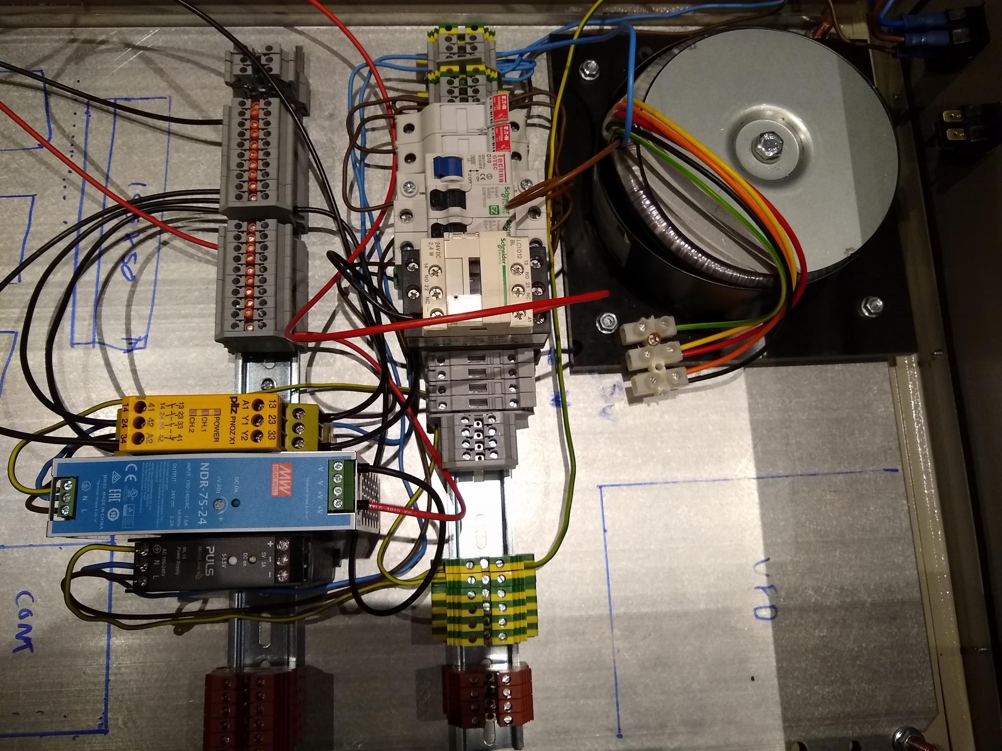

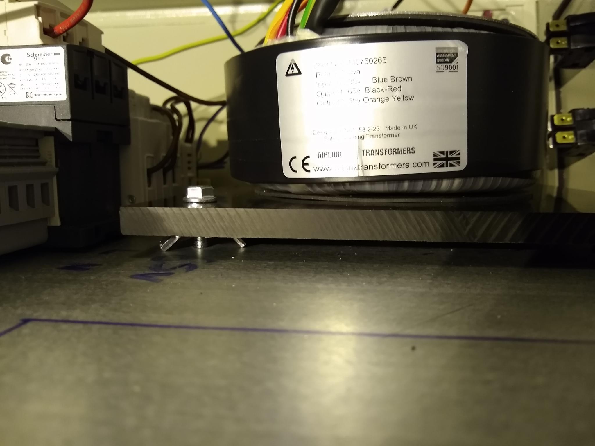

    Quote Originally Posted by CNCRY View Post
    So now I'm thinking to mount to a phenolic (insulating) sheet so the mounting bolt does not touch the cabinet back plate directly. The transformer also has an earth wire.
    Any issues with this, or better suggestion people use?
    I'm going to throw a spanner in the works here and point out that I've built dozens of machines that use the bolt thru chassis method with rubber pads and I've never had any issues with shorts, fires or getting zapped with stray volts/current etc.
    Like Clives mentions it's a Big No No earthing to the bolt but other than that then you won't have any issues provided the transformer sits on the rubber pads.
    So just get on with it and don't worry is what I'm saying. If you want to put a rubber washer on the bolt then why not for what it costs but I wouldn't mess around with Phenolic boards etc.
  5. #54
    Thanks for all the replies - I wasn't expecting a full on experiment Doddy :) Good to have some real results though as everything I found was purely theory, no-one tried it until now!
    So in summary if the bolt is used along with the chassis to form a "loop/partial loop" around the core then there is some serious potential for amps to flow, but its low risk if the bottom of the bolt only contacts the chassis, as Jazz mentions this is commonly done with no apparent issues.
    I happened to have a piece of phenolic offcut so ended up using that on some spacers, plus the bolt itself has a rubber washer between the head and the metal transformer plate. Probably overkill - and I'm sure I'll do something else instead !
    PS before I power up.. Red and Yellow (Vsec from each secondary) and Orange/Black (0V) are connected together - is that all correct for parallel?

    It was an interesting and eye-opening (for me) quick test - I've learnt from it so all is good for me. Don't blame Jazz re. the mounting method - that's how industry does it - single bolt through the grounded chassis. As Clive says the two rubber sheets are a form of mechanical protection to allow you to positively clamp on the transformer windings without deformation of the windings and compromising the insulation coating on those windings. The sequence is chassis (bottom) -> neoprene washer -> toroidal transformer -> neoprene washer -> steel plate -> nut.
    Re. colours - that's a less than useful label on the transformer but I'd interpret it the same as you say - positional reference indicating the phase of the windings. I've had a quick look on Airlink's website and there's no further useful information that I could spot. Your fuse will tell you if it's wrong.
    I've missed the earlier conversation on this but guess you're using AC to power the stepper drivers (no sign of provisioning for rectifier and caps) - I'd think carefully at this time of routing the secondaries in a tidy(!) route away from any low-level signalling, to the drivers - I'm sure you're looking to route to the top of the picture of the box.

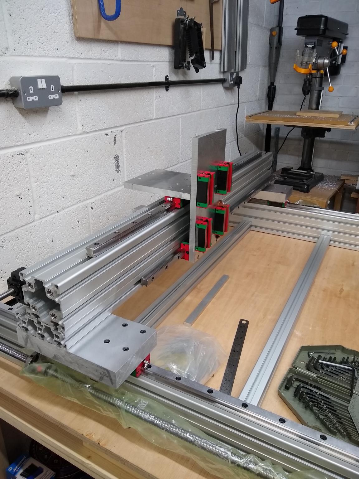

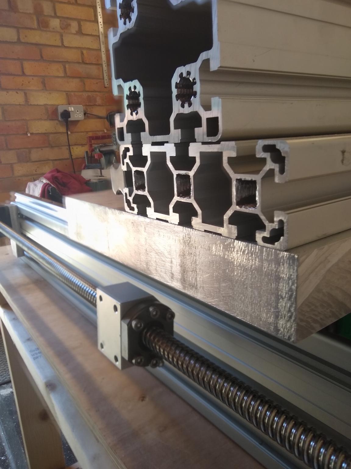

    So the transformer lives, and nothing exploded/shorted etc! I did a quick reading across the output and its 70V, which is higher than the 65V its rated at. Is that normal with no load applied? The drivers are up to 70VAC and don't wan't to fry them..

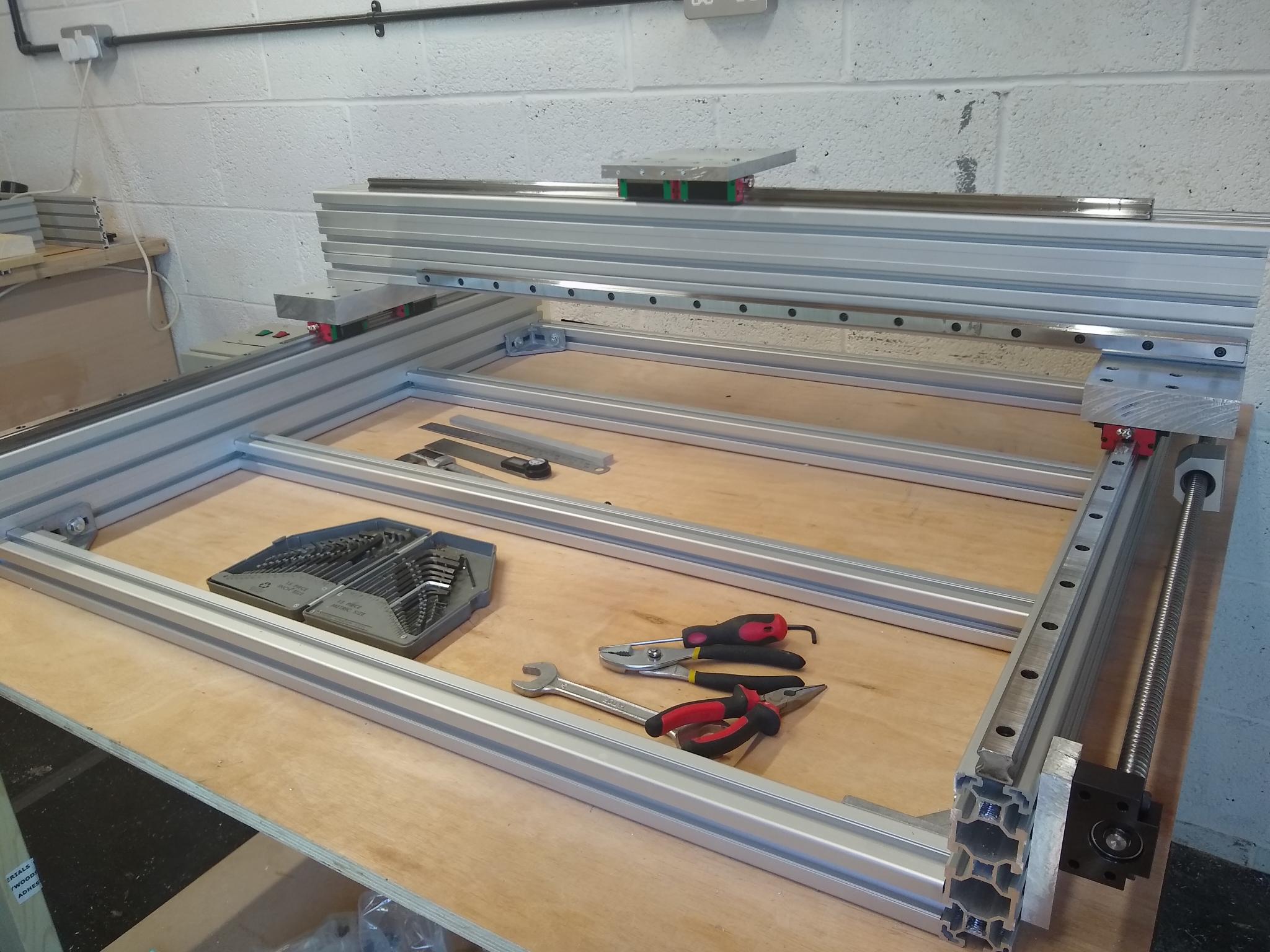

    Made some progress over the long weekend - if only I had a CNC machine this would be so much easier:)
    Reading some of the new threads I've been re-thinking and slightly concerned that the accuracy I'm building too could result in inaccurate final results.
    As this is all "by hand" and printing 1:1 scaling, drill holes are perhaps up to 1mm out, I'm using a digital caliper and angle measuring device during the build, but check as much as possible
    There is some slight adjustment by the hole sizing on everything - how much can the software make up for sub mm "corrections"
    Maybe overthinking it - but also don't want to end up with something not accurate after all the effort.
    As I haven't owned a CNC machine before I don't know what accuracy I'd like, but for example if I could produce something like the Aztec calendar I'd be happy..
    Some photos of current build.

  11. #60
    First off, looks like some great progress in the photos, well done!
    Regards the by hand - quite a few of us have used this method to good results. Yes, sometimes you cock it up, but just be slow and methodical double checking measurements.
    No idea of your experience so lets ensure we hit all bases; make sure to centre punch well (optical if possible - the press type I also like), and let the drill bit align to that punch mark (if you clamp too tightly aligned slightly off, the bit won't happily sit in the punch crater). Use the drill press as much as possible (but check its square to the plate in both directions). If you're not using printouts, use marking dye. Set your digital calipers to the value from a reference surface, lock them off, then use them to scribe the line. When using a steel rule, never use the end for final marking (its a bit variable), always align to markings on both sides (e.g. to measure 10cm I'd align the 1cm mark and the 11cm.) - Now check using the end on the first mark!
    If you come to fit components together and the holes are a bit out, you can always identify troublesome ones and widen only those. An M5 clearance hole already gives you 0.5mm of wiggle room, a 6mm hole isn't going to be the end of the world. Worst case is you have to make it again (oh no!) or remake it using the CNC later.
    Regards accuracy - mostly to do with how you align the linear rails and screws. Use a dial gauge and get everything running smoothly and true to a reference surface. In your case this is mostly on ali extrusion or cast ali plate, so the height of the rail shouldn't be a massive issue - shim slightly if required, and you'll have plenty of left-right wiggle on the extrusion T slot. Your main problem will be aligning the two sides of the long axis so the rails sit at the same height. You won't go too far wrong if things move smoothly. Avoid software corrections as much as possible - the main one is the steps-per-unit, which shouldn't be too far from the calculated value (if it is very different, somethings probably lose).
