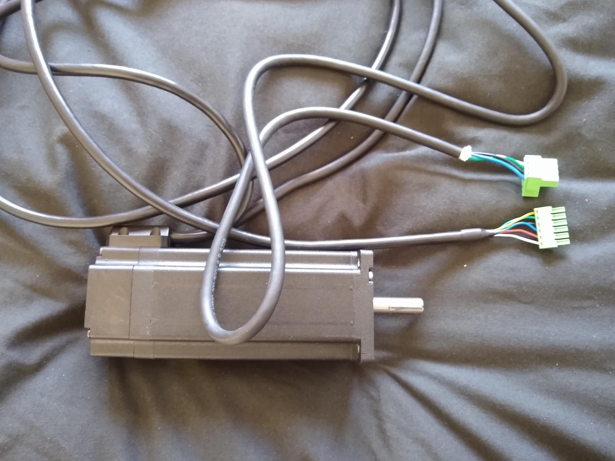

    The good news - I now have 4 closed loop steppers and drivers - The bad news is that means more questions:)
    So the motors come with pre terminated wires - oddly a 2M motor and 3m encoder one. To extend the motor one I assume I just use CY cable ? The existing cable does not seem to be shielded.
    But with most people using CY cable right from motor to cabinet, should I be cutting shorter and using a longer run of CY - or does the closed loop negate the need for shielding?
    Same with the trial prox sensor I have, it's pre cabled with non shielded wire, so do people cut short and join?
    Also before I ask the manufacturer - does it matter on the polarity the AC connections to the driver are - there are no marking or instructions on Phase / Neutral, assuming it won't matter ?

    Quote Originally Posted by CNCRY View Post
    I tend to cut the motor wires short and use shielded cable, but I have used them with the supplied cable and not had any problems. If it was me and you don't have any CY cable then I'd use it as is. You can always change it later if gives you trouble.
    The encoder cable is usually shielded so it won't give you any trouble.
    Cut these short as possible and use shielded cable.
    Ryan
    Doesn't matter it's AC alternating current so it bounces both ways so no polarity.

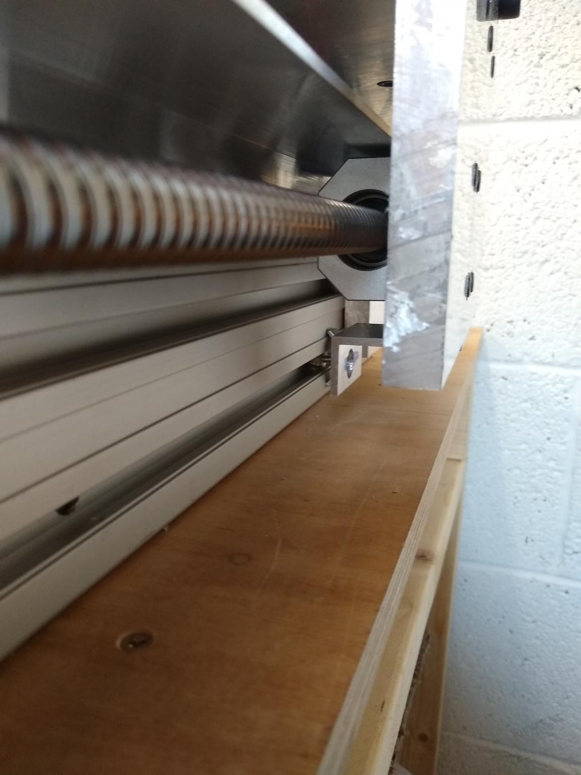

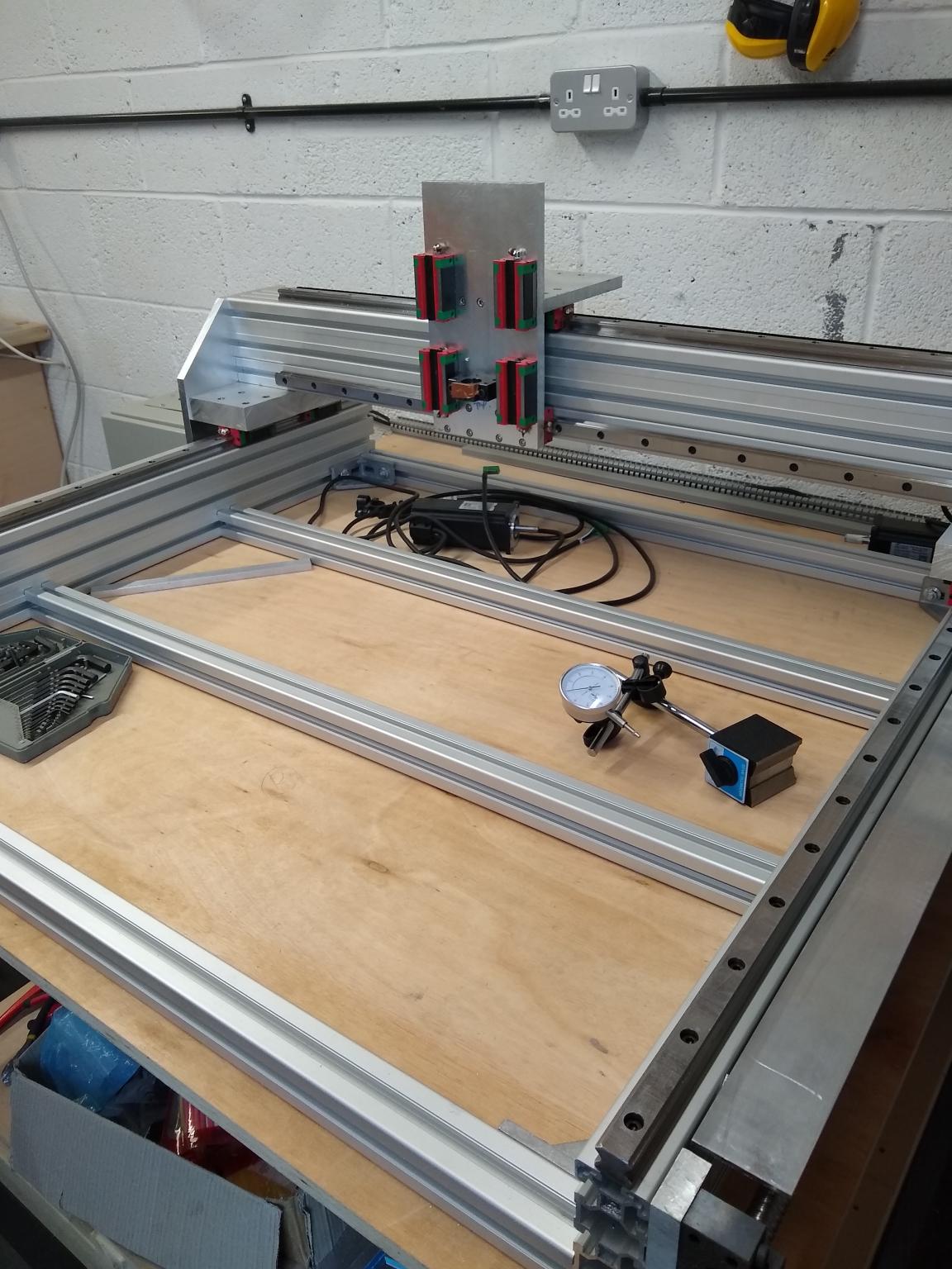

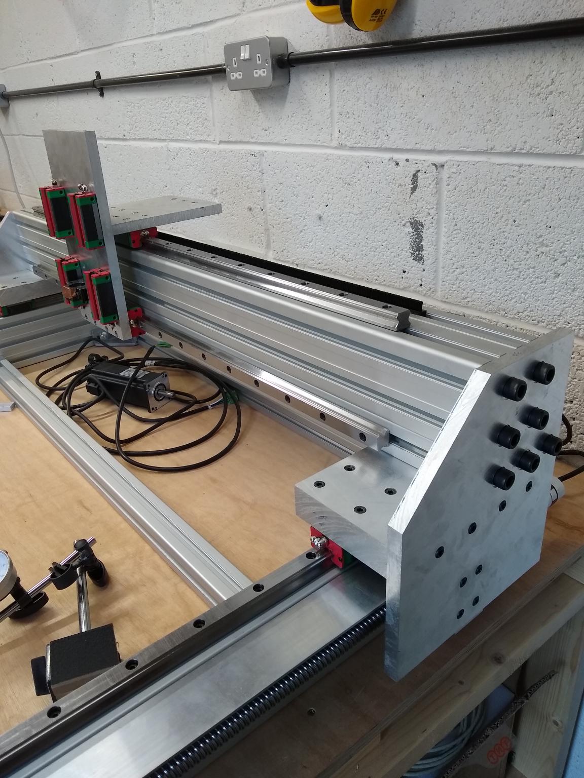

    Some more progress on the physical build - ballscrew covers are on and work as planned! and most of gantry done. Next is to tackle the motor mounts. Plan is to use the long 35mm shaft length to go through the mount without having to hand route out a pocket as others have.
    I also managed to connect 4 steppers and get them moving via UCCNC with nothing going pop, so know electronics for movement in place.

    Reading Jazz's post elsewhere I realise I may have been confusing the X and Y axis all this time.oops. So stranding directly in front of the machine, I was calling left to right movement across the gantry Y and front to back X. So I have configured the dual ballscrew axis as X in UCCNC,
    Reconfigure is just in software so OK, but can someone confirm I have been wrong, and X should be right to left (as per graph axis) and Y is dual axis. Probably good to know for a CNC machine:)
    I'm also worried about the stand/table, When you put a decent force in the middle of the ply it flexes perhaps a couple of mm.
    Initially I just needed somewhere to build it and didn't put lots of thought into the stand, thinking the machine frame will maintain it's structure. It's a wooden bench with ply top, I can do a fair amount to strengthen it up but - is this going to be a major sticking point? I see plenty of "desktop" type commercial machines out there which I assume people just stick on a workbench etc?
    Really don't want to start having to get a frame welded if I can help it ! Ideas?
  6. #76
    Axis labelling can be however you want.
    The convention is:
    Standing in front of machine (as you will actually be using it)
    Left to right is X
    Front to back is Y
    Up and down is Z
    So yes like a graph.
    CAD and CAM software is based on / defaults to this convention, so easiest to follow it.
    Some people get funny and insist that across the gantry must be Y. Or the longest axis must be X. They are wrong. It's about how you draw the design / do the CAM.
  7. #77
    Like Pippin say's there is no wrong or right so long as the Controller and Cam match up. Otherwise it gets very confusing when watching the controller Vs machine movement. However the part will still cut correctly provided it doesn't hit the limits which often happens when people mix Axis and Cam up.
    But to Answer your question then yes you did have it wrong way around to what is conventional, that being following the Cartesian coordinate system of X=Lft/Rht Y=For/Aft Z=Up/down

  10. #80
    Quote Originally Posted by Andrewg View Post
    Not to criticise, but to show I am listening to the grey beards here, and want to copy much you have done:
    I understand the frequent suggestion of having the gantry (X) separate and adjustable from the Y linear bearings for squaring up etc. You clearly still have access to your Y linear bearing screws, so adjustment is still available. However would turning the thick Y linear bearing plate into two, with the lower fixed to the bearings and the upper fixed to the gantry and then bolt and pin them when XY aligned to make things more modular and adjustable?
    I'm going to answer this Andrew because many won't realize the difference and why it's important, well maybe I should say easier rather than more important.! Ryan might not even realize this yet because it's the first machine he's built.
    The Biggest difference is that the 2 plate method doesn't affect the ball screw alignment to adjust the gantry square. However with the single-plate method when you adjust the gantry by loosening the bearing plate you apply a twisting motion on the ball-Nut because the ball-nut mount is attached to the gantry sides which also rotate with the gantry. This puts a bind on the ball-screw so it causes excess wear and lowers the speed.
    This then means you have to make adjustments in some other area to bring the ball-screws perpendicular to the gantry sides and parallel to the rails. In a nutshell it's a right pain in the arse.!! . . . The twin plates take all this away.
