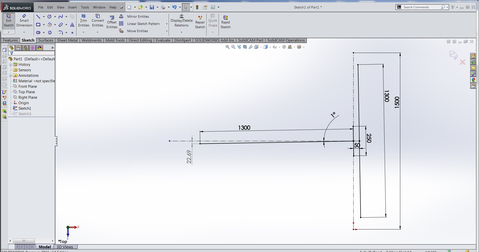

    Edit: I've just done a quick sketch in SW to show how much just 1deg of misalignment translates across the length of a gantry or machine.
    The measurement show the numbers except one and that is the twist of the ballnut in relation to the ball screw but the number is 0.70mm of twist which would wear a ballnut out in no time and cause lots of binding.

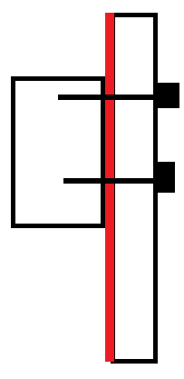

    The rubber part is only on the dual Y (formally known as X :) axis) ballnut. As per below in red. The bolts are still coupled into the ballnut mount, but I can easily replace that with 1mm aluminium shim.
    Dump the rubber it's a bad idea for the reasons stated before. Shimming with aluminium is the better way to do it.

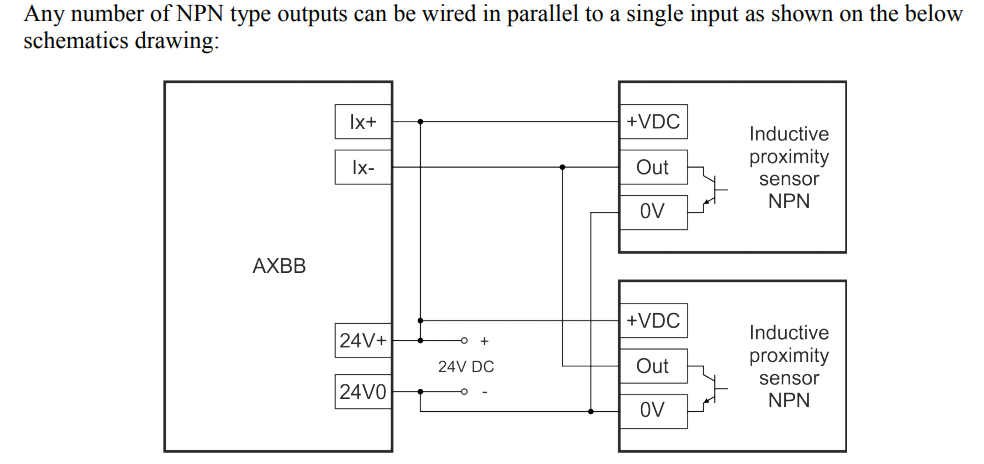

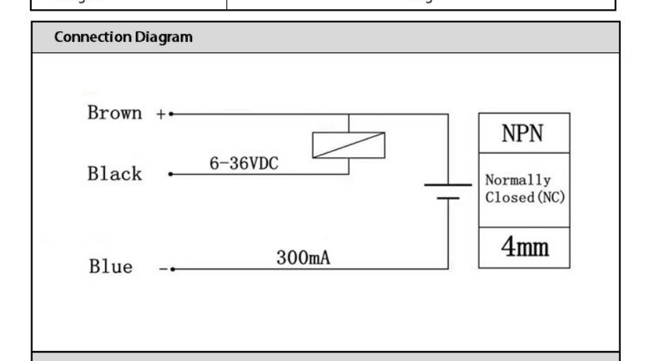

    Can someone tell me is this right? I thought I understood it until I see the black cable on the switch diagram shows 6-36V while "out" on the AXXB manual shows it at 0v?
    AXXB manual image, switch diagram and my understanding of it.

    The black wire is the output of the sensor. It is pulled up to the supply voltage by an internal 10k Ohm resistor until the output transistor conducts and pulls it to near zero volts. 'Normally Open' (NO) means the transistor is not conducting (output pulled high by the resistor) until the sensor is triggered. 'Normally Closed' (NC) means the opposite. Only NO types can be connected in parallel as shown in your diagram, any single output pulled low will pull the others with it and the input to the controller. NC types (which you have according to the diagram) must be connected in series since, if in parallel, all the outputs will be normally low and the ONE that tries to go high will be held low by the others. Unfortunately your AXXB manual image does not explain that but the text should.
    EDIT: Your controller software should include a configuration for selecting whether your sensors are NC or NO. If you get continuous limit alarms then that my need to be changed.
  10. #89
    Ok so they are NC type to cover the issue of broken wires etc.
    So the black wire will normally be at supply voltage until limits are hit.

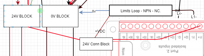

    I'm planning on wiring each to its own limit input on axbbe as there are 6 available, leaving a couple for probes and future use.
    So imagining just one switch in my diagram above , l1+ will always be 24v and l1- would be at 24v normally unless switch triggered.
    Is that right ?
    Thanks !
  11. #90
    Other way round! NC will normally be at ground voltage (Normally Closed to ground) until triggered. "Normal' means you have NOT driven the machine to it's limit and it is continuing to cut material as intended. This gives you protection against broken wires as an open wire shows up as a high voltage if your controller has it's own pull-up resistors and the machine stops. Failure of a NO connection only shows up when the limit switch fails to make the ground connection required and your gantry crashes through both the limit switch and the end wall of your shed.
    My personal preference is for one switch per input as you are planning. NC is best as explained above but NO is more commonly available, presumably because of the ease of parallel connection.
