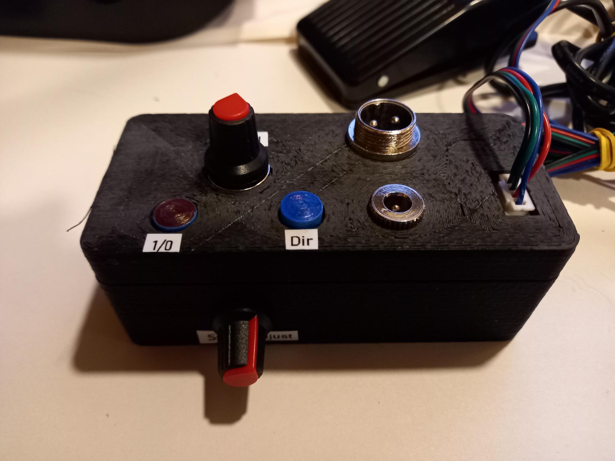

    I have just treated myself to a Stick Welder, Plasma Cutter and TIG combo machine. Then don't-ya-know, I had a bout of illness and I haven't been able to get into the workshop to learn to use it (play with it). So I designed and made a wire feeder. My MIG has a large reel in it, but I also acquired some mini reels of mild steel, stainless and ali. My idea is to feed the wire into the joint instead of using filler rods when TIG-ing.
    Here's some photos of the device.

    The feed mechanism is an old all-metal 3D printer extruder with a larger pinch roller and a stronger spring.
    The pen is mainly an M4 long brass spacer and a MIG tip with a 3D printed housing and a push button.
    The electronics are a Nema17 driver board and an oscillator made to feed the signals to the driver. Controls are On/Off, Direction, 3 speed ranges, and pot for fine adjusting the speed.
    I had to buy the foot pedal from Amazon (£8 for two) and some GX16 2pin connectors for the foot pedals and the pen. The welder has a 2 pin GX16 connection for the torch switch, so I could use one of the foot pedals. Everything else I had already.
    Cheers,
    Rob

    Yes, TIG and stick sources are generally constant current (CC), whereas MIG / MAG is constant voltage (CV). Your plan may work to some extent but I expect you may struggle to maintain a stable arc. MIG / MAG welders are pretty cheap, so you may be better just buying a pukka machine for that. A logical next step for your TIG equipment might be an AC source so that you can weld aluminium.
    I already have a 160A MIG welder with a large spool of wire in it and I have three mini reels of wire but no filler rod apart from brazing rods. There is no electrical connection between the wire coming out of the nozzle, so it is basically just putting metal into the weld, just the same as feeding a rod in. I realise that DC makes ali welding difficult to impossible, but I can't afford an AC TIG welder.
    Yes - I do realise the whole idea may be crap and I am desperate to get back into the workshop to try it.
