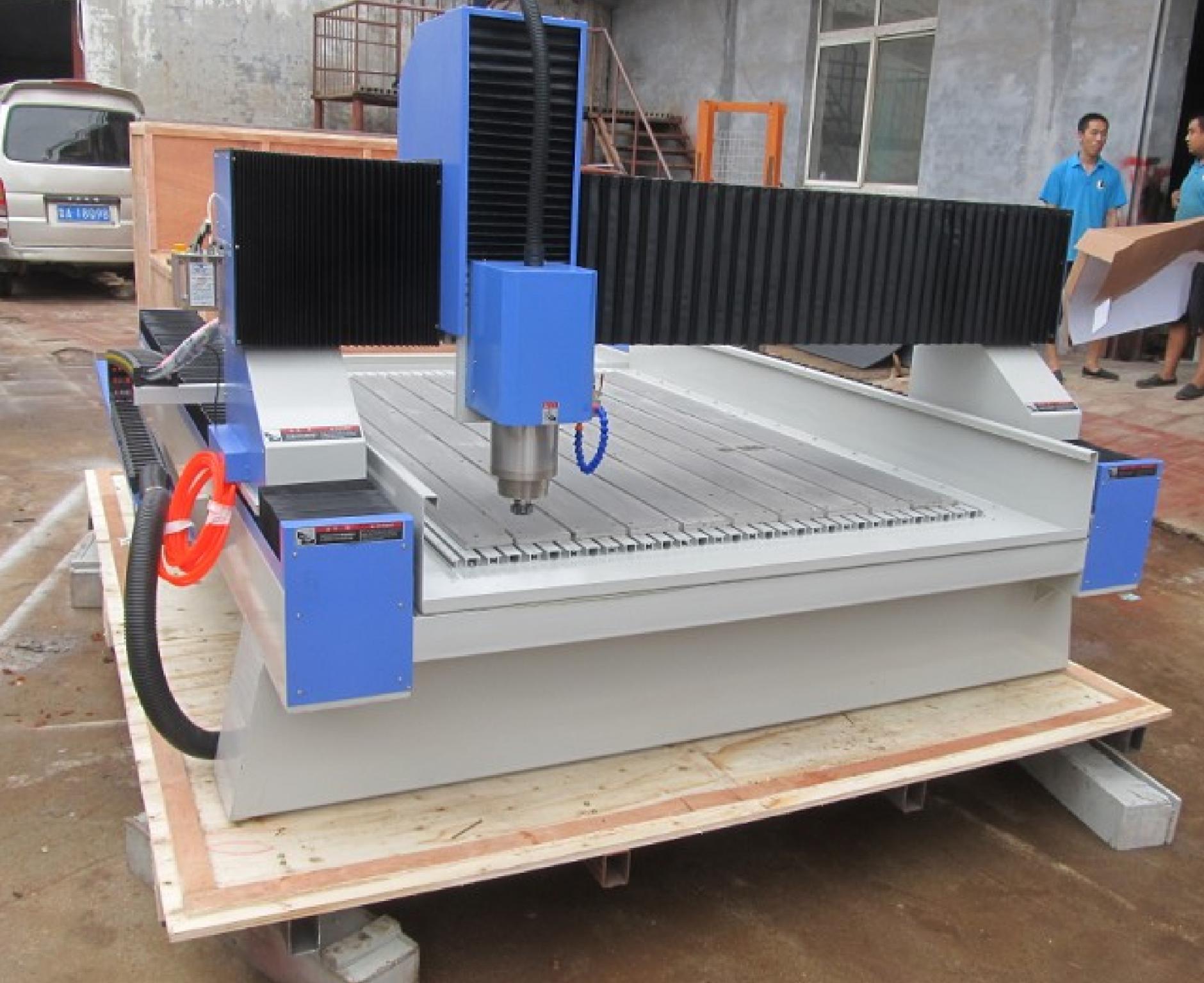

    In answer to your question straight from a user, you would not get a stone cutting machine for £5k, we spent £7500 for the basic machine direct from China plus shipping plus taxes plus delivery from port.
    This was in 2012 the machine is 1.8m x 1.4 bed it has a 5.5kw 24000 rpm water cooled spindle on ER 32 collets, it has never had to be run higher than 16000 rpm, In 2015 we had to change the controller from DSP to Mach3 (down time 2 days), In 2017 I fitted new bearings to spindle (downtime 1 week ordering the bearings 2 days fitting) the machine has been run day and night over weeks at a time, from 2012 to date.

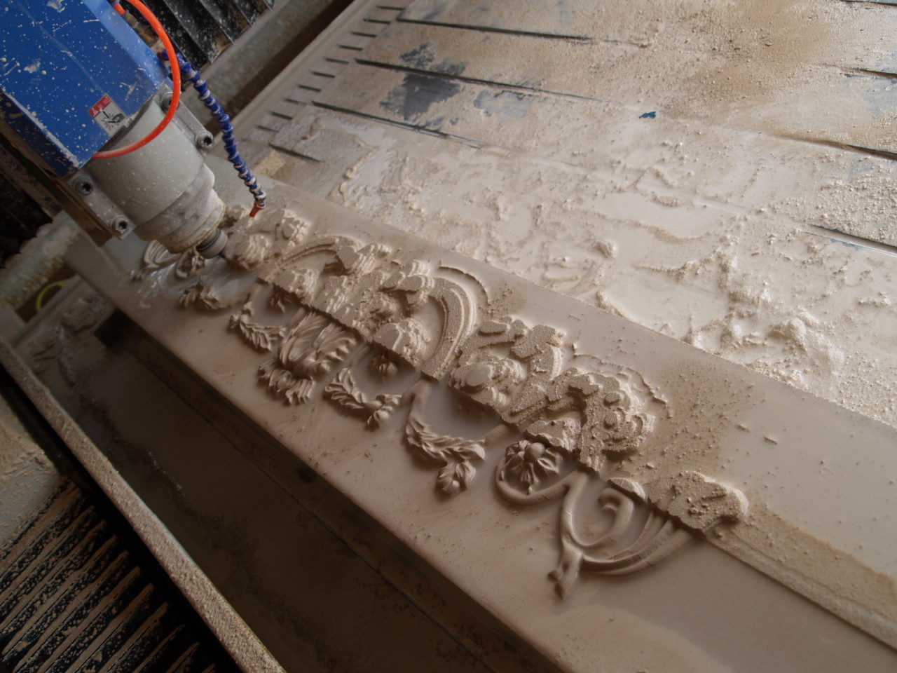

    For the different stone, granite, marble, Stone you can use Diamond tools for edge work, roughing out and levelling, Carbide for profile cuts, cutting text in Granite you use PCD (poly crystal diamond) for marble you use PCD or carbide.
    I grind carbide into shapes to use all the time and they cut really well with plenty of water, we cut 2 1/2D highly detailed reliefs in stone memorials.
    In my opinion don't discount the Chinese machines yes there is problems with controllers but this is something you can overcome by using them to earn some extra to pay for a better system.
    Phill

    PCD on Granite ramp in slow as cutter is very brittle.
    On stone you can increase the feeds depending on detail needed.
    Hi Phill, Just out of curiosity how many bearings where in the nose of the spindle because that looks like a longer than standard nose compared to a routing spindle with ER Taper?
    Also did you buy the machine as a machine for cutting stone etc. or a general-purpose router.? . . What I'm trying to establish is if the Chinese spec'd the spindle for stone or not. The 3Kw spindle we used didn't last much more than 3 months using Flute routers solely cutting Granite, these.!
    https://granitetools.co.uk/product/g...10mm-diameter/
    Have you an idea how much granite work you have done with this spindle, I'm not so much asking about engraving/carving but Fluting and cutting/profiling, etc, I'm curious because I may pursue this type of spindle if it's not a standard routing spindle and you have done plenty of this type of work with it for a sink hole/drainer machine.!

    Hi Jazz,
    Going back a few years you were the first I asked when we had problems with DSP control.
    Shopping list:
    Wet end. 2 off. angular ceramic bearings: outer race..... H7007C.T.P5.UL ESKY *-4* 12E162 41 C.Y.
    inner race... *-3* bearing is 62mm O/D, 34.98mm I/D, 14mm thick.
    Dry end. 2 off. angular ceramic bearings: outer race..... H7205C.T.P5.UL ESKY *-3* GERMANY 42 C.Y.
    cannot find any marks on inner race. bearing is 52 O/D, 24.98mm I/D, 15mm thick all taken with a vernier.
    No idea total of whats gone through all I can say it has done a lot of work over the years extract below from china paperwork:.
    You might be able to find out more on the spindle here:
    JINAN MUNAN IMPORT AND EXPORT CO., LTD
    Address: 3-2-607, NO.101, HUAYUAN ROAD, JINAN, CHINA
    1218 Stone engraving machine ,steel
    structure,1200x1800x250mm,stepper motors and
    drivers,two motors for Y axis,X Y geer-wheel,Z axis
    high precision ball screw,linear square orbit,DSP
    control system,water tank,type3 software,5.5kw
    imported bearing water cooling spindle,two water
    pump(one for spindle cooling,one for tool
    cooling),some tools for stone engraving
    Phill
