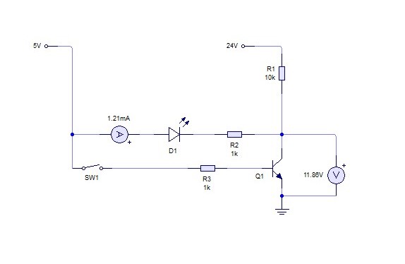

    No - you are right, 15v abs max and 10mA. But I still can't see how the original circuit would work. I would need some resistor values then I could simulate it or even bread board it. Also it would be useful to know the impedance on the 12-24v.
    If the 'switch' is the physical probe then it should be good for 24v I'd have thought. As long as the closed current is limited to the 20mA mentioned before I can't see why it has to limited to 5v. The transistor can be reconfigured to drive the LED from the 24v supply (which is NOT the '24v' connection seen in the drawing by the way. Read post #1 if confused by that)

    The probe is (allegedly) designed to not need lots of current to keep the contacts cleaned/wetted, which is why I'm not concerned about the switching current being too low.
    I'm trying to keep this buffer as simple as possible, with the exception I want LEDs where it plugs in, hence the above circuit.
    By using the 5V to power the LED, it avoids having to swap the resistor values for different controller voltages.

    You're original circuit is absolutely fine bar the low reverse breakdown voltage spec for most LEDs (which may be very conservative in practice). As suggested previously this could be overcome by putting a standard diode such as the ever-popular 1N4148 (reverse breakdown voltage = 100v) in series with the LED. Just spec the resistor for 2 lots of diode volt drop and make sure the transistor can handle the combined current from the switched 24v circuit and the LED.

    I think the point you are missing is that the 24v line in the diagram in post #1 is NOT a supply but is an input to a controller which has a pull-up resistor to 24v. When the probe contacts close, the transistor pulls both the controller input and the LED cathode to ground. When the contacts are open the diode action of the LED prevents the controller input being connected to the 5v supply.

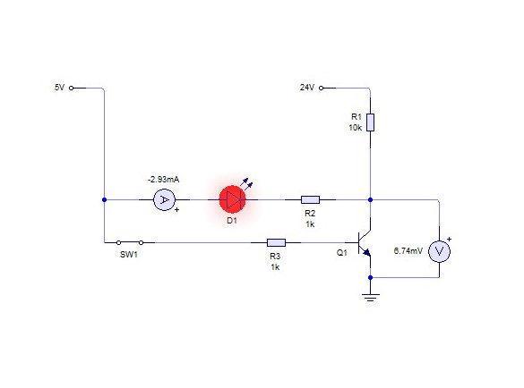

    No Kit, I understood, that is why I was wondering what the impedance was (i.e. the value of the pull up resistor). I would presume it is in excess of 10K to keep the current down.
    I have just done a quick emulation :-

    So it would seem to be OK apart from the reverse voltage on the LED.

    Looking at your diagrams:
    If you're dropping nearly 12v across R1 with SW1 open there is something seriously wrong! The collector of Q1 should be at the full 24v. On reflection there should be a pull-down resistor (10k would do) on the base of Q1 to hold it to 0v when the contacts are open, otherwise the base is left floating which should never be allowed to happen. I suspect your emulation software has picked up on that fault and is allowing Q1 to partially conduct.
