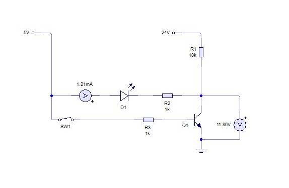

    Why not 5V through the resistor through the switch to ground?
    The switch carries 5V minus the voltage drop across the LED.
    Or less another 0.8V drop across the transistor if kept.

    If the 'switch' is the physical probe then it should be good for 24v I'd have thought. As long as the closed current is limited to the 20mA mentioned before I can't see why it has to limited to 5v. The transistor can be reconfigured to drive the LED from the 24v supply (which is NOT the '24v' connection seen in the drawing by the way. Read post #1 if confused by that)

    You're original circuit is absolutely fine bar the low reverse breakdown voltage spec for most LEDs (which may be very conservative in practice). As suggested previously this could be overcome by putting a standard diode such as the ever-popular 1N4148 (reverse breakdown voltage = 100v) in series with the LED. Just spec the resistor for 2 lots of diode volt drop and make sure the transistor can handle the combined current from the switched 24v circuit and the LED.
    Rob,
    I think the point you are missing is that the 24v line in the diagram in post #1 is NOT a supply but is an input to a controller which has a pull-up resistor to 24v. When the probe contacts close, the transistor pulls both the controller input and the LED cathode to ground. When the contacts are open the diode action of the LED prevents the controller input being connected to the 5v supply.

    No Kit, I understood, that is why I was wondering what the impedance was (i.e. the value of the pull up resistor). I would presume it is in excess of 10K to keep the current down.
    I have just done a quick emulation :-

    So it would seem to be OK apart from the reverse voltage on the LED.

    Looking at your diagrams:
    If you're dropping nearly 12v across R1 with SW1 open there is something seriously wrong! The collector of Q1 should be at the full 24v. On reflection there should be a pull-down resistor (10k would do) on the base of Q1 to hold it to 0v when the contacts are open, otherwise the base is left floating which should never be allowed to happen. I suspect your emulation software has picked up on that fault and is allowing Q1 to partially conduct.
