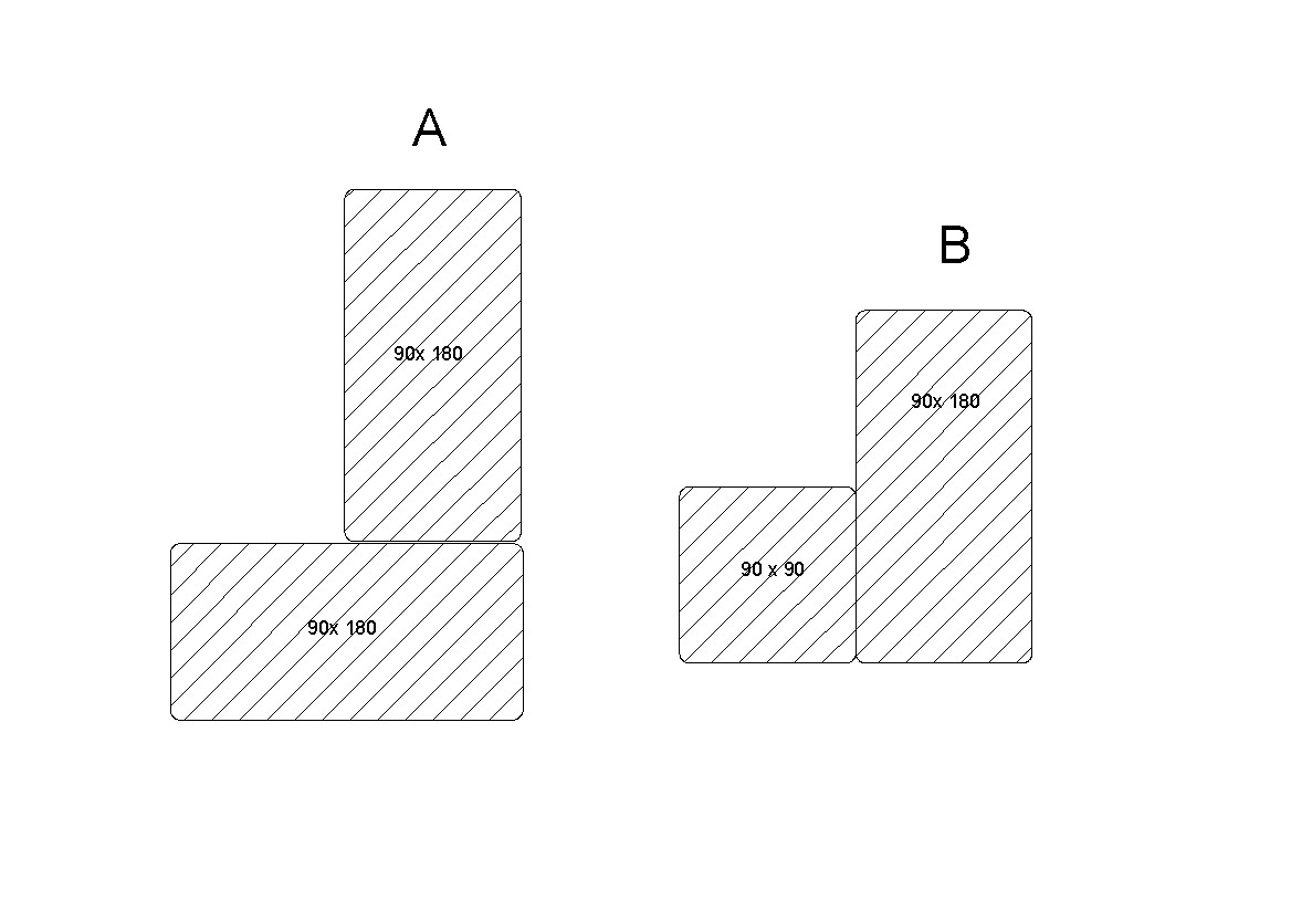

    Have sent emails to UK and China enquiring about 45 series extrusion...no good leads yet.
    In the mean time, it seems that some supplies do not offer an intemediate size, ie 90 x 135mm.
    This means I have to use a different sizes for the Gantry.
    I was wondering if there is a difference in the stiffness of a Gantry between these 2 options?
    Steve
Name:	L Gantry Choices.jpg
    Option B is my preference, if joining on the back is acceptable to do.
  6. #36
    I'd have said option A will lead to a stiffer machine, simply because you've increased the mounting distance between your rails? What does the gantry deflection calculator tell you?
    Haven't looked at that . Will have a look now.

    What size machine you building because 90 x180 profile arranged in L shape will make for a BIG gantry. To give an example I've just built a 10 x 5 machine with 2mtr wide gantry and it's only using 80 x 160.
    Also, The point of the L shaped gantry is to have the bottom profile laid flat which is the stiffest direction for the cutting forces.
  9. #39
    Its basically a 6040 sized bed but the frame will be larger so the tool will reach the whole bed area ( at this stage. )
    Re: 90 x 180, yes I agree it will be huge. Most suppliers don't seem to offer anything between 90 x 90 and 90 x 180.
    I have seen 90 x 135 ( and that is my preference ) but that seems uncommon.
    Just got a quote back from Parts-On in the UK. 800 pd total. 350 pd of that is postage. doh......Works out to $1500 AUS.
    Might have to conceed defeat and use 80 x 80, etc......
    Not that keen yet.....
