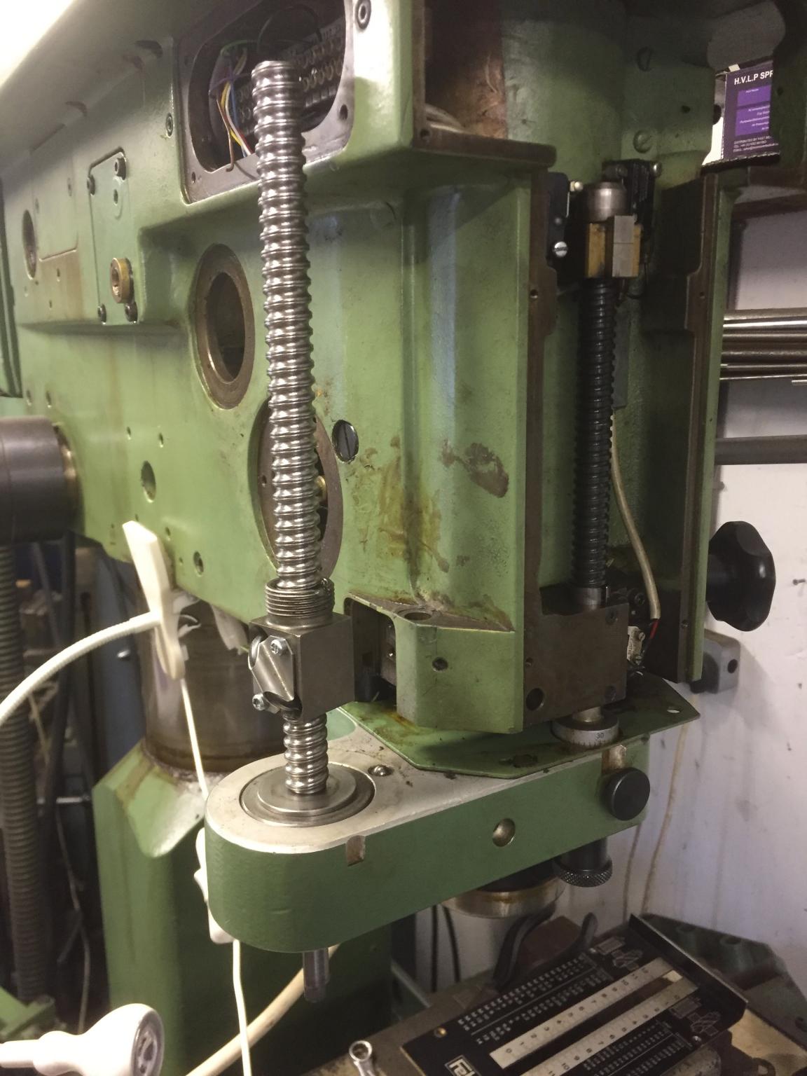

    I'm looking for a source for a low-backlash ball screw for the quill of my Fehlmann mill-drill (see my previous thread on this machine).
    The machine was previously set up with a very nicely constructed worm and wheel drive to the quill rack and pinion, but backlash in the worm and wheel (not the rack and pinion) has led me to consider using a ball screw instead. The photo shows an old actuator ball screw that I've set up to prove the principle.

    While positional accuracy over the 120mm of travel is not important backlash is. A dual nut would make sense and would probably be OK since I can accomodate a maximum thread length of 250mm. I've looked through eBay and am unable to find double-nut screws and am unable to seperate the wheat from the chaff in respect of other screws. Some guidance would be appreciated.

    In terms of ebay I found this seller to be about the best when it comes to C7 double nut (DFU) screws. Bought around a year ago for conversion of an AMAT25LV benchtop mill.
    I got my screws down to around 0.015mm backlash using some thin tin foil (approx 0.05mm thickness in total) to pack between the slave nut and spacer.
    Or you could spend fortunes on C5 or lower using DFU nut in your searches.

    These are the ones on my machine:
    https://www.ebay.co.uk/itm/2-set-DFU...72.m2749.l2649
    Don't use thrust bearings with the Chinese screws. More hassle than it's worth. Design the machine to fit angular contact bearings, I've used some Dunlop on my AMAT25 which were relatively cheap and some unbranded which seem fine too.
    I had thrust bearings on my Sieg X2 and it wasn't very good. They cause your screw to run bendy as they don't seat on the ends well.

    The picture shows them with no spacers but all mine came properly done.
    I ordered spare sets for the AMAT and some for rebuilding my Sieg.
