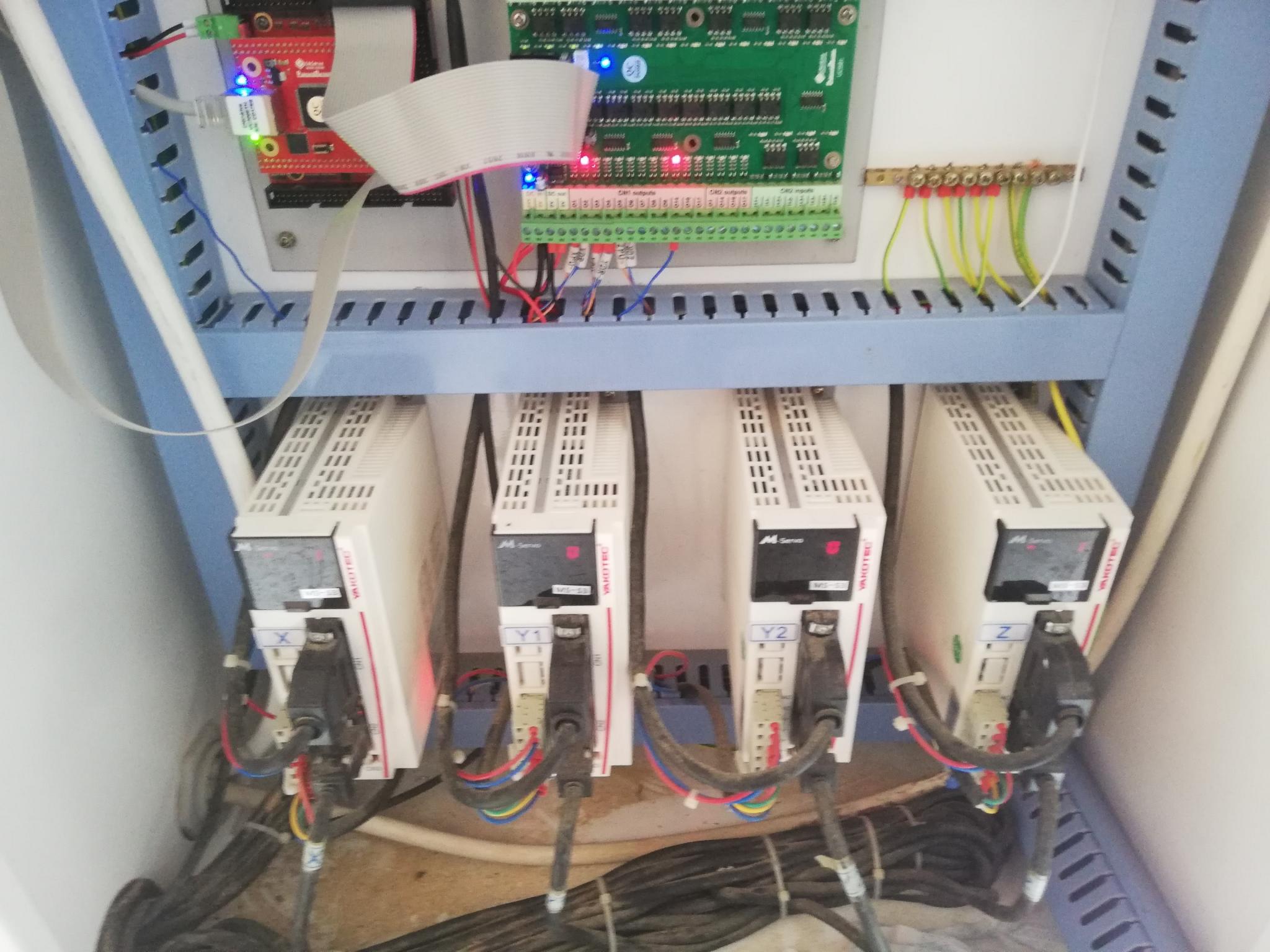

  8. #28
    i have 3phase supply in the workshop so the power wont be an issue , i currently have a 4.5kw non atc spindle in the router, i have contacted them about the spindle weight ,i will contact them about the vfd. i am running uccnc with the uc300eth-5lpt and the ucbb breakout board.
ID:	29777   Click image for larger version.

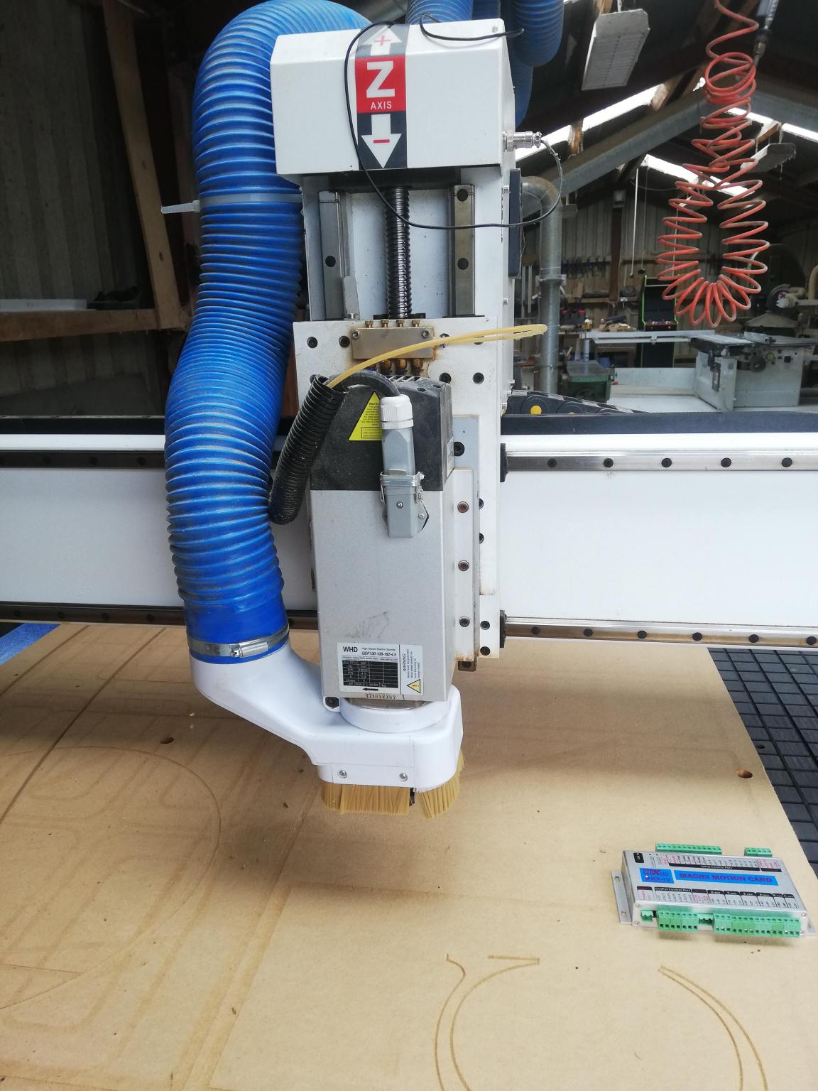

  9. #29
    it,s been a while but i finally got around to purchasing an atc spindle and vfd " chinese" ,the spindle is a hqd 6kw with ceramic bearings , and a fuling vfd. both 380v,, it will be a month before i start the upgrade due to needing the router for jobs i have to do before christmas,,,,what size of compressor is recomended , i have an old 300 litre but its getting noisy and not running so good ,also what else on the spindle side is required ,,,water sperator for the air ,solenoids what kind is best ? what other equipment needed to get it up and running..
Name:	atc spindle.jpg
ID:	30651   Click image for larger version.
ID:	30652   Click image for larger version.
  10. #30
    after 2 years of sitting in a box i finally mounted the 6kw hqd atc spindle which i have connected to the vfd and is running smooth , at present i plan to use the manual toolchange button until i get my head around the auto toolchange and macro side of things.. i am using the uc300eth-5lpt with the ucbb with uccnc , i understand how to get the solenoid working with the button , my question is does this have to be connected through the breakout board ? and is there safety measures i need to put in place in case of a tool ejection when the spindle is in use , any advice would be much appreciated. thanks
