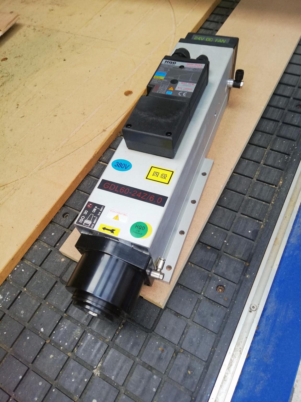

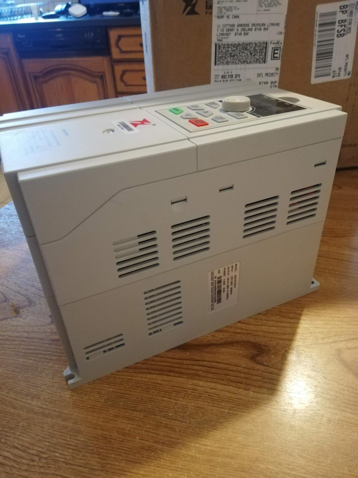

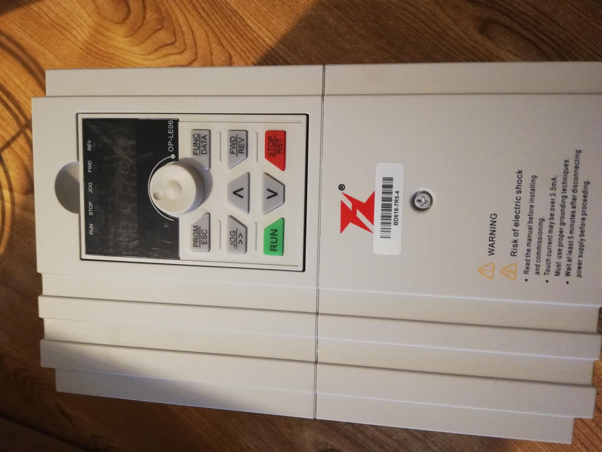

    it,s been a while but i finally got around to purchasing an atc spindle and vfd " chinese" ,the spindle is a hqd 6kw with ceramic bearings , and a fuling vfd. both 380v,, it will be a month before i start the upgrade due to needing the router for jobs i have to do before christmas,,,,what size of compressor is recomended , i have an old 300 litre but its getting noisy and not running so good ,also what else on the spindle side is required ,,,water sperator for the air ,solenoids what kind is best ? what other equipment needed to get it up and running..
Name:	atc spindle.jpg
