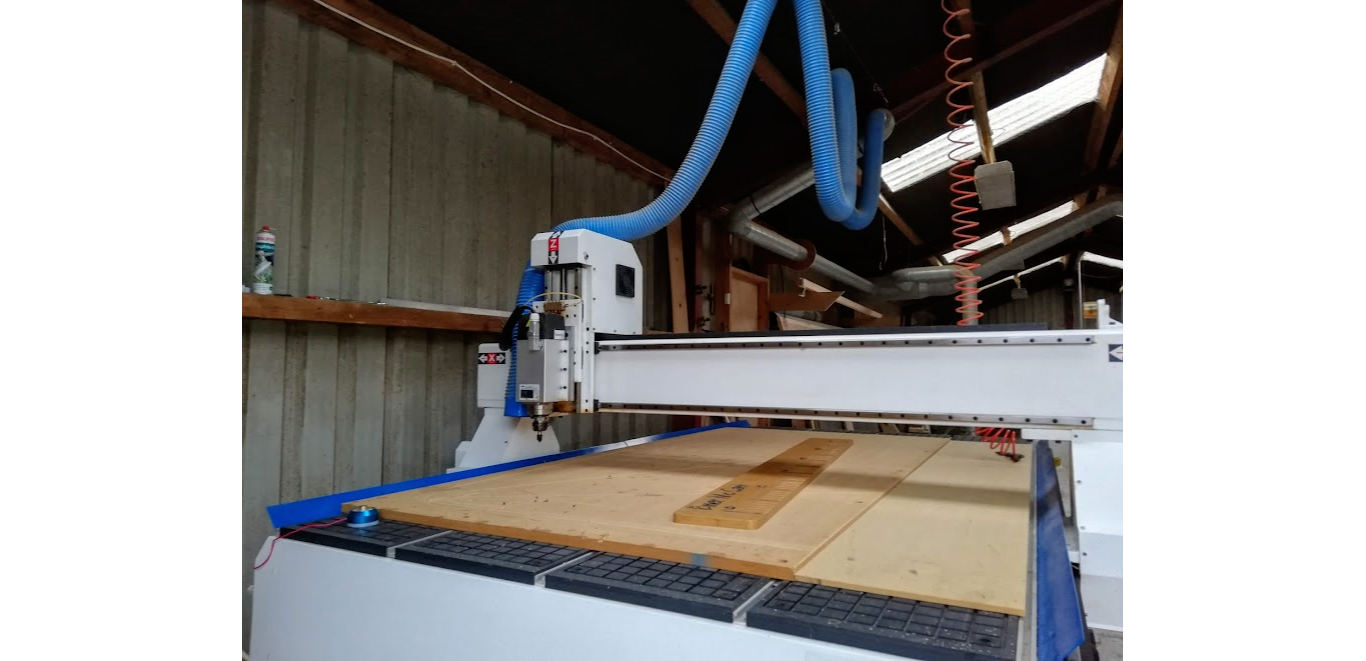

    i have a 10*5 chinese machine with a 4.5kw spindle,,,running mach3,,,,,the machine works great with the only issues being user error,,,,,i want to upgrade to atc ,,the constant changing and zeroing of cutters is getting to be a pain.....ive added an image of my machine,,,,,,im not sure of the weight of my current spindle or if the gantry would be suitable for the atc spindle,,,,im also thinking of upgrading the chinese controller to the axxb-e running uccnc. any advice would be much appreciated.

    Well, wouldn't worry about the gantry not being suitable because it's more than strong enough. However, because the rails don't go all the way to the ends then you would have to use a wine rack type tool holder on the end or down the side of the machine rather than a carousel type off the side. That said Wine rack type is much simpler and easier to deal with regards setting up the tool change macro.
    The only issue you may face is if the weight of the spindle is too much for the X-axis motor when in use or when parked the Z axis dropping. May require a larger motor or break on the motor if it does.
    Regards the AXXB-E then it's limited on the amount of I/O it provides so you'll need to work out exactly how much I/O you need for the whole machine first. If you have Limits and Homes etc then probably won't have enough Inputs and will be very close with the outputs if you let the machine control vacuum or air blower.
