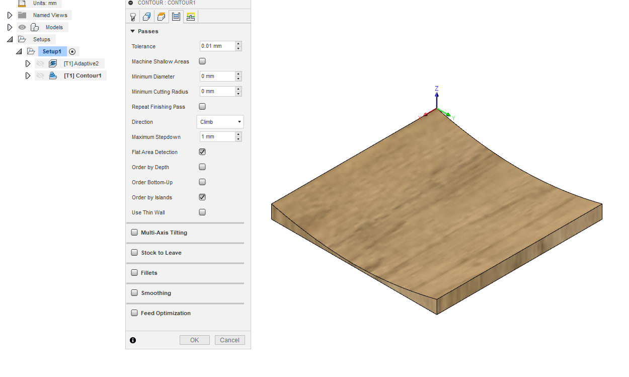

    Hi, I finally dug my machine out and got it running, have a DDCSV 2.1 on the machine now
    What's going wrong?
    Mechanical or software?
    It's meant to look like this

    I cut it once, let the cut finish. Turned the power off and on again to machine and then repeated the same cut again next to it to see if I was losing steps.
Name:	Test piece cnc.png
    2 cuts look identical to me.
    I used Fusion 360 to generate the Gcode.
    I have AM882's which have fault protection and if you drive them too fast they do fault but running the cut very slow 1m/min not getting any faults
    Adaptive clearing and contour for finishing pass.

    What cutter are you using and what is the stepover?

    This is the cutter I set it up as a 6mm D 25mm cut length, 2 flute end mill in Fusion
    Run speed full speed, not set up speed control I only intend to do wood and maybe a one off make myself new aluminum plates if I make ever another machine.

    That's a roughing operation. You've set it to leave 0.5mm so you can come back with a finish pass using a ball nose bit or something else.

    I also have a contour operation nextClick image for larger version.

    OK, it looks as though you are getting steps because the stepover (not stepdown) is too big for a flat bottomed end mill. Try a round nose cutter with a final pass stepover of 10% or less. I don't use Fusion so I don't know the setup parameter screens.
    It looks a bit like you are not getting past the roughing cuts.
