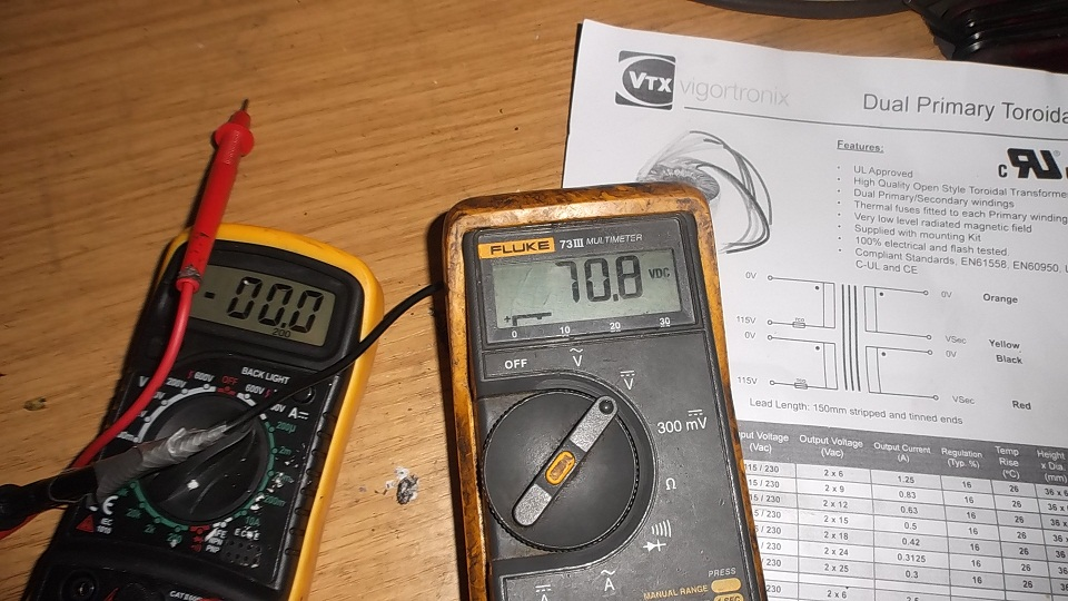

    I built a 70v PSU which means if I change my drivers they would have to be in that range or I need a new transformer.
    I think mine is 1kva so I think I could run pretty much anything in the Nema23 profile on all 3 axis (4 motors) without blinking.

    I should just link the Clive S build it's how I built mine, 2 years ago bad memory.
    Whatever I did I did it right I just copied Clive S's build, 3 capacitors to smooth the DC.
    This is what it tests out at without load
Name:	PSU voltage.png
