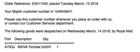

    For reference, I also bought a toroidal tx from Maplin on closure...
Name:	Screenshot 2020-02-29 at 08.06.50.png
    That pokes out 72V off-load, rectified and smoothed, measured with cheap Chinese current/voltage DMM panel meters. Two secondaries driving two separate circuits - but this should give the same voltage as two secondaries in parallel (not series). The maths for mine = 50VAC * SQRT(2) - 2 * Vf(rect) = 69V - within about 5% of measured - I'm happy with that.
