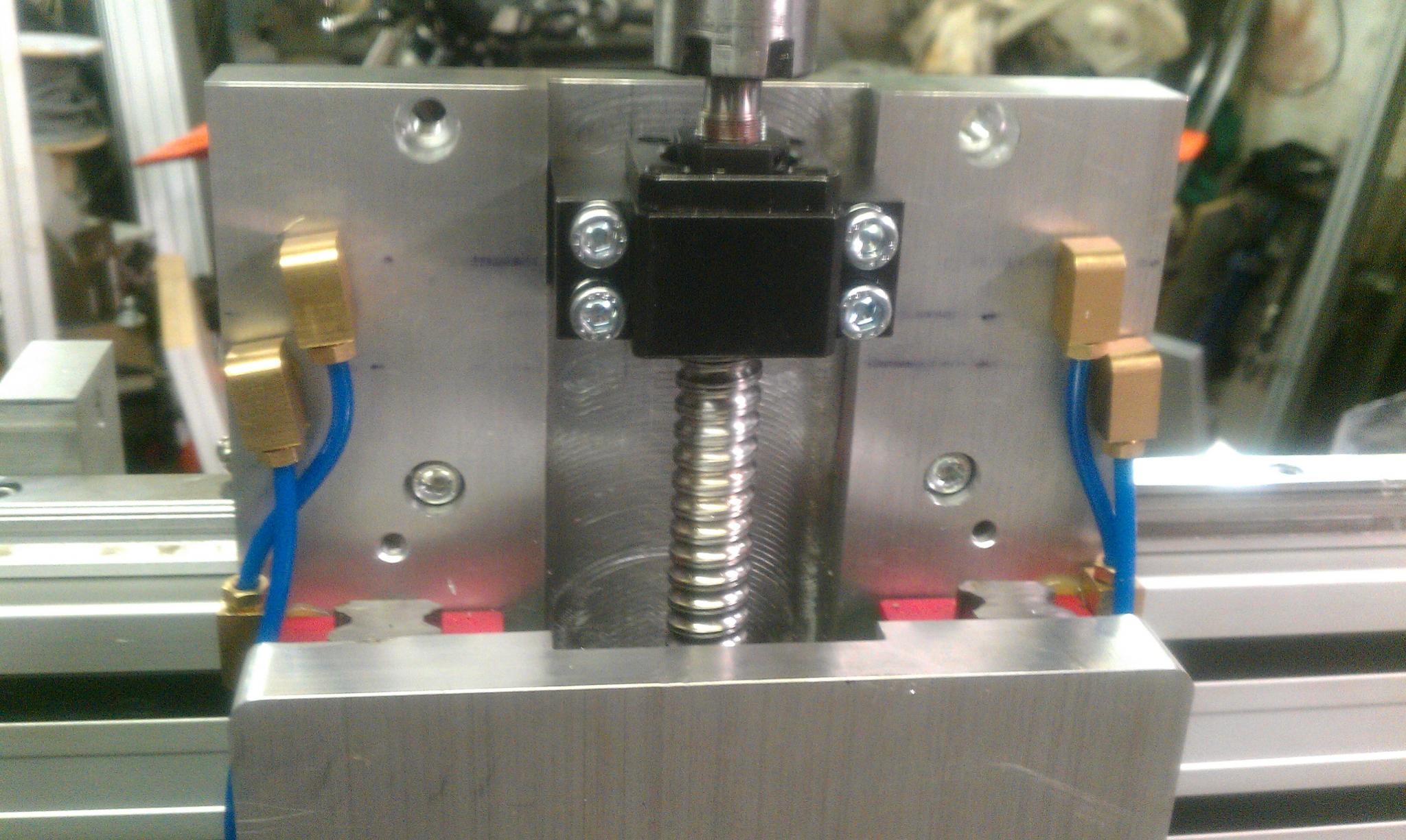

    Whereas the rails on rear plate mean that the spindle can be lifted high up the rear plate so the tool clears the bottom of the gantry giving the full height from bed to underside of gantry even with a long tool. This means you can make your gantry lower and still have the same material clearance as the other method but it makes a much stiffer machine and better cutting so eliminates any advantage the rails on front plate offers.
    Does having rails on the rear plate also mean that you can have a smaller plate on which the spindle mounts? Thereby saving on material costs?

    Hi Joe,
    Thanks for asking many of the questions I need answers to as well!. I am currently trying to start my own design from the Z axis out. You would think this would be the simplest axis with least design options, but still the choices come. I had also picked up the tit-bit about rails on Z plate for stiffness, so grateful that Jazz has spelled out the trade offs.
    It seems to come down to how to sandwich rails/bearings and ballscrew/ballnut between two plates neatly and compactly.
    A 16mmm ballscrew nut and holder is 40mm high, so that is the minimum distance between plates,
    However BK12 are 25mm from base to ballscrew centre, and ballscrew holder is 20mm, So using these simple components, plates must be 45mm+ apart
    If you are going to have to pack up rails or bearings to span this gap, then 20mm rails are far from too big, as at 30mm combined height, you will need a 15+mm space. FK bearings and clever design might make it possible to pack things a little tighter, but I am still looking around for a reference design that solves all this with minimal parts and machining.
    Good luck with your design
  5. The Following User Says Thank You to Andrewg For This Useful Post:
  6. #14
    My approach to this problem was to use 20mm rails, and 20mm Ecocast plate. This gave enough depth of material to be able to pocket the plates for clearance around the nut holder. The important point here is that the pocketing is for clearance and is not super-critical in terms of dimension. This means that you can use a woodworking router to do the job. I actually used my vertical mill, but if you search the forum for (from memory) Joeharris's posts he talks about how he used a conventional handheld router successfully to machine aluminium. Might be worth a look and a few back-of-emvelope sketches. I know that I spent a long time on the details in this area; apart from anything else you have to be able to assemble the Z axis and I ended up doing things like drilling access holes in the moving plate to be able to get to a few allen bolts going into the fixed plate. All good fun!
  7. #15
    This is the easist and best way to build a Z axis. Packing rails off or bearings off is a fiddly bodge. 15mm rails while more than strong enough are fiddly things and make it awkward.
    You could go with 25mm rails and get away with no machining but then it gets tight with space and really requires a wider Z axis, plus there's more mass to deal with.
    Hand machining isn't difficult provided your comfortable using a large router. I did several of the parts for my first machine this way and was the one who talked Joe into giving it a go, however Joe cut far more parts than I did using this method and made a very nice job of it so I'd advise anyone thinking to do this to go check out how he did it.!
  8. #16
    Yes, as you say Joe Harris's videos show simple routing of Aluminum is doable if high precision not required. However looks from video that he actually used 15mm+ spacers under his Z bearings and flat plates.
    Neale, presumably you have to recess one plate for the ballnut holder, and the other for the BK/BK bearings....or go another way? What am I missing?
  9. #17
    Quote Originally Posted by Andrewg View Post
    Just because Joe did it that way doesn't mean it's a good way. He did it because it was the easiest way, I'm telling you the other way is better from experience. Those building have to make there own minds up which to route to take based on there own abilty's and equipment just like Joe did.!
    This might help with the confusion.

  11. #18
    As per Jazz's picture, you need a recess in both halves. As I remember (and I can't find a drawing of it to hand) the recess was wider somewhere around the middle of the plate to give space for the ballnut mounting bracket. As ever, make sure that your design allows adjustment to align the ballscrew and nut in two dimensions - well, I needed to as my machining ain't that accurate...
  12. The Following User Says Thank You to Neale For This Useful Post:
  13. #19
    Andrewg - I went through this same thinking, and am in the process of building it now. I'm using the spacer method, it's requiring 15mm spacers with the 20mm hiwin rails to get enough clearance with no pocketing. My thinking is that if I can get the CNC up and running I can then pocket out a new piece if needed, as I'm more likely to mess up the plate routing by hand (and no access to mill anytime soon). I'm offsetting the overhang by using 15mm thick tooling plate instead of 20mm. So saving 10mm but spacing 15mm.
    Mine is untested so far though! - so I'd go with Jazz's and others advice any day if you are happy to pocket them.
