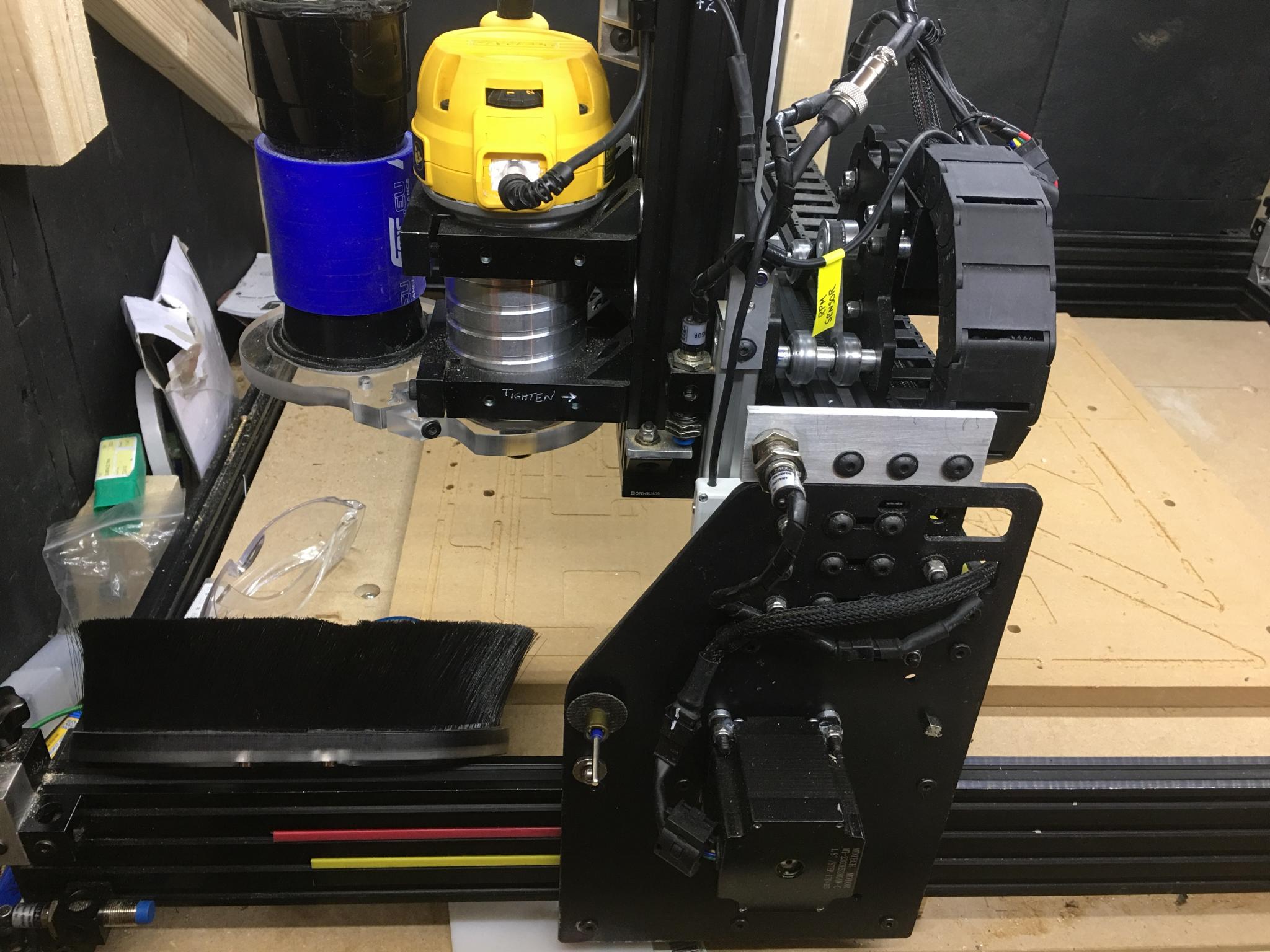

    My current build has the X and Y driven by double belts (el cheapo rack and pinion method) with the Z axis running a C-beam linear actuator. I have full limit switches, the Dewalt 611 (26200 here in the UK) speed and power is controlled by a SuperPID and the vacuum power is controlled by the coolant switch (as I don’t use flood coolant).

    That's a closeup showing the gantry. It’s 80 x 40. The side rails are 80 x 20. I altered the stock z axis because it sucked. The replacement is similar to what is used on the Workbee.
    I’ve already ordered a water cooled spindle and VFD to test. I’m probably going to replace the gantry before fitting the new spindle though. Might see if I can make the plates for the new machine with my old machine.
    What advice I do need is to do with what linear rails and ballscrews to go with.
