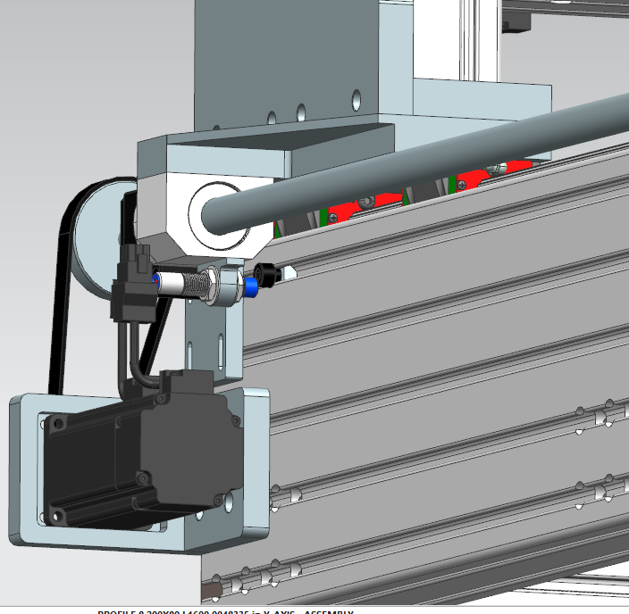

  2. #112
    So machine design is now what I consider 99% completed so that I can start ordering parts. Since none replied on the ballscrew change I've decided to do the following:
    - Keep the 2:1 ratio
    - Change Y- and X-axis ballscrews to 2020
    - Keep the Z-axis ballscrews as 1605
    - No belt tensioners
    - Double Y-axis motors will be used
    I will put together a shopping list for all components so that I can get as much as possible in one order without missing anything. The final piece of design was to find a good location for the Y-axis home/limit switch. Cable chains I will fit later and wont add those to the 3D at all. Please ignore that the screw is not in the center of the limit switch. I will lathe and mill some custom screws but I could not care to design those yet.
Name:	Rear Y-axis home switch.PNG
ID:	27849 Click image for larger version.
Name:	Front Y-axis home switch.PNG
ID:	27850 Click image for larger version.
Name:	Y-axis home switch bracket.PNG

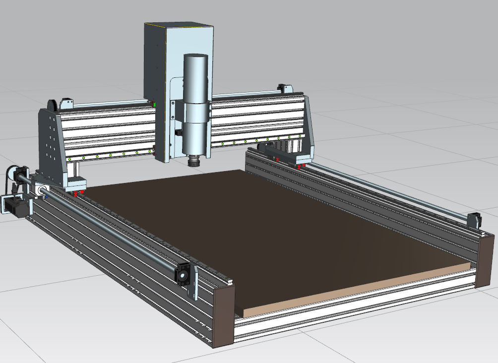

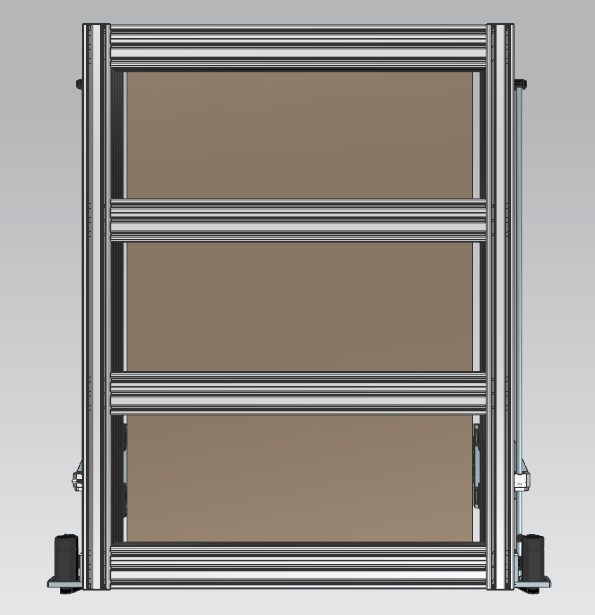

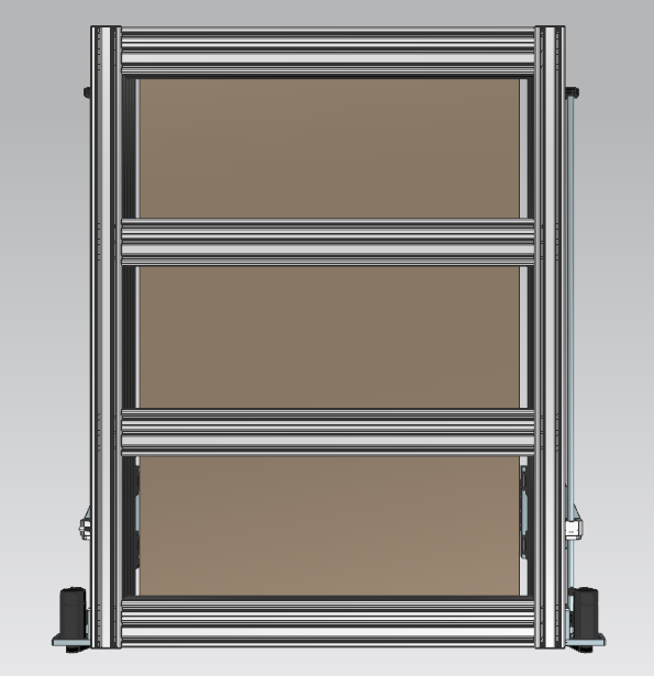

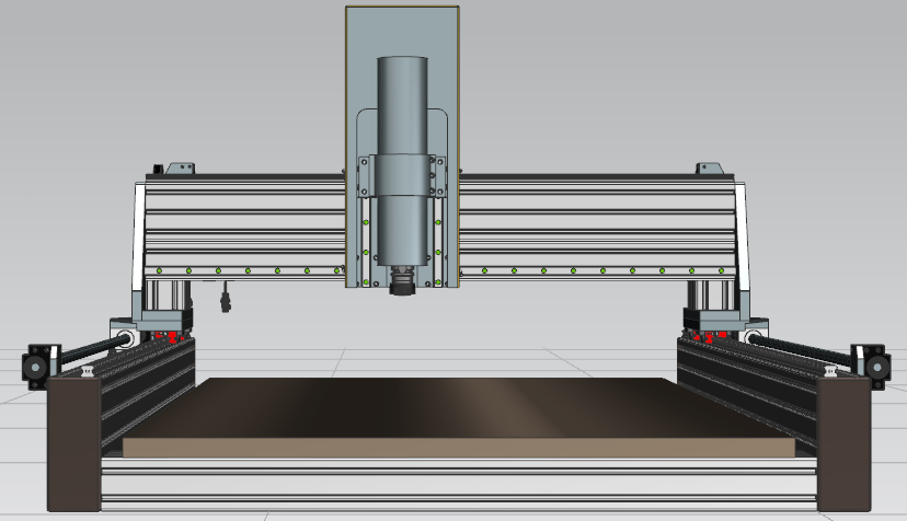

    Final assembly!
ID:	27852 Click image for larger version.
ID:	27853 Click image for larger version.
ID:	27854 Click image for larger version.
ID:	27855 Click image for larger version.
    Some things still bugging me is the 120x80 for the gantry. I hope that those will not be too weak for machining aluminium with the ATC spindle. I am still consider changing to 160x80. JAZZ, if you read this, I remember that you wrote somewhere that for larger machines you use the 160x80 for the L-shape gantry. Since my gantry is 1200mm wide and I am using an ATC spindle, would it be wise to go for 160x80 anyway?

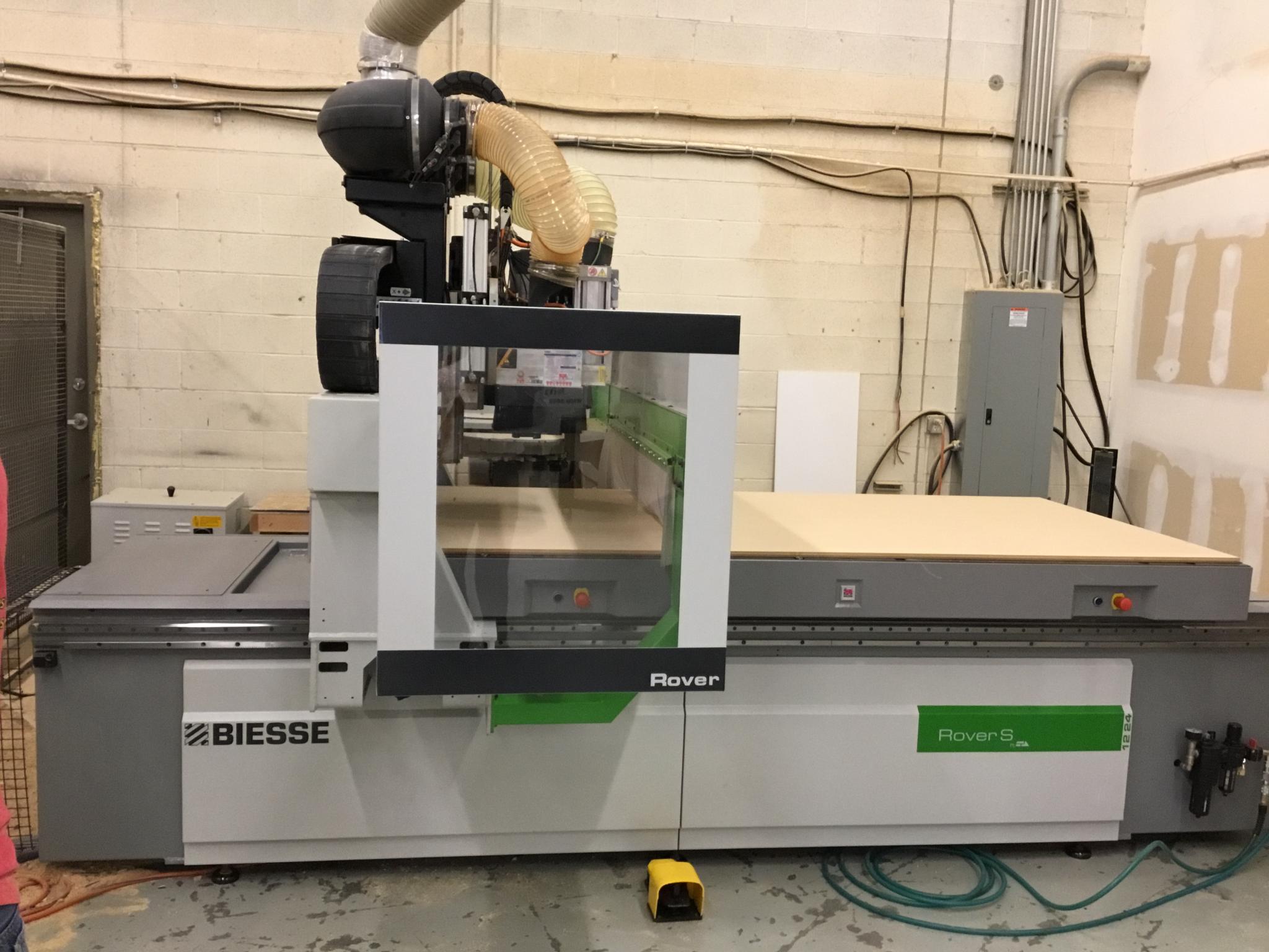

  6. #116
    Ok well I'll answer this question seen as he's mostly following my design.!
    It always makes me smile when I see comments like these because while the physics shows that what you are saying is the ideal location the reality is that it makes no difference to the machine and how it works.
    To prove this point I'm going to give you a challenge.! . . . Industry demands the highest cut quality and performance, so logic dictates that they would follow the physics and optimum location very closely.?
    So go find me a machine from the major manufacturers that place the spindle smack between the bearings.! . . . If you find one then I guarantee you'll have seen ten before it that don't.!! . .. In fact, you'll be lucky if you find any with spindle inside the bearings.!
    You all need to stop worrying about the physics and virtual world so much and get building so you can realize just how little if at all, these affect a real-world machine.!
    Exhibit: A
    Quote Originally Posted by joe.ninety View Post
    Can I just ask what the benefit is of using blocks of profile to sit the gantry profile on, as indicated in the picture?
    It seems because of this you were forced to place the bottom linear rail on the front, thereby pushing the spindle further away from the gantry. I'd always though that the idea is to try and keep the centre of gravity of the spindle as close as possible to the bearing blocks the gantry rides on.
    This is not in anyway meant to be a criticism, but just me trying to understand if this design means there are benefits to it that outweigh the spindle being pushed further outward.
    To answer you directly Joe, then to place the gantry further back to bring spindle into line with bearings would actually weaken the machine not make it stronger. To do what you suggest without getting into complex gantry side designs means using plates for gantry sides that can flex side to side and introduce vibrations at the tool.
    I can tell you from building many different designs of router that the design he's using is the best possibly way to build a router without getting silly about.
    Mike is correct in that having longer distance between the bearings is good but thats a trade off between travel and foot print of the machine. In the grand scheme again it makes very little difference.
    As a rule you ideally want the spindle IN the same envelope as your X axis bearings, i would make the distance between these bearings further apart.
