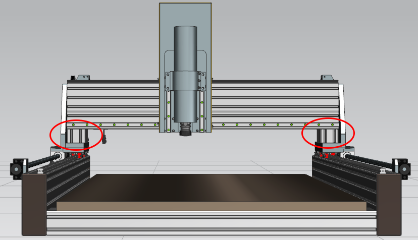

Can I just ask what the benefit is of using blocks of profile to sit the gantry profile on, as indicated in the picture?
It seems because of this you were forced to place the bottom linear rail on the front, thereby pushing the spindle further away from the gantry. I'd always though that the idea is to try and keep the centre of gravity of the spindle as close as possible to the bearing blocks the gantry rides on.
This is not in anyway meant to be a criticism, but just me trying to understand if this design means there are benefits to it that outweigh the spindle being pushed further outward.
