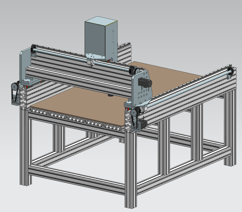

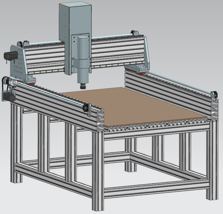

    Short update to show the final design. NO MORE CHANGES! Started ordering parts today, I am excited.

    Not sure if the frame and/or table needs more bracing. Please give me some advice!
  13. #140
    I know I said no more changes but I was wrong. I modified the frame and bed quite a bit. All parts are now ordered and the first parts will be arriving in the beginning of next week. The bed will be adjustable in height to allow for higher work parts if ever needed. This is a safety measure so that I don't regret the design. Table will be adjusted with scissor lifts and should be quite easy to realign. I will also add some triangle bracing to the frame, which are not shown in the pictures. These will be made of steel.
    Oh and by the way, budget of 8000€ was not enough, which I expected anyway. It will be closer to 10000€. I am still happy!
    Also JAZZ was right in the beginning of the build log about the total weight. It will be over 400kg once everything is assembled.
