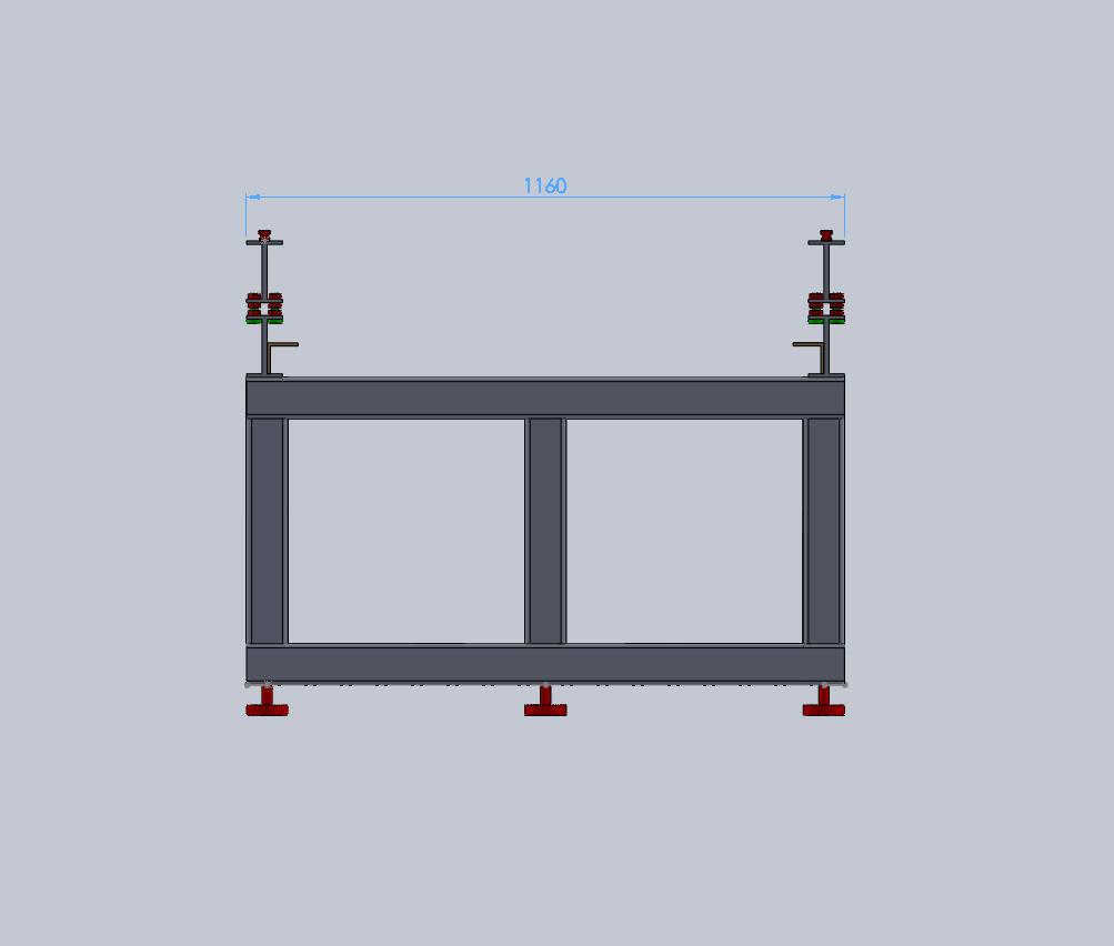

    Hi Everybody
    My name is Vagelis and I am from Greece
    I would like your advice and your opinion on the plans below.
    Involving a cnc (1500mm x 1000mm) which
    will runs with Yaskawa servo 400 watt
    Supported profiled rails 20mm, ballscrews X, Y 20mm Z 16mm
    Spindle 2,2 KW water cooled
    The following plans have to do with the table
    I want to make something stiff and adjustable
    The main table is made with 80X80 5mm square tube and the X axis rails will be placed on two ( each side ) I beams. The one I beam (120mm height) will be welded on the table and the above will be adjustable up-down left-right with screws. Before i go on with the plans i think that it will be good to get some opinions from the "experts" as i am amateur at cnc constructions ( sory for my english).
    My main concern is if I beam is suitable for this purpose, or it is better to go with 120X60 5mm tube
    The cutting surface will also be adjustable from the brown L shape angle that can be moved up and down.
    Thanks everybody for your time

    Vagelis,
    I am an amateur like yourself but have recently read a lot of information about cnc machines. I am designing a frame myself at the moment using 50x50x3 steel box section, my work area will be about 1000x650.
    You see where you have two crosses in the side panels, I think if you had just 2 diagonals like this I/I\I it would be enough because you just need to create a triangle. For your size machine I would say the 80x80x5 might be more than you need but if you are fine with that then more is better than less. The I beams I would change for box section because I beams are not so good with twisting and you might get more sideways twist than you would with box section. Also you have not put any diagonals at the ends like you did with the sides. Good things you have included are 3 legs each side, adjustable feet, adjustable top I beam to get the top surface straight. Looking at the drawing, I can't see much adjustment on the brown angle and wonder if it's worth it other than making sure the table is the same height under the cutter across all of the table.
    In my opinion your legs are overbuild and the rails support underbuild.
    The I beams are bad idea.
    After a lot of thoughts and considerations for me:
    -a whole machine build from 80x80x3mm with a careful design could be the best solution for a DIY sturdy CNC
    -a whole machine build from 100x100x3mm with careful design could be a real beast of a DIY extremely sturdy CNC
    The people who build with more than 3mm thickness either have a design which is not so perfect or are pro builders who know what they are doing and definitely its not their first machine, usually some beast with a special heavy duty purpose
    It would be nice if you take your time and read the entire Tony CNC build here where he started with similar to yours idea, the calculations of the price and weight, how he implemented and personalized the design from another build of mine adjusting to his dimensions and needs.
    More or less i could say that the particular design of mine could hardly be beaten for strength, weight and $$$ combination, permitting the final result to be extremely sturdy CNC with deep 160-200mm Z travel.
    The trade offs are that it is better to be all soldered and adjust the table bed by fitting thick table bed instead of raising and lowering the bed structure itself.
    The plus is that its very easy to cut to size, one profile only, cheap, very easy to solder precisely and completely scalelable from small to big machine.
    the gantry could be made from 2 profiles soldered together so finally will be 200x100 or 160x80, which both a are great and in the ideal range for 20 size supported rails
    Its not tested on a finished machine, but i am currently building one and can assure you is steady like a rock. If you scale it, mind the distances between every element and don't change them, just add or take elements to make it bigger or smaller.
    Its deceivingly simple but many things are taken into consideration.
    Hope that it helps.
    My advice is when comparing designs take the calculator and see the KG and what you receive for these KG in strength. Then compare. Every KG is an euro

    Thanks everybody for your advices
    The basic conclusion is that I should replace the I beam with square profile. That was what I have in mind from the beginning. The reason that I choose I beam for the drivers support, was because it was easier to connect the two I beams ( upper and lower ) with bolt and nuts in order to have a fully adjustable table.
    The plan that you suggest me to make Syliavski looks very strong and stiff. My question is how am I going to adjust that table if I have imperfections as cause of arc welding. The basic advantage of arc welding is the stiffness, on the other hand if I only weld and have no ability to adjust with bolts, I think is more than sure that my X axis rails wont be on the same plane. So I think that I will keep the solution of the bolt adjustment an replace the I beams with 80X80X3 or 4mmsquare beam. The Chinese says 1 picture 1000 words, I will design it and I will come back. Meanwhile I will be glad to hear any suggestion.
    Thank for your time

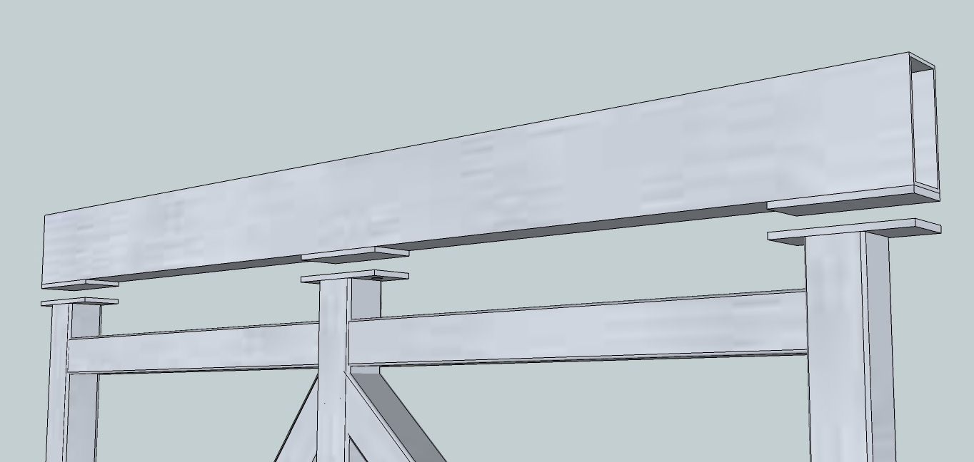

    This is how I plan to do my top rail.
    legs 50x50x3 steel box
    top rail 100x50x3 steel box
    6mm or maybe 10mm plates welded on top of the legs and welded to the underside of the top rail.
    Bolts will pass through the plates on the legs and will screw into threaded holes in the top rail plates and right through into the box.
    These joints will be shimmed to level the top surface of the rail and to ensure both sides are in the same plane.
    Before bolting the pieces together I will grind the surfaces of the plates flat, checking with a straight edge
    It would be easy to weld 2 further intermediate points if this found to be flexing.

    That's pretty much I do my rails but to make life simpler and do away with grinding and shimming etc I spread a layer of Epoxy putty on the bottom plate. Then I put layer of plastic between rails and plate then lightly tighten together pushing some excess out then set the rails on same plane and parallel etc. The putty gives plenty of time for adjustment and dries hard has metal.
    It has dampening quality's has well so helps with vibes transferring thru frame. It drills and taps easy and fills any voids, I can shape to match radius etc and it easy grinds and sands if needed.
    When set 24hr later I have a perfect hard surface that sets rails exactly on same plane. The rails can be removed and go back exactly on same level so no messing around with shims etc.
